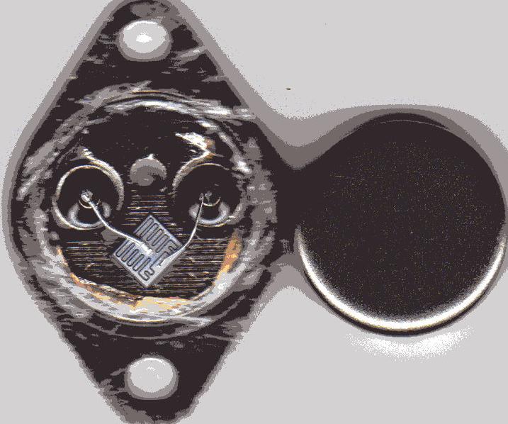

It looks genuine, although I became uncertain after reading your acetone-test.
Probably it's a re-labeled genuine ON device.

But still how come they relabel their semiconductors? Is that in the manufacturing process?? Seems to me too the die looks like a genuine one.
I've also cracked my TIP2955/3055 to see a tiny miny die inside i'll post these ones too and drop the TIP35C/36C.Its actually after cracking those open that i decided to go for MJ15003/15004 given that the seller was telling me they were original parts

Andy L. Francis said:It looks genuine, although I became uncertain after reading your acetone-test.
Could be. To me the die looks like a 2N5630 (or 6030). I've cracked open old ones in the aluminum case before fakes were prevelant and that's what I saw. Those are only rated 5A @ 30V DC SOA, but usually will take more. It could pass for a 15004.
I've also gotten burned by fake MJ15024's a few years back. Paralleled devices wouldn't share currents and solderability sucked. They were all labeled the same - with 9638 date code. I cracked them all open and some were the usual 2N3055 size die coated with silicone, and others looked just like the one above. Those might have passed an SOA test, and capacitances would have at least been close.

No, I didn't test those particualr phonies. Once they were opened up, what would have been the point? But I was surprised to see that *some* of the die were an expensive type (but not the right one). Maybe they were rejects the got cheap.
I originally built a couple of amps with two paralleled pairs of 5630 on +/-60 volt rails. Takes 4 ohms all day, but the supply drops to around 50V. I had friends build the same amp in college and no problems. I have since done some stress testing and no failures for a couple seconds at 50V at 4 amps. Only had one failure during that set of tests and it was at 70 volts. It was just hard-wiring the DUT as a current source and applying VCC, making it difficult to reconfigure. And of course it's destructive when it fails.

For your application at only +/-30 or 40V, that die is plenty big enough, even if it turns out to be rebranded. The only REAL fakes I've seen in TO-3's are very easy to pop the lid on. If you have to cut the lid off more than likely it is a real Moto/ON device.
As rare as some of these types like the 15003, 5630 and 6609 are these days, I'm surprised they're not rebranding the more common MJ15024/5 and selling them at a 'premium'.

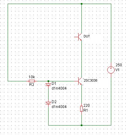

Thanks for your help guys. But one thing is the attached circuit the proper way of doing it? In case its not can you please correct it.
About your HT supply Andy do you have any means of controlling the voltage? Is that needed am a bit lost.

zeus_threat said:Thanks for your help guys. But one thing is the attached circuit the proper way of doing it? In case its not can you please correct it.
That is correct. Confused me for a minute putting the DUT in the emitter ckt, but as long as they're in series it's right. Just be careful you don't go testing the VCEO of your fingers.
You don't need to control the voltage on the HT supply. The current source will drop to the VCEO automatically. Read it on your DMM in parallel with the DUT. Just don't go using the DUT right up to the voltage you measure - as at that point it's leaking but the amount of the CCS, and if you apply one miserable volt more with no limiting you'll let the smoke out.

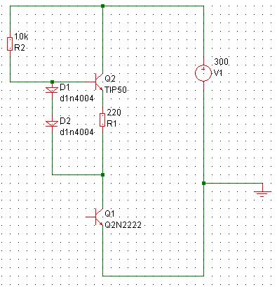

Is this better?
Thanks is the attached circuit better? Am confused where should i connect R2 in the figure to +ve or -ve supply line?
For my HT supply this is how i will set it up:
Transformer1 12V5A secondary into a second transformer secondary 12V and 0V(12-0-12V 2A) to obtain about 220V in second transformer primary, rectify with 4X1n4007smoothed with 100uF400V like Andy. Will that be enough?
Would the 2SC3038 need a huge heatsink+fan??
P:S of course in an amp i can't use the transistor up to the measured VCE but still i'll have an idea of what i can take
