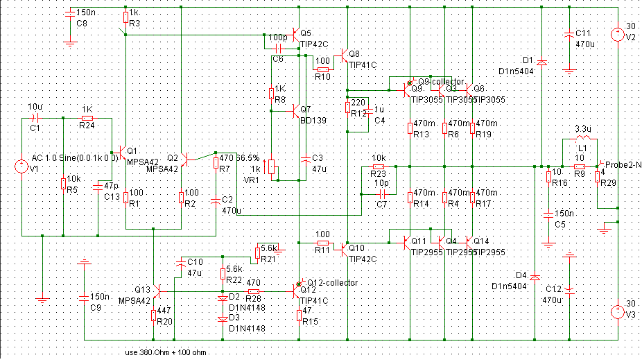

100W peak 4Ohm

Sorry was busy very busy with work. Its hard to get a living out of one field and diy into another anyway. Well yes wg 😀 its a loooooooooooooot of work but mayber am over precaucious here. Fianlly got my hands on a toroid. Nothing mentionned about VA but diameters are 12 cm external and 7cm dia for the empty part of the inner ring height is 5.2cm. Do these dimensions correspond to a 500VA toroid? And weights very heavy

Theoretically about 100W, but in practice count on about 70-80W on 4 ohms resistive load, and you certainly need two pairs for 4 ohms load operation. With the same given load, DC supply voltage (and PSU current capabilities) is the factor that will determine output power, not number of output transistors (once you have minimal necessary number!).
