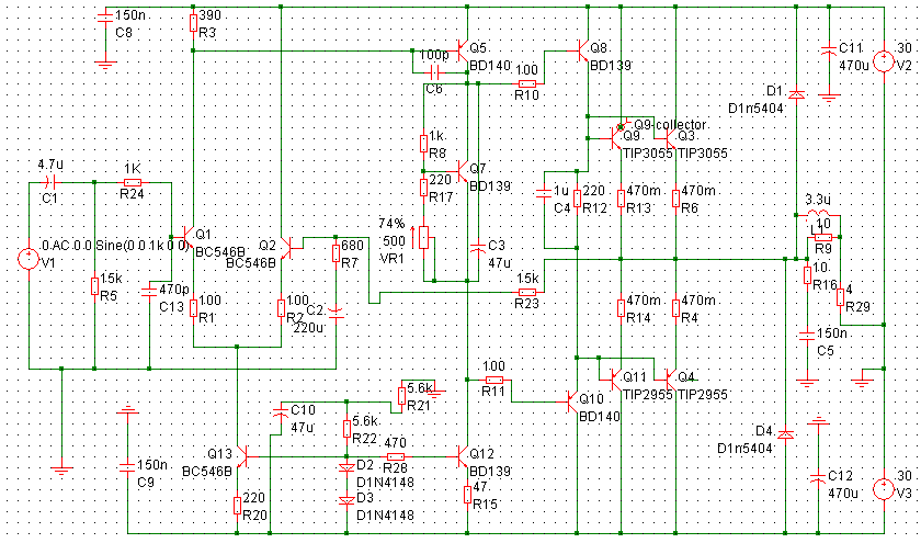

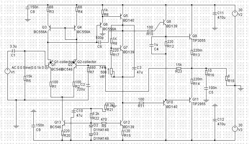

Can someone tell me what Wattage do I get with one pair of 3055/2955 and what wattage with two pairs of this transistors if the power supply is +-30V ? Thank you.
Theoretically about 100W, but in practice count on about 70-80W on 4 ohms resistive load, and you certainly need two pairs for 4 ohms load operation. With the same given load, DC supply voltage (and PSU current capabilities) is the factor that will determine output power, not number of output transistors (once you have minimal necessary number!).
