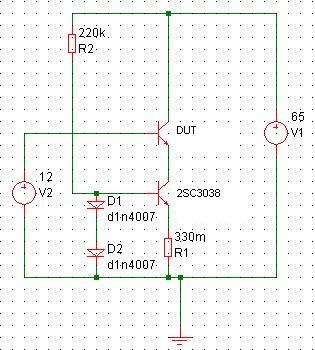

That's how I had mine set up. Anonther thing... the 10k is way lower than it should be. 220k is more like it - you don't need to waste a lot in the base bias. The transistor will only dissipate a couple of watts into a short, you sure don't need the bias resistor burning up any more than that.

How about adding a 1M0 in series with the DUT to allow measurement of the real leakage.
A Variac on the input would allow you to check how leakage varies with DUT voltage.
Try tying DUT base to DUT emitter with a 10k resistor.

At 300V rails R2 would dissipate ~400mW (300V^2/220000). Use a 2W rated resistor there! Go for 1/4W as R1.
Say the measured device's Vceo0 is 200V, and the HV PSU's rail voltage is 300V. At 10mA Ic the dissipation of 2SC3038 will be (300V-200V)×0.010A=1W.
Actually your Ic is about ~3.2mA, then heatsink is not required. Increasing safety margin of the circuit I'd apply a small heatsink on it.
And finally, be very-very careful when using the finished and working circuit, 300Vdc is LETHAL!

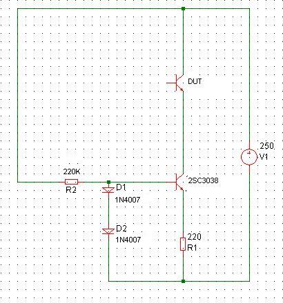

Just a quick question. Suppose i want to test a transistor like a TIP2955 which has a VCE of 60V if genuine and suppose 30V fake. Could it be done with that circuit?

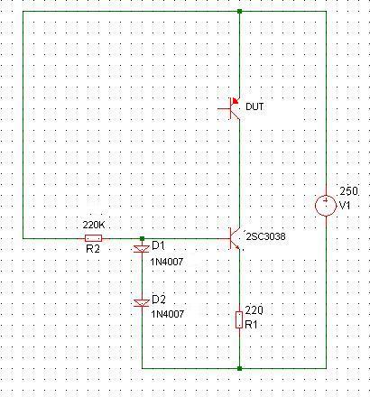

In case say suppose i have to test a PNP for VCE is the figure below correct.

A real TIP2955 will probably test out over 100V. A fake might even go that high. Especially if the fake is actually a real TIP30. You really need to check capacitance or SOA. Just how prevalent *are* fakes on these cheap commodity transistors? I used to think they only did that with premium high dollar devices - until I banged my head for a couple months wondering why my amp oscillated and small signal devices were WAY out of spec.
For PNPs you just switch the leads for BV test. Unfortunately, there's no easy 2-lead swap to test SOA.

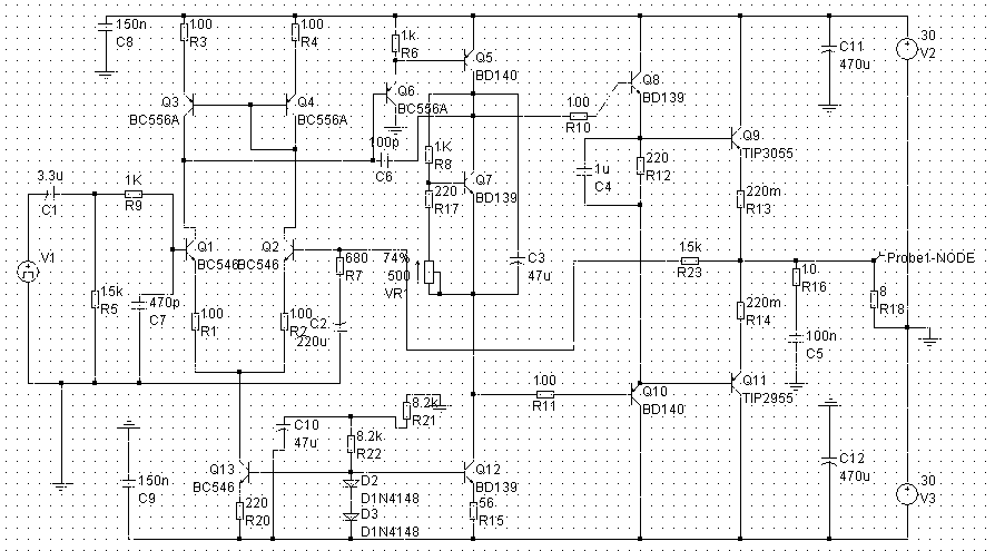

zeus_threat said:Back after some time. Attached figure is version i will be going for. Note bc546/556 repalced with 2n5401/2n5551. TIPs replaced with mj15003/04. Any comments welcome.
Whew! A lot of work to select transistors for a 60 volt application!
Don't forget the base stopper on Q12 unless you want to put DC to the speaker when it clips.
- 100W peak 4Ohm
