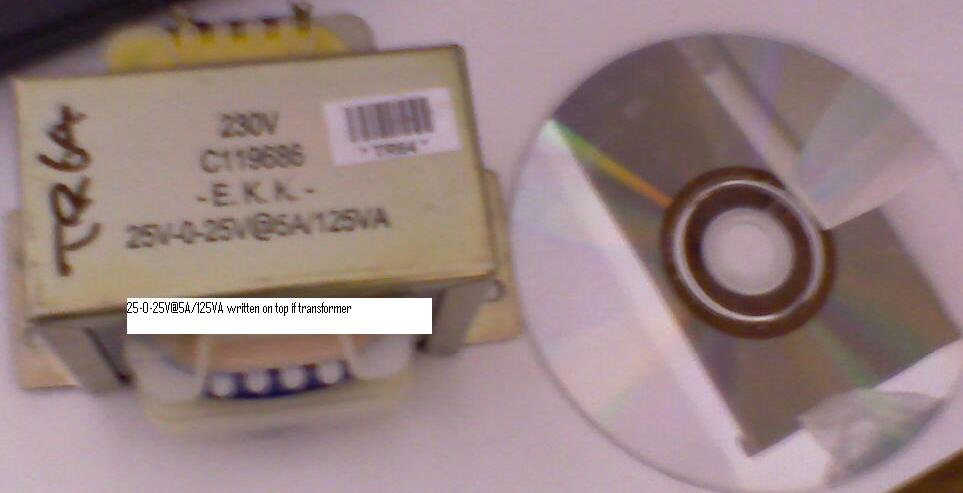

Sorry Andy, don't know why forenamed you andrew got a colleague at work called andy too maybe it was my mind trying to differentiate the two. Well the transformes has this written on them 25-0-25 5A but 125VA might sound weaker now. How is that VA derived finally am getting lost with it isn't it from the 25V and 5A or something like that?
the transformer is a centre tapped 50Vac @ 5A, that makes it 250VA.
The windings could be called up as 0-25-50Vac and if they were separated then you would have 0-25, 0-25 each capable of 5A.
Thanks andrew that sounds more correct to me too, but i don't understand why they printed 25-0-25V@5A/125VA on the transformer when its a 250VA?
Isn't that marking is 125V instead of 125VA?
Probably it's crazy idea because in Mauritius the mains voltage is 230Vac.
What is the size and the weight of the transformer? Could you attach a photo of it?
Thanks for the foto!
Bad news: from the size this is a 125VA rated transformer 🙁
Sufficient for one channel only.
I agree that looks a bit small for 250VA EI.
I cannot see how they arrive at 5A. A dual secondary could parallel the windings to give 5A total but a centre tapped cannot achieve that.
However, if it is a half winding rating of 125VA per winding then it is a small looking 250VA transformer. Can you weigh it and measure the core width and thickness? That area determines the VA rating fairly accurately.

So it means at most i can get 2.5A per rail which is 50Vac X 2.5A which comes to 125VA. So that 5A is total current per set of windings or am i wrong? Anyway i'll have to stick to two of these for the time being in case i can much later i'll upgrade to 4 transformers with one per amp.
The core looking from top is 5.5cm by 7.5cm.
Height is 4.5cm.
Weight is approximately 2400g or 5.5 lbs

Zeus, I'm sure that it's a 125VA rated transformer.
There is a ~200VA "EI" transformer laying around here, and measures ~3kg.
http://www.tauscher.com/html/ei_07_e.html
125VA rated EI-transformer measures ~2kg, a 250VA rated measures ~3.5kg.
2.5kg is heavy, it might still be 250VA.
