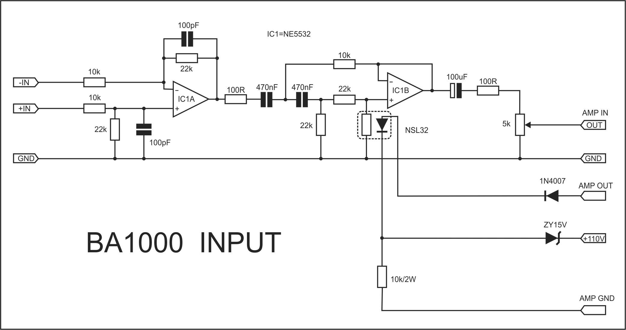

The only question I have is the inputs on this look like there unbalanced and pro audio uses balanced audio. I have a schematic of a crown amp I have at home has the input stage with circuit that converts the balanced signal to unbalanced before feeding to the input to the amplifier

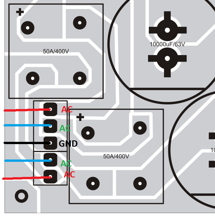

hello guys
I want to copy the Apex BA1200 power supply with Sprint Layout 6 software I have one question is this is the right way to connect the secondaries from the power transformer ? AC red is one winding and AC blue is the other winding from the secondaries of the power transformer

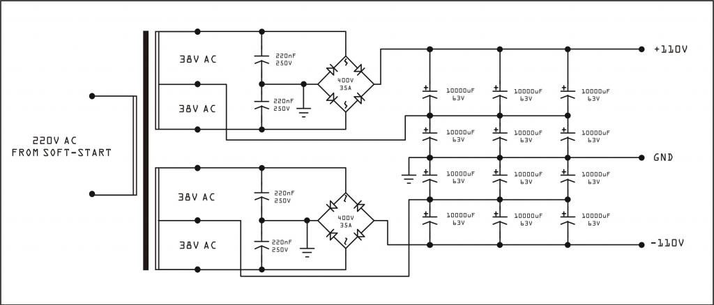

hello guys
Have you checked the maximum voltage applied to your capacitors in your proposal?
65Vac might give a lot more than 100Vdc in worst case operation.
