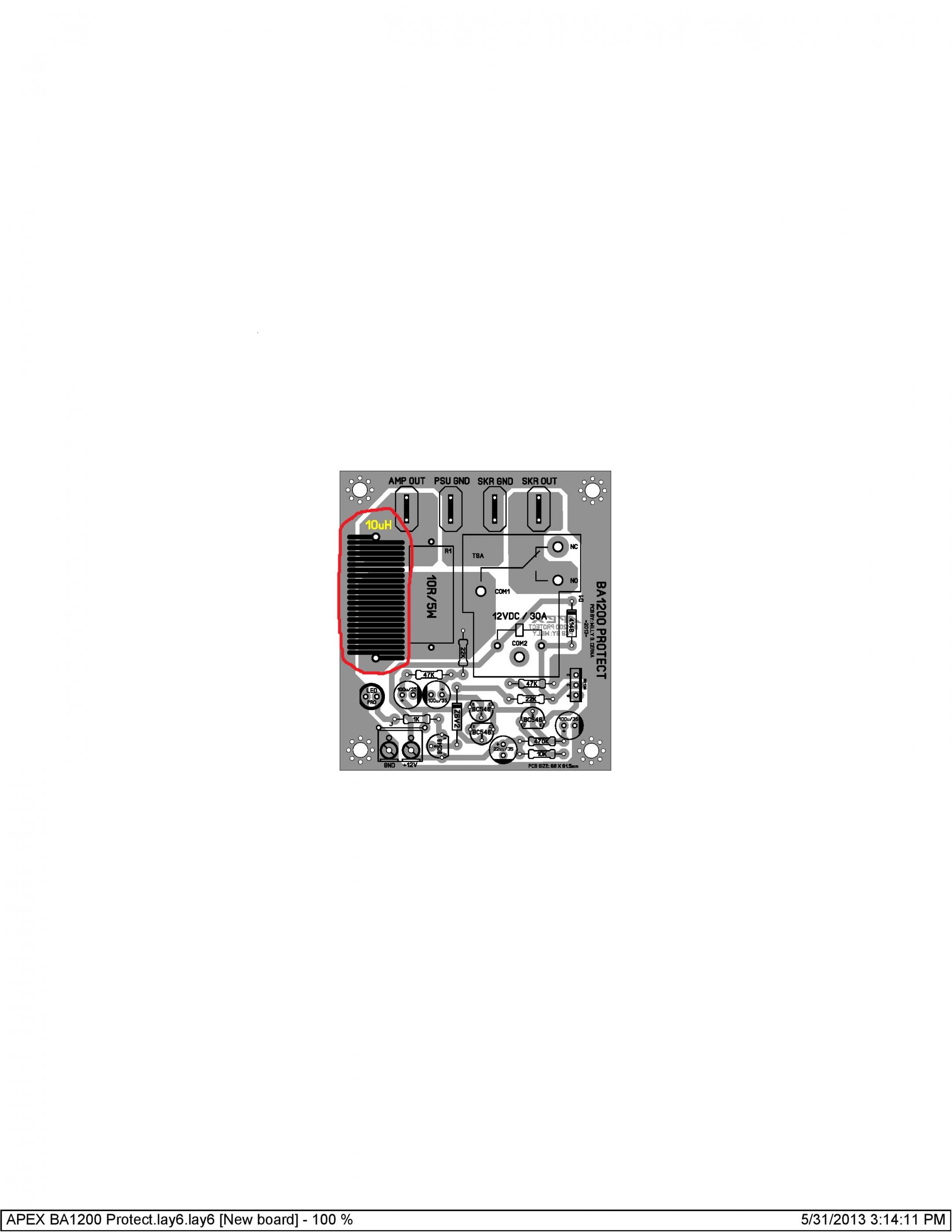

Can we use other speaker protection board for Apex BA1200?
here are some:
http://www.aliexpress.com/item/Spea...c-delay-encoding-free-shipping/833178937.html
http://www.ebay.com/itm/Assembled-S...o-amplifier-amp-soldered-tested-/130747605505
here are some:

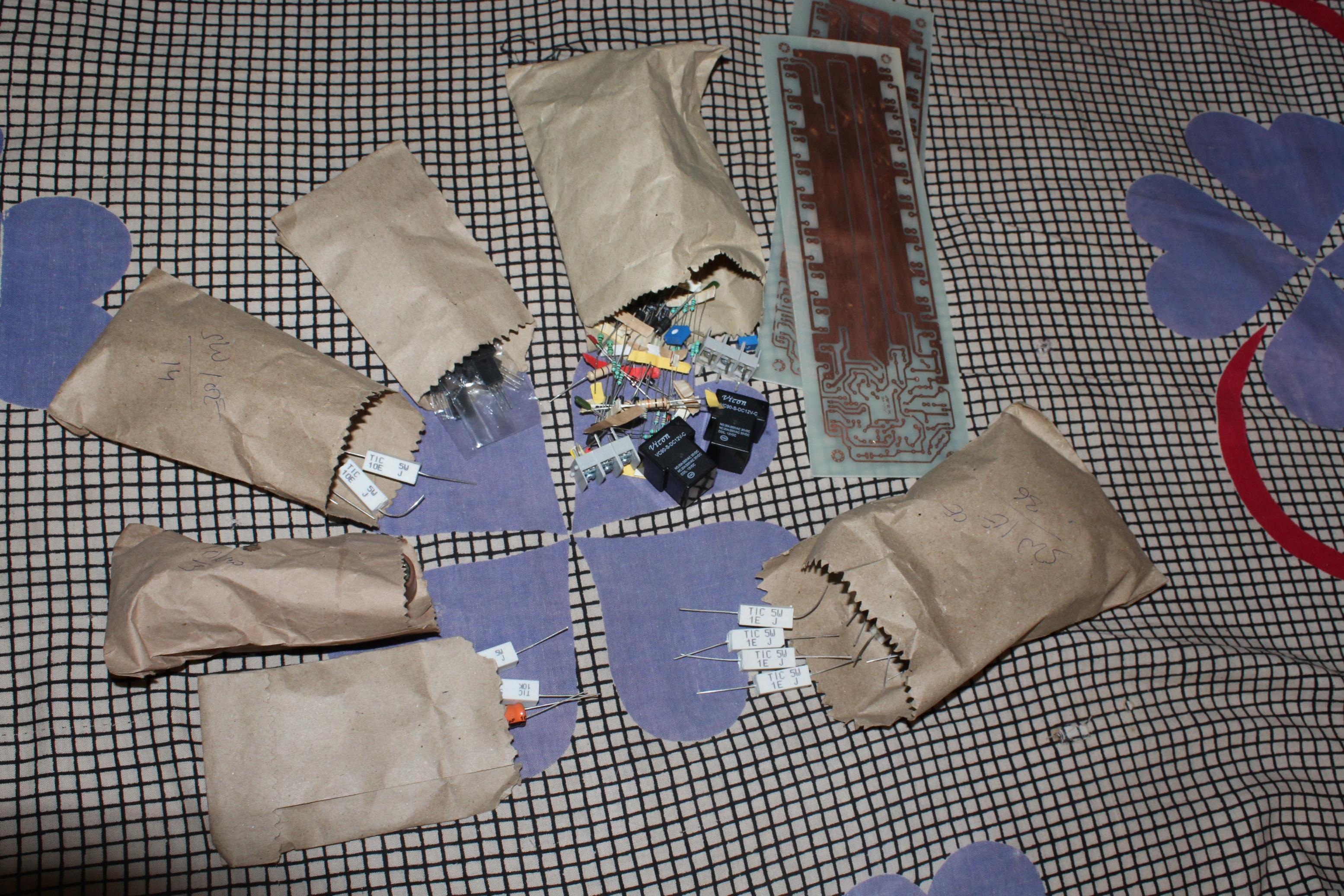

Sorry everyone:
I already bought all small part resistor, small transistor, transformer and etched 2 x ba1200 pcb now i made some loss here its better if i aborted
The reason for aborting apex BA1200 is because of the transistor MJL4281AG/MJL4302AG is a bit pricey 260$ (digkey) it ships from USA. It is not worth the wattage gain for the $$ you can can get Orginal Japan Toshiba 2S5200/A1943 cheaply.

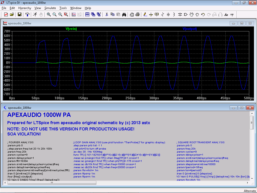

Because the amplifier is not stable.can anybody tell me why this resistor very hot in zero volume level?
This resistor is a part of zobel circuit,high temperature at this resistor occurs as a result of oscillation.
