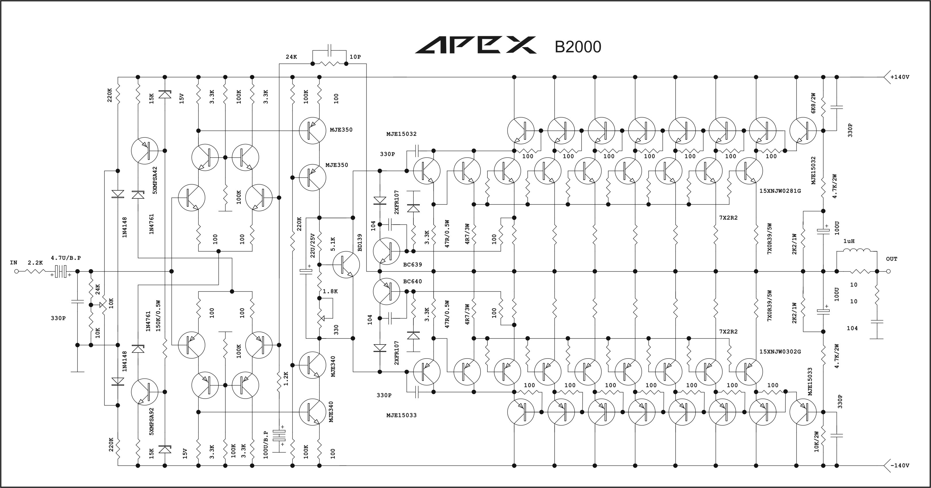

Can we use different parts like 15023 at output. 0281-0302 are hard to find Sir.
TIP35C/36C can be use for step and MJW21195/21196 for outputs.
BA2000....Looks like Proline T-Amp.
Many brands use this simple realable circuit for high power PA amplifiers.

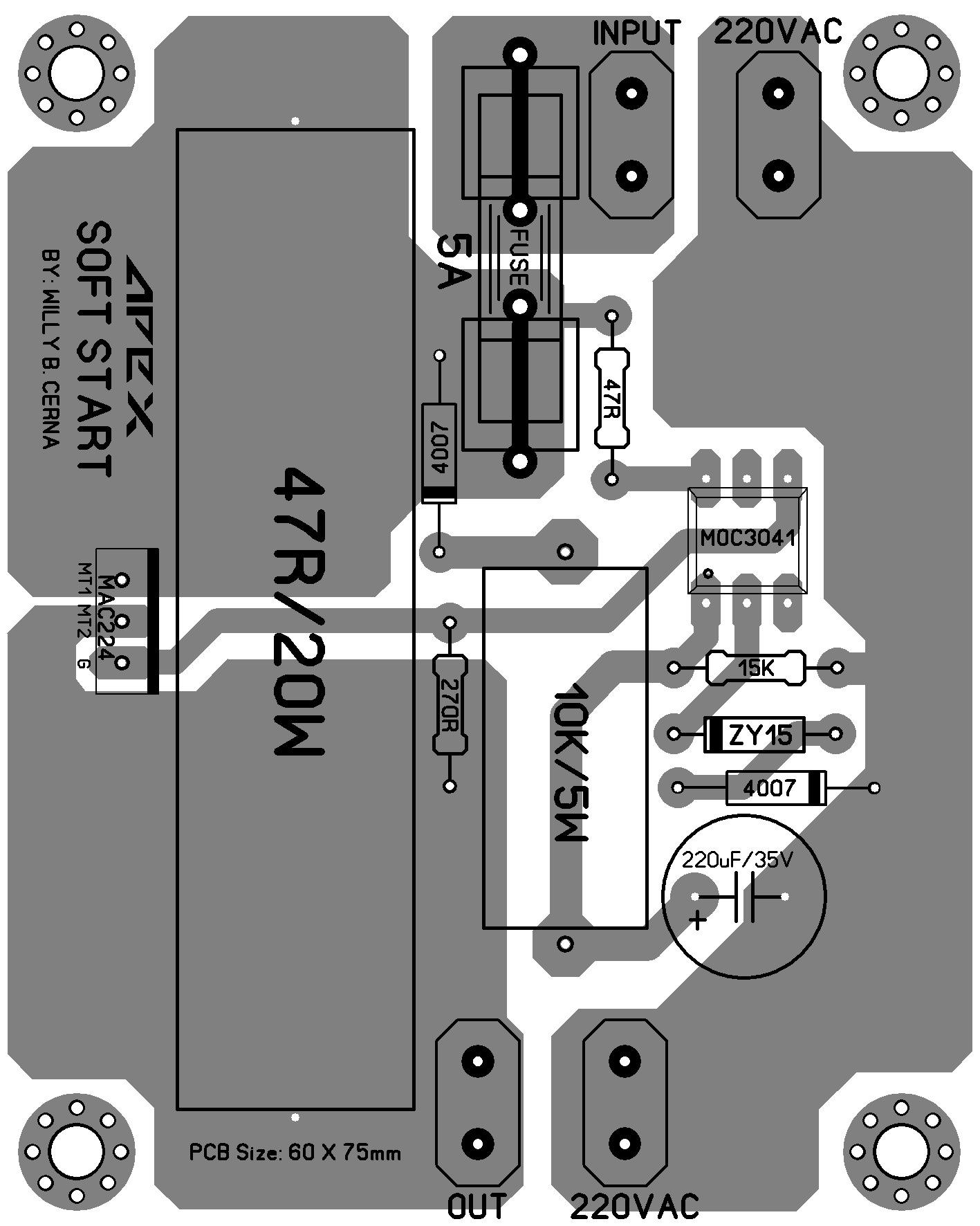

hi apex audio i want soft start circuit pcb layout file which i didn't find. you are doing a great job.love you.
I share many soft-start circuits.
Why did you avoid the rail switching?
Sajti
I have some 2x90vac transformers and B2000 was made only for use them, but with series connect of outputs TIP35C/36C can be use with +/-90V rail or MJ15003/15004 with +/-120V...
I guess, that transformers are huge... This amp need about 3kVA...

Transformers are for 4U case.
That will be nice project.
I think the class TD would be better for that high voltage.

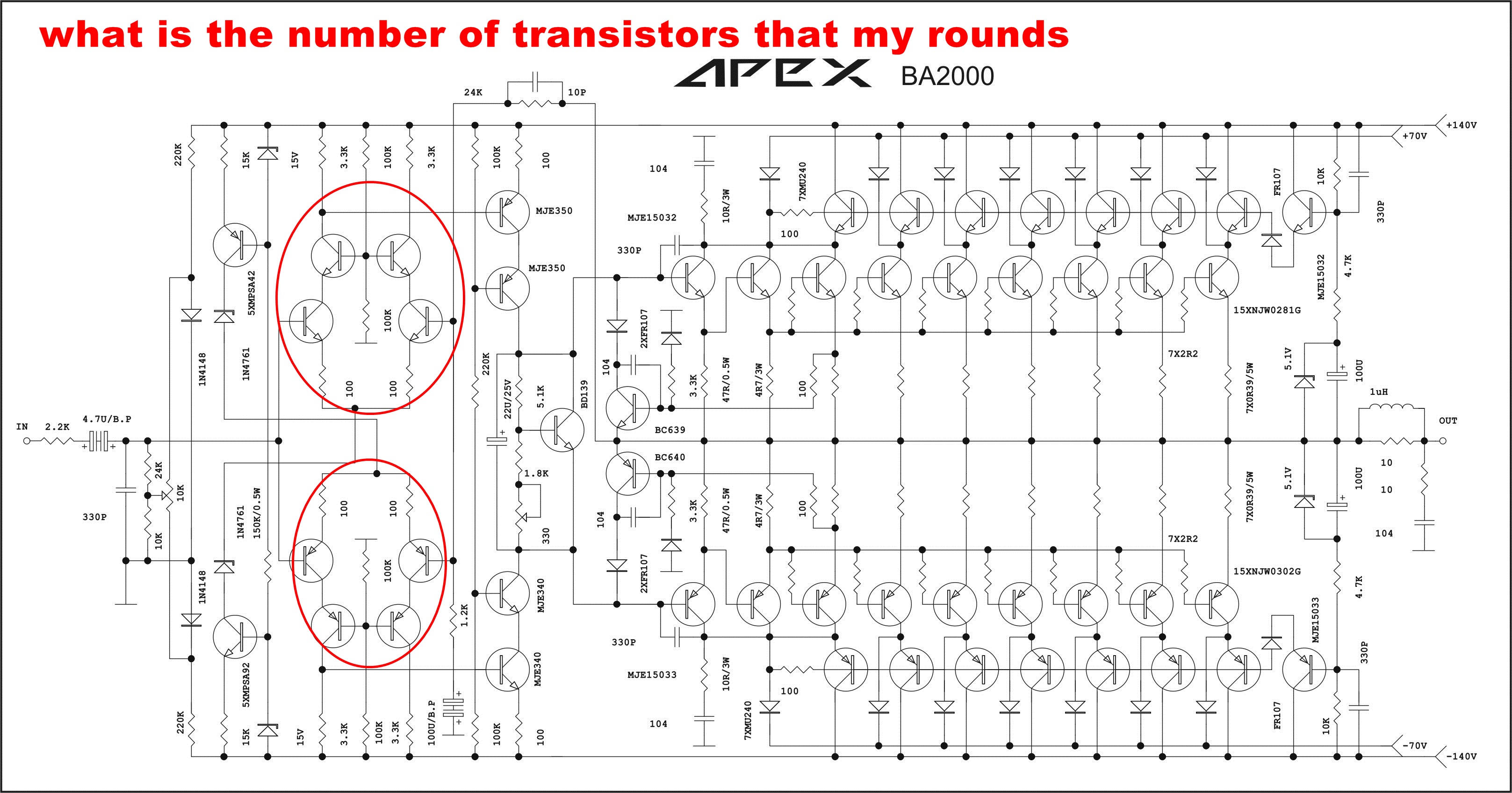

hi apex audio i request to you please give me pcb layout of soft start ( t relay based) and please tell what is pro and hv terminal in speaker protect circuit.
It is written 5xMPSA42/92 next to your red circle.
