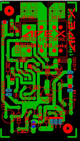

thanks for the reply,
which amp u used for this protect .?
can u share the layout of ur protect?
wattaniya,
I use a protector for BX500TEF.
I'm just an amateur designer, only used for hobby only. but it all worked out very well.
regards respect for mr. mile for all his contributions, I really appreciate it.
thks.

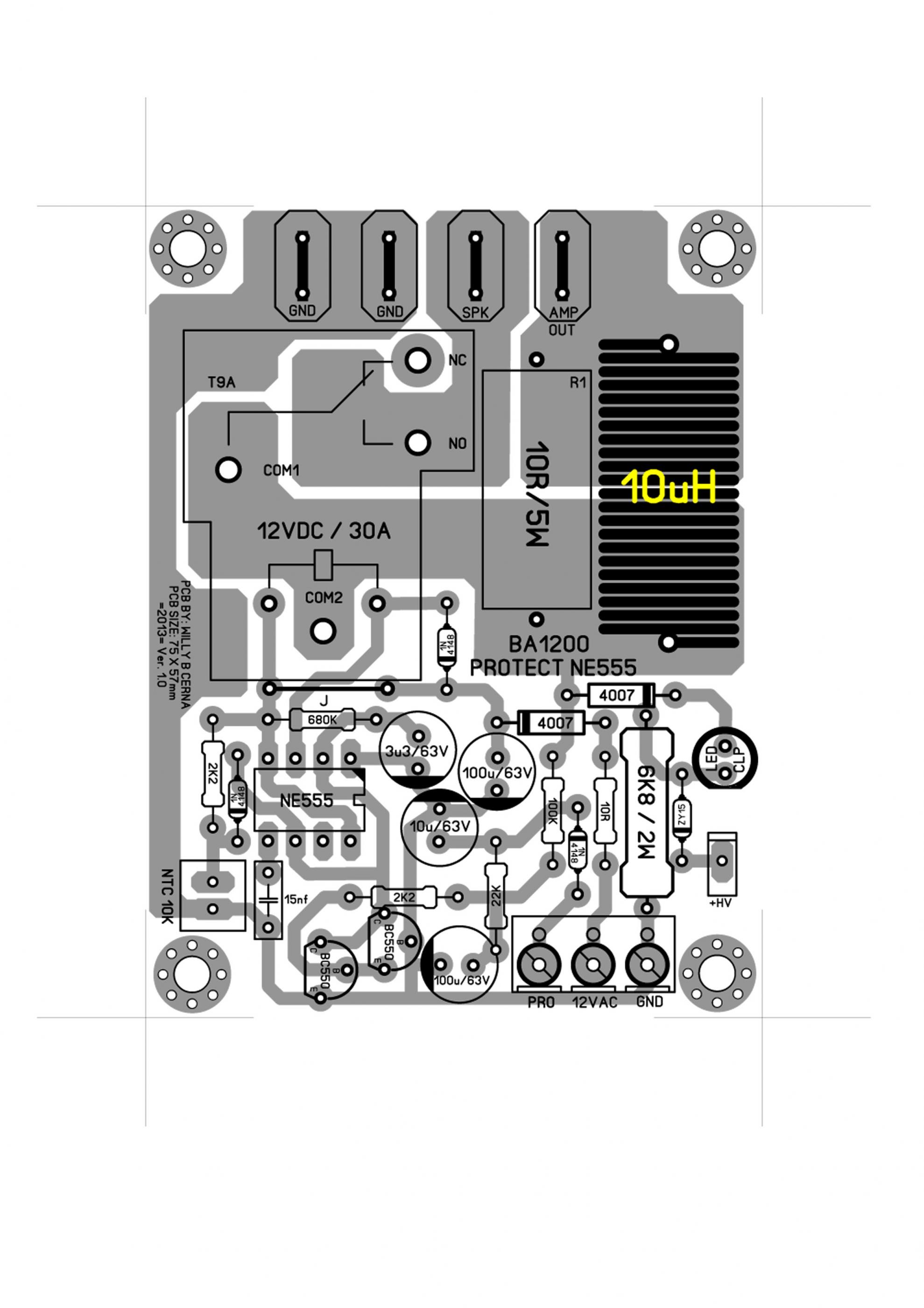

thanks for share &
what u use component in pcb protect :
1. RELAY type : ?? A =
vdc =
2. Transistor serial..????
3. Sensor fan...???
4. Sensor Protect ..
Sir can you share the blue component guide in high resolution, sorry but its unreadable.
Thanks and regards,
i can't post with high quality. limited size picture. maybe this picture can help you. regards

1. relay 12VDC, rating ampere lupa bos. 😀
2. u can use anything small transistor for Q1,but remember of NPN. for Q2=tip32 / anything PNP.
3. sensor fan, no use. automaticaly detect from out amp.
4. NTC 10K to heatsink, heat protect. but this protect work fine without it. 🙂

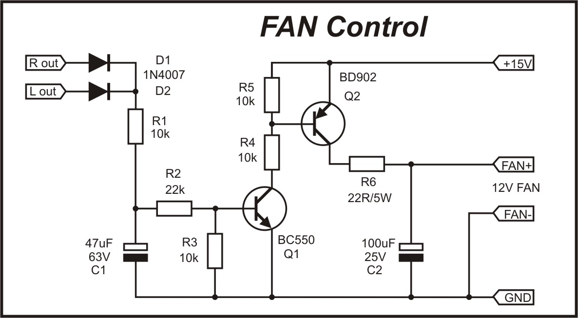

schematic of sensor fan attached.
thx. regards
