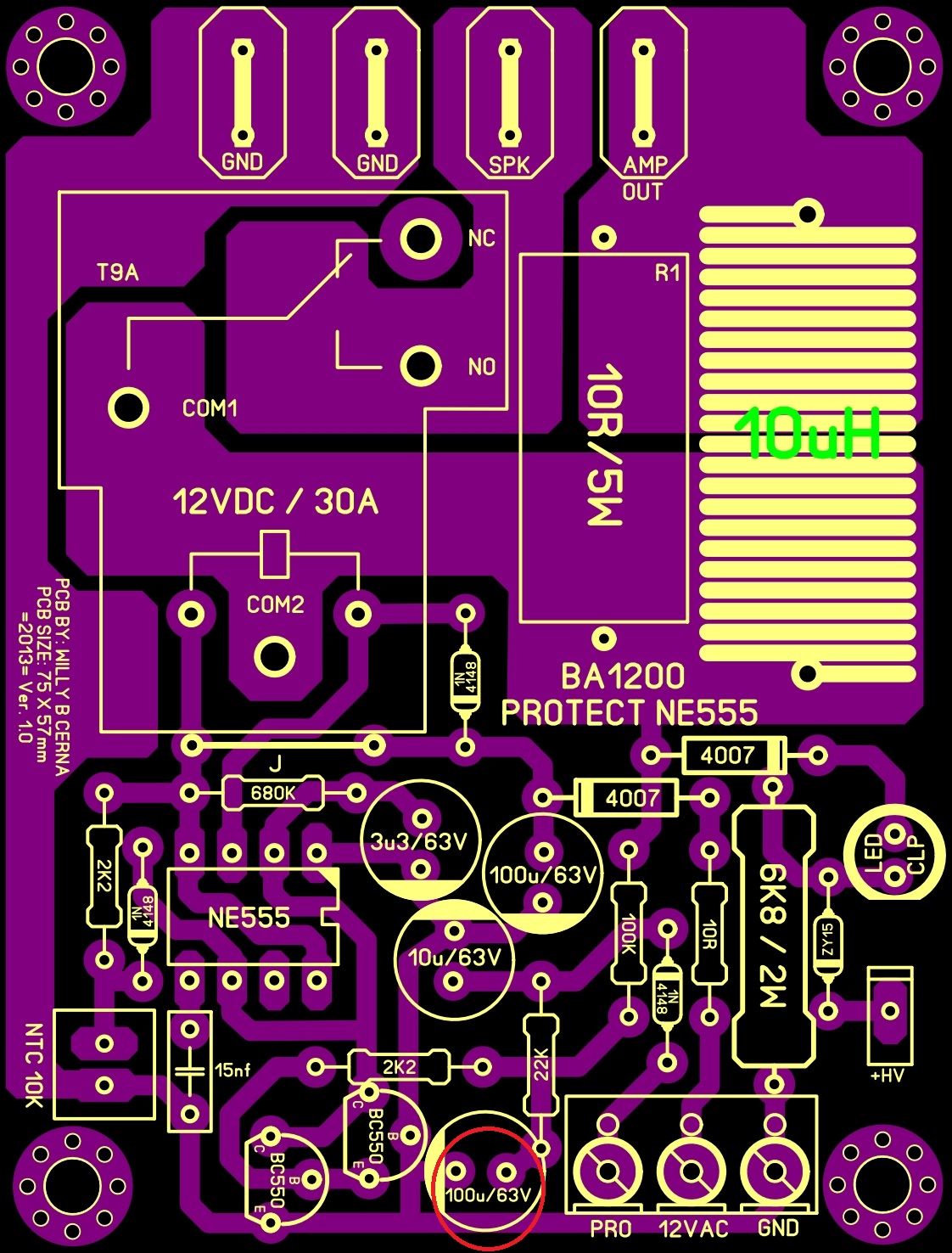

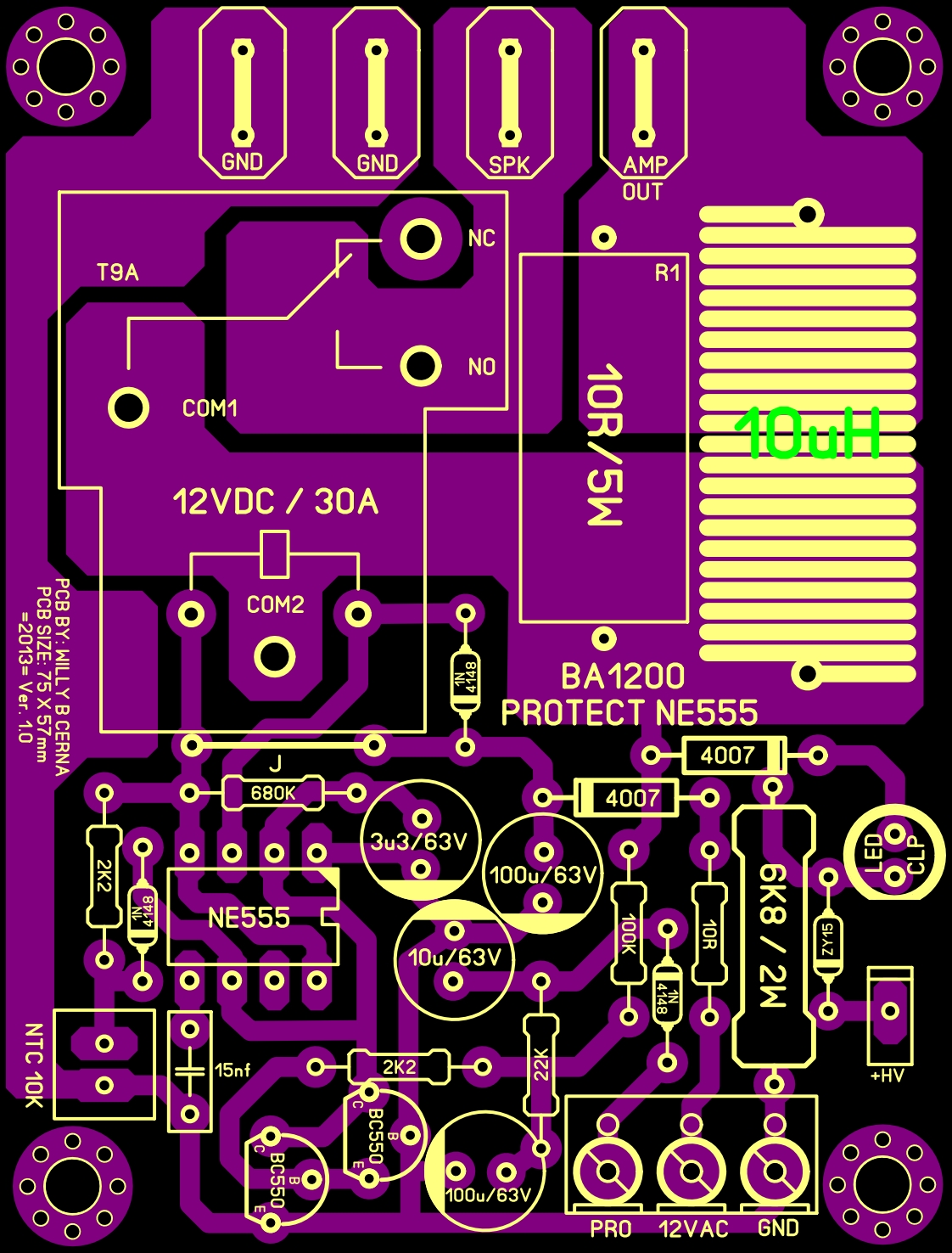

what is the heatsink temperature in full power ?, 50degree celcious or 60.(average)
what is the temperature? in the protection board the 10k ntc will off the relay?
