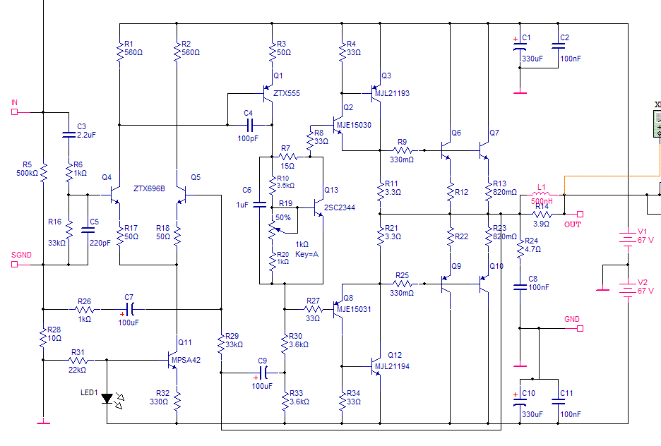

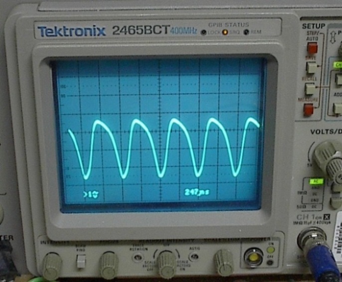

megajocke said:I wouldn't call that ringing, ringing is to me something that happens around "sharp" edges.
I was under the impression that full blown oscillation is different to what I have here. This looks like a stable amp driving a fairly big capacitive load. I have had oscillation before, on another amp at 1MHz (see pic below). It was a stand alone, wave form that didn't show in the amplified wave.
The output get hot and fail with this oscillation. My outputs with that (for want of a better term) ringing stay normally cool.

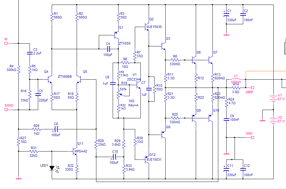

I have flip-flopped again. I'm now back to bootstrap for the VAS and I have changed the schematic to suit.
Another thing I've changed is my selection for the VAS. The 2SA914 is a 50mA device, and I don't know if it will hold up well. The new configuration has the VAS running at ~10ma.
I went hunting for a suitable, high current, low Cob unit and the pickings are slim. The best candidate that I could find is the ZTX555 .
The only hiccup is it's an e-line package, so heatsinking would be a small problem.
I have decided to move the CFP drivers to the circuit board, along with base stoppers for the output stage. This will make the board a bit bigger, but may help with stability.

what about swapping the P & N outputs and making a darlington out of the drivers?
I prefer to see lower resistance values around the Vbe multiplier. 3k6>>1k8 and 1k0>>500r.
R7 must be scaled with the VAS current.
15r better suits 6 to 7mA.
10r to 12r for 10mA of VAS current.

My suggestions to solve ringing problem:
1. Serial RC 470ohm and 470pF between collectors of Q4,Q5 helps to lower TIM and ringing on similar basis
2. Serial RC 100ohm and 470pF from collector Q1 to GND
3. 10-33pF parallel with R29
4. Remove R11 and R21, instead put only one 33ohm resistor between collectors of Q3 and Q12
5. Serial RC 2,2ohm and 1nF in parallel with R4, R34
Try with those, if still no progres I'll be in touch ... 😉

AndrewT said:Hi,
Hi Andrew,
The Vbe multiplier is the same here as in the Patchwork, and it work beautifully, so I don't want to fix it if it isn't broken.
How about this for a darlington output stage:

I meant changing the last output stage and tacking it on to the driver stage as a darlington.
This allows you to retain the CFP from pre-driver to driver, but still keep three stages of current gain.

There are no HF-components in a sine wave that can excite ringing so either something is clipping or it's oscillation. This kind of oscillation is not likely to destroy the output stage though as there won't be much cross-conduction when it occurs at high currents and not around zero. Let's hope base stoppers and the layout change will help.
I'd still add clamping diodes to the output. As it is now B-E junctions may be avalanched when clipping into an inductive load.

Thats a very low value resistor in your zobel network.
I can see that getting hot at high frequencies.
Most of the other designs I see use a 120R with 100nf.
megajocke said:120 ohms? I've never seen it above 10 ohms.
So work it out........
Whats 100 volts at 20KHz into 10R in series with a 100nf ?
Sounds like you need about a 20 watt resistor !

I'm working on changes...I'll post the schematic later. Long and the short: the CFP is out and darlington is in.
megajocke said:There are no HF-components in a sine wave that can excite ringing so either something is clipping or it's oscillation. This kind of oscillation is not likely to destroy the output stage though as there won't be much cross-conduction when it occurs at high currents and not around zero. Let's hope base stoppers and the layout change will help.
Hi megajocke,
Thanks for the explanation. I have been mistakenly calling that ringing. I will add base stoppers to all of the outputs - this may put an end to it according to Leach: "R41 through R44 are in series with the bases of the output transistors to suppress parasitic oscillations that could occur in the output stage. These are bursts of oscillations on peaks of the audio signal.".
Please explain what you mean by clamping diodes. Have patience, I'm new. 🙂

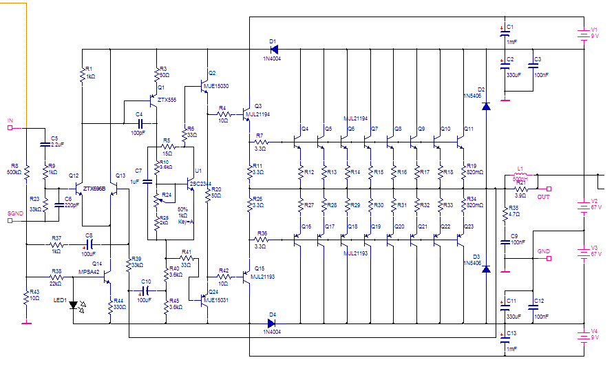

With that in mind, I went back to the drawing board and came up with a new plan. With base stoppers in place, plus the large ballast R's on the outputs, there is a substantial voltage drop. Taking another page from Rod Elliot's book, I added extra voltage to the front end.
The schematic is not final, it was roughly thrown together and is missing a few things. Anyone see a potential problem?
Also a concern is that with the added voltage, the ZTX555 for the VAS is not high enough voltage. I really need some suggestions about what to use for the VAS here. I've searched, but I'm not finding much. What is the max for Cob I should be looking at? I notice that Leach suggests the 2N5415 for the VAS in his amp. The Cob of this device is 25pF.
