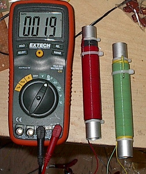

Ok, they are done. I even had time to take a shower while the varnish dries. 😉
I was a little low in my measurements, no time to look for a tape measure, I used fathoms - I guess my arms aren't as long as they used to be 😀.
Anyway, they measure about 1.7 ohms in series.
I tried it on the amp running the +/-35V, but it was a no-go, simply not enough current.
It's time for the real power. I'm crossing my fingers.

You can hope they will heat up a bit, giving you 2R as you need
I thought I'd give them an hour or so for the varnish to completely dry before I use them. My intention is to set them in a metal bowl full of cold water. I just need an idea of how stable the amp is into this low impedance, so these test won't be long.
In the meantime SUCCESS!!! it works on full rail voltage. I didn't trust my CCS arrangement for the VAS, so I changed it to bootstrap (something at least I know). Using my 8 ohm dummy, I have 45.1Vrms at the output before clipping. Running rock steady, no sign of instability at all.
That's 254 watts. Quarter of the way there. 🙂
This figure, proves out my simulations figures for power output, so I should easily hit nearly 900 watts into that ~2 ohm load. The limitation is the power supply, rigged now with only 10,000uF/rail. I'll be doing that test next.

When I need to do it on Sunday morning, I need to use my ingenuity. 😀
Anyway the ones I made seem to work fine. I just tried it and they didn't blow up

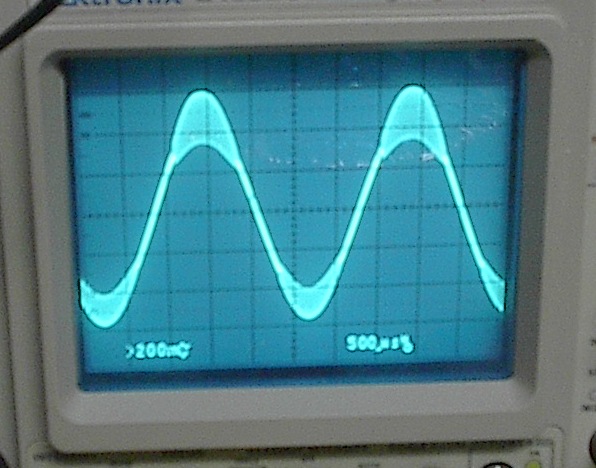

I see some ringing, evident in both halves of the sinewave, but I did hit 34Vrms before clipping. That's about 680 watts. I'm not exactly sure what the resistance is of my load - the POS Extech reads from .2 to .6 with the leads shorted, so it could be as low as 1.5 ohms.
Now, the ringing. There isn't a clear oscillation, just the ringing. More in the top of the wave than the bottom.
Doesn't that look like the amp is bursting into oscillation when the voltage goes above or below a certain voltage ? Possibly due to some capacitance across a device varying significantly with voltage ?
Is that oscillation with or without load? What is the output power and load? What is the freqency of the oscillation? It could be global instability due to the output stage slowing down at high currents OR local oscillation in the output stage because of the same thing. If it is local oscillation inserting a resistor between output base buses and drivers could help. Inductor in parallell with resistor is another possibility, Crown uses this in many of their amps.

Are you sure that is really oscillation? It could be also power supply ripple. Just slow the time base to 2 - 5 mS / div to make sure.

ashok said:Doesn't that look like the amp is bursting into oscillation when the voltage goes above or below a certain voltage ? Possibly due to some capacitance across a device varying significantly with voltage ?
Hi Ashok,
Yes, it seems that way doesn't it. There's no sign of it when the load is 8 ohms (with an even greater voltage swing), so it has to be related to the current output into the lower impedance. Generated in the output stage then back through the feedback?
megajocke said:Is that oscillation with or without load? What is the output power and load? What is the frequency of the oscillation? It could be global instability due to the output stage slowing down at high currents OR local oscillation in the output stage because of the same thing. If it is local oscillation inserting a resistor between output base buses and drivers could help. Inductor in parallel with resistor is another possibility, Crown uses this in many of their amps.

That picture is the amp operating into a 1.6 ohm dummy load ( i confirmed the resistance - I put it in series with a known resistor).
The rms voltage through that load was 34V, so ~722watts.
It wasn't full blown oscillation, just ringing at the top and bottom portions of the waves.
I have both a Zobel and a Thiele network on the output.
I am trying different things to track down the cause and I'll probably be trying all of your suggestions.

whoandcar said:Are you sure that is really oscillation? It could be also power supply ripple. Just slow the time base to 2 - 5 mS / div to make sure.
No, definitely not PS ripple. 🙂
The preceding tests were with the MJE15031 as the VAS driver. I changed to the 2SA1011 to see if there would be an improvement. I also changed the load to my 100 watt/ 4 ohm dummy. It started out ok, and I managed to drive the load to clipping (~43Vrms - 462 watts), but then it started to go crazy. bottom half of the wave dissolved into ringing and then she flatlined. That 1011 is toasted. I'm not sure why it konked, I didn't let it clip for long, half a second maybe.
So, I changed back to the MJE and tried it again. Looks fine at 4 ohms with the MJE as VAS. My 4 ohm dummy can't take ~500 watts for long, so I shut it down.
I found 2 10 watt, 1 ohm resistors in my junk heap and paralleled those and added them in series to the homemade "resistors" to bump up the impedance to 2 ohms. I also added a silver mica 100pF to the B-C of the lower driver (like in the P68). I hook it all up and it occurs to me that maybe my homemade resistors are inductive, even though I wound those bifilar. Could this be the reason I am see this ringing?
Anyhow, I try it again and the ringing is all but gone in the lower part of the wave and greatly reduced in the top half, so the cap across the driver is doing something.

I wouldn't call that ringing, ringing is to me something that happens around "sharp" edges. For example when clipping or doing square-wave tests. It is very possible for circuits to oscillate only at certain output currents due to the fT varying with Ic.
You could try scoping the VAS output node, the output bases and the output before output inductor//resistor to see where it originates from. If the oscillation is stronger on the output of one stage than it's input you have a local oscillation.

Global oscillation doesn't have to mean it oscillates all the time, I meant global as in loop oscillation VS local oscillation. I'd start with measuring if it is global oscillation or not, but changing the cap is of course another way to test it.
It helps keep the CFP under control, Try the cap on both drivers, top and bottom, and then try a larger cap value, like 220pf or more. The output stage has more current than a VAS, the smaller cap values don't make as much difference with output stage.
