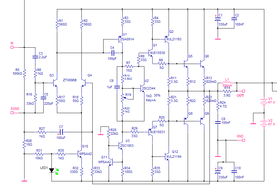

Would increasing the Miller cap defeat the purpose of the low Cob VAS?
Hi John,
Something to keep in mind is that understanding and designing for stability is not a simple matter.
As Glen has already mentioned, the faster VAS probably needs more Cdom to provide the same stability as the large MJ device. No the MJ is not better, what it has is a large internal Cdom that allows us not to have to put a large one in the design but obviously it is a false "improvement" since the internal Cdom is highly non-linear and is a source of distortion. What is important is the dominant pole position, the advantage of the faster VAS is that the smaller non-linear internal C is swamped by the larger (linear) external Cdom when the pole position is held constant. You might have to add 200 to 500 pF to get the same pole position. You could look at the open loop -3dB point to test this.
I do like the CFP driver and have had one with a twist in mind for my next design for some time now. However, stability under real world conditions has to be kept in mind and investigated.
You question why making the VAS faster makes the stability worse. The pole formed by the Cdom cap and the diff amp output impedance is intended to be the main low freq pole of the design when Cdom is the compensation scheme. Other poles must be much higher in freq, and using a "better" VAS makes it worse since your moving up the dominant pole freq when you do not compensate externally to bring it back down.
There is the issue of output stage bandwidth with the increased capacitance with so many output devices. However, things do scale, there is more capacitance but if you scale up the drive to the output stage then the bandwidth stays the same. You have a large MJ device driving the output devices on, and you have a very small 3.3 ohm resistor to turn them off. This is good. But remember you are using slower devices than in your Patchwork amp. Also, that particular MJ driver is slow, might try a faster high power type. I notice that you have no stoppers in the output stage, don't know if they might help.
OK, so the amp has problems in clipping, this is not surprising, BJTs are *very* slow coming out of saturation so the output stage pole is lowered when you clip, and margin is lost. I believe that an HF oscillation starts when you clip and this causes the DC offset.
I suggest using the better VAS but keep in mind that it has to be large enough to handle the worst case overload and capacitive drive conditions. The higher rails in this design indicates that you should keep a closer eye on SOA for the VAS.
Another thing to keep in mind is that high open loop gain reduces distortion when operating in the linear region below clipping. However, once the output stage clips the high gain means that the earlier stages will be driven harder as they attempt to correct for the output distortion. You need to consider saturation of the earlier stages so that they recover gracefully. Reducing the OL gain as you have, obviously is one solution.
You might consider a single resistor in place of R9 and R20, 10-15 ohms.

i think the capacitance of the VAS changes as Vce changes.
A low capacitance transistor//ideal cap is better than a high capacitance transistor.
I would go further and remove the 1011 which is a driver type and substitute a true low capacitance transistor for the VAS. Then EF it to generate the current required for the next stage.

Rod's design in BOTH P3A and P68 use a 100pf cap on the b-e junction of the drivers. Your amp has no such compensation. I did this myself but used 1000pf (102) and it worked fine, even plays great with treble under testing. You may want to try this to improve stability.
Hi EWorkshop,
Here is the current state of affairs:
- Amp runs stable now since the removal of he EF on the VAS.
- When using the 2SA1011 for the VAS, 10-20VDC shows at the output when the input cable is unplugged. This doesn't happen when I use the MJE15031 for VAS.
I am still operating on +/-35v supply due to concerns about the DC at the output. I will increase it to full supply voltage today and check to see if the clipping performance has improved, but I'd really like some ideas as to where this DC is coming from and why it doesn't happen with the other VAS driver.
I did notice the compensation cap Rod added to the lower driver. I assume that clears up the minor ringing evident in the negative going part of the wave when using the MJE as the VAS.

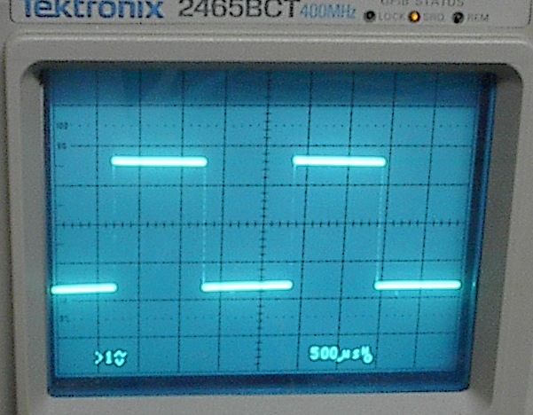

Here's a pic of the amp running with a ~1kHz squarewave. This is with the MJE15031 as VAS driver.
Isolating your two current sources is important as has been already mentioned. I believe Self provides an explanation.
I also suggest diff pair degeneration as long as you maintain enough open loop gain.
Some small resistance in the emitter leads of Q3 and Q25 will limit the maximum current driven into the base of the ouput devices and how deeply they're driven into saturation. Something around 10 ohms keeping in mind that it will limit your max output current drive and don't go too large.

Have you tried driving that square wave into clipping? Probably not a safe thing to do at the full supply voltage but not a problem at +/- 35V.

The DC is negative. It extinguishes the LED, similar to the clipping behavior.

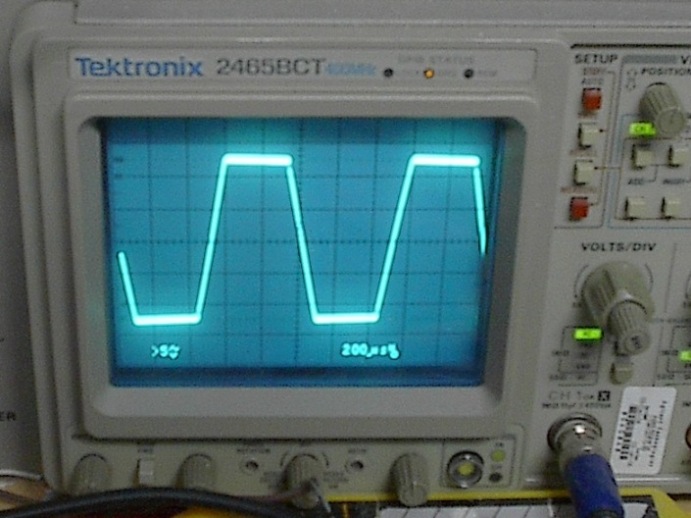

I have clipped the squarewave, and with the MJE it clipped cleanly. With the 1011, It completely collapses to the 20VDC output. This is interesting, because I switched back to the MJE VAS and it's now behaving the same way - clipping collapses to DC output. Is this a clue that something maybe damaged?
Ok, let's break it down. At this time I'm willing to change anything in the amps front end within the design criteria: this is a subwoofer amp, and will not operate above~100Hz, therefore we should forgo any improvements that don't deal with stability, distortion (within limits) and clipping.

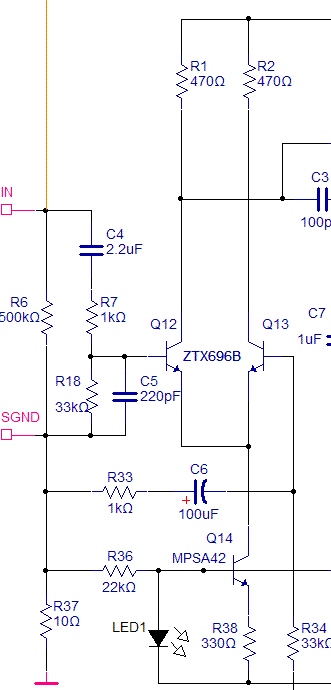

Lets look at the input first. I have the basic LTP with a MPSA42 as the current source. I was tempted to use just a resistor here, but thought this better. Wg_ski suggests lower values for R1 and R2. Pete says degeneration emitter resistors for Q12,Q13. The current mirror is gone for good.
Other possible concerns?

Yes it seems that something is broken, or perhaps you have a short somewhere.
LED going out, probe around and find out why, check supply rails, transistor voltages, something is seriously wrong. Do you have the LED biased on strongly enough? Don't like that 10 ohm resistor in the front end ground. Are all the resistor values correct as installed, etc.
I think it is important to understand the difference in the VAS, I'd like to see you get it working normally with the slow part, then see if it matches with the faster part and say 1000 pF as a Cdom cap. This is just a test to rule out global loop oscillations, and help determine if it is local to the output stage. However, with 20V DC offset something is seriously wrong in the global loop.
Degeneration resistors are very basic to improving the overload characteristics of the front end. See the long discussions related to the Leach design. I suggest that you look at the VAS collector during clipping and you might be surprised with the behavior. I have a strong preference for a mirror in the front end, even if you need a bigger Cdom cap to reduce HF gain, it helps keep the front end balanced.
Basically, I prefer the mirror, and EF on the VAS, with a larger Cdom cap to make it stable. The theory suggests that even if you use methods to increase the OL gain reducing it again with a Cdom cap should provide the same stability. You have a slower output stage than with your other amp, so stability will be more difficult.
I know that you're going to do what works best for you and gets you to a solution fastest so I won't go into a lot of detail on the rest.

I'm not sure why you are having problems clipping. IMO the stability has something to do with it. CFP usually clips strong and hard, and I prefer it to EF for subs for strong output.
Try this...
You could try 100pf at b-e of Q14 current source
A 1 or 2.2 or 3.3 ohm resistor for base of drivers Q3 and Q25 I would try 1 ohm first.
Try 1000pf (102) on the B-C of either your predrivers or drivers, or maybe a smaller value on both. Being you have 33ohm on base, a cap on that transistor combined with the base resistor, would filter out some HF or RF. I used 100 ohm base and 1000pf and no problems.
Use emitter resistor of 2.2-10 ohms on CFP drivers (Q2,Q16). I used 4.7 ohms on my driver emitter, this stability tip was given to me on someone here at diyaudio about 2 yrs ago. Sorry I forgot to mention it earlier.

Hi Pete,
I changed R39 to 220 ohms and that solved the DC/clipping collapse problem. I guess the VAS is drawing too much current at ~11mA with this setup. Perhaps we need to look at a separate active bias for the VAS CCS.
Changing R39 reduces VAS current to ~5.5mA. This raises a question: how hot should the VAS run? I know from the Patchwork project, lowering the VAS current to ~5mA helped on many fronts, and didn't hurt performance in the least. Full power distortion testing with Anatech on that amp showed remarkable performance, as accurately predicted by the simulator.

I have played with the simulation for a bit and come up with the following schematic update.
I tried to find models for the new transistors I'll be using , but was unsuccessful. I did find models in that closely match these, especially the capacitance. I used the ZTX458 model for the 2SC1953 and the ZTX558 for the 2SA0914.
I have made some of the recommended changes. The schematic only has 2 pairs of outputs showing, but that's just so I can fit the drawing in the space here.
The original values for R1 and R2 in the P68 seem to be correct. At 560 ohms the currents through the differential pair are balanced, at least in the simulation.

I drove the real amp well into clipping, and it looks good. I left it like this long enough to take 3 pictures, (pick which is the clearest) about 30-40 seconds. The VAS didn't get hot at all. The amp is only running on half the supply voltage, but the simulation give the same results at full power.
