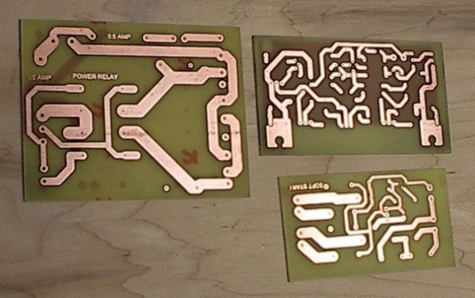

As for the guts, I etched 3 boards tonight. The main power relay board, the soft start board and the power amp front end board.
Depending on my work load this week (looks light), I could probably test fire this amp on lower rail voltage in a couple of days. With the amp front end board populated and connected to the output stage, there will be no reasons not to try it.
I must say that I'm hooked on the laser transfer method for PCB's. I went to Staples and got the correct photo paper as recommended by Tom Gootee, and it makes a huge difference. I have used magazine paper which works, but not as well as the photo paper.
The etchant I use is Tom's formula too - peroxide and muriatic acid. This is fairly cost effective, the only problem being that I can't find peroxide in bigger than 300ml bottles (they cost $2.59 each). Kinda eating up the cost savings with the peroxide alone.
Listen to me whine! Here's the 3 boards. Ready for laser transfer silkscreen. :up:

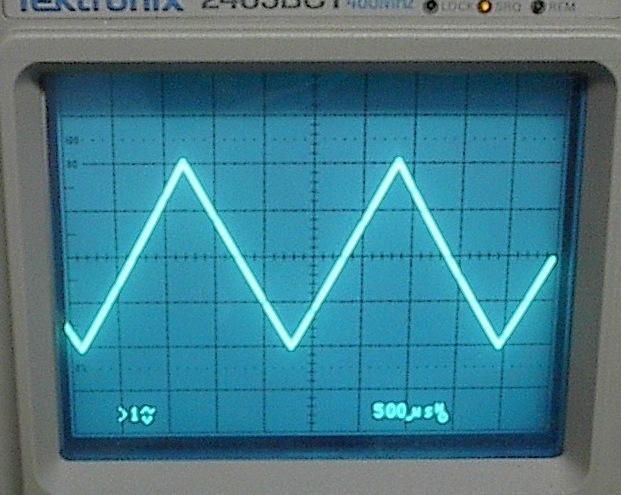

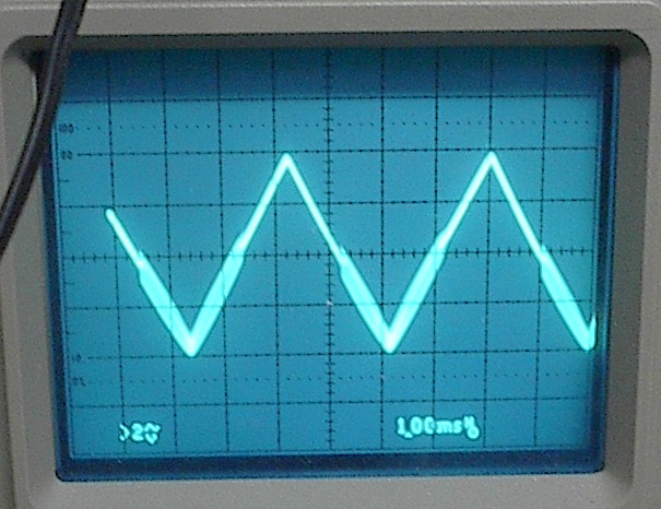

Well, I put the pedal to the metal last night and finished populating the amp board. I found that I could have made it a bit bigger - it's pretty tight, but everything fit ok. connected it to the output stage and gave it a try with +/-9V, low current power supply - output is at negative rail voltage. Looking things over, I see no bridges or other obvious problems. Check to make sure all of the transistors are oriented the correct way. I had the VAS backwards. Always a good idea to start off with low voltage to check for these stupid mistakes. No harm done.
Flip the VAS around and everything looks good, 4-5mVDC offset, no smoke. Hook up the scope and FG and wow, seismic activity! Looks like oscillation. I rig up a Zobel and that greatly improves things, but It still has it bad negative going. It's clear to see in the pic below.
How am I going to make this amp run stable? Given the special circumstances involved (large output stage on the heatsinks that are conducting rail voltage)? This is still at +/-9VDC supply, I need to tame the instability before I go higher.
You have insufficient current in the VAS. IIRC, you use a boot strapped collector resistor, and Idq will go way down with only +/-9V. Some amps will squeal audibly as the rails drop that low. Raise it to +/-30 with a lightbulb limiter and I bet it goes away. Once you've got the gross problems ironed out you can do that.
I was sort of thinking along those same lines - that current supply was too low. I will try it on my +/-35V supply and see how it looks.
I did try a higher Miller cap (paralleled another 100pF) and it made a difference, but didn't completely clear it up. That got me thinking about the high open loop gain of the EF VAS, and how increasing the emitter resistors in the LTP would reduce this. In my haste to get it done last night, I used 39 ohm resistors instead of 56 ohm. On another project it was recommended that these be increased to 100 ohms or more.
Something else to check.
At +/-9V rails your amp would never work well.
Use the whole +/-70V rails! Don't forget to apply a 60W light bulb in series with the mains tranformer's primary coil!
Don't afraid, the bulb protects your amp in case of any short circuit etc.
If an amp is designed for +/70V rails, then use +/-70V rails. :up: And not +/-9V! In my opinion the +/-35V as suggested here is low too!

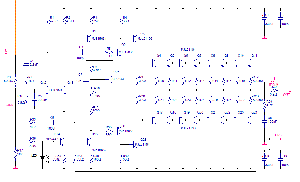

I did go to the +/-35V supply and had the same instability. I'll post the schematic again here for reference. I'm having a real problem with adjusting the bias - with a tiny turn to the multiturn pot, it jumps from 0.1mV to ~35mV. I experienced this before on my Patchwork amp, and overcame the problem, but I can't remember exactly what I did to solve it.
I have tried different resistor values in the Vbe multiplier, different (higher) resistors for the bootstrap. Nothing has worked so far.
Things I would try in this order:
Insure that your CFP drivers are physically as close together as possible. Any parasitics get amplified and phase margin can disappear. You have half on the PCB and the other half on the HS, and wires over a couple inches will make it so that it will never work at all.
Reduce C15 (use fractional uF). I've seen too large a cap here cause the hysteresis you're observing in the bias, as well as switchoff problems.
Degenerate Q4 slightly. Experiment with an emitter resistor.
Reduce R1 and R2. You want about 50mV drop, no more is needed.
Try the amp without a zobel. Don't ask why but sometimes it works

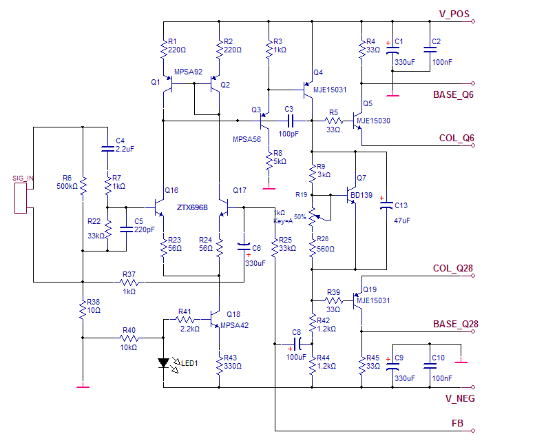

So, with that in mind, another kick at the cat. I have revised the circuit to include the changes above plus I have substituted the bias generator for the one from my Patchwork amp. This uses a different transistor with a higher Vbe than the BD139.
I have also switched to a current source instead of the bootstrap.

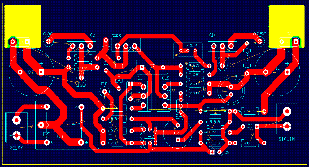

Here's the board layout for the above. I have decided to go ahead and etch it, the thought of trying to do it on perf board is too depressing.
I have made the layout a bit more spacious and I've included an input muting relay that will pull the input to ground when released. I thought it would be a good idea to do this so that the speaker switching relay will not be switching a heavy load.
I have also made a slight change to the Vbe multiplier, adding a resistor.

Removing the VAS buffer and current mirror transistors would have the effect dramatically increasing the load on the LTP and reducing the open loop gain.
Since this fixed the instability problem, try reducing the OL gain a better way.
Put the VAS buffer and current mirror transistors back in circuit and add a pair of 220 ohm emitter degeneration resistors to your LTP.
Miller compensation in this type of topology can be prone to trouble if the gm of the LTP is too high (it can't get rid of enough gain).
Using an MJE15030 with a Cob approaching the value of the external miller comp cap wouldn't help things either.
