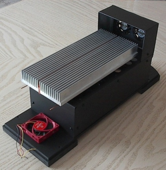

AVWERK said:
Keeping the fans at the end will create an uneven temp at the extreme ends of the heat sink.
You can even this out considerably buy blowing the air down at the center so it exits equally out the ends.

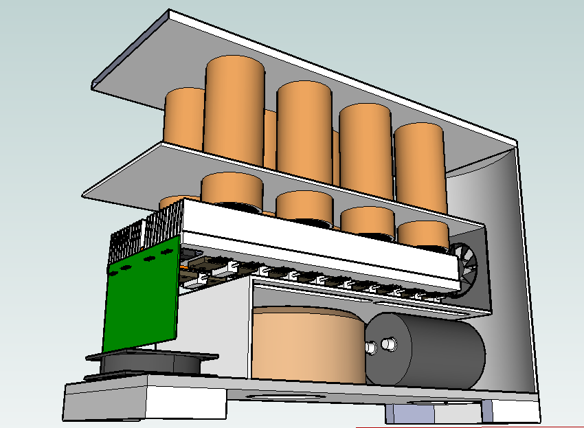

Hi David,
Under normal conditions, I'm hoping the chimneys will get rid of most of the heat, and the fans will only kick in when the amp is heavily loaded. That's my expectation anyway, won't know until it's up and running whether it works or not. I thought about mounting fans above the heatsink a la CPU style. In the end, I thought the chimney was a more eloquent solution, plus the chance of silent running.
These chimney pipes will be 2" copper and the plate that is the top of the heatsink "chamber" will be 3/16" aluminum. This should make for good heat dissipation.
This would be all the more effective except for on thing: the entire exterior of the case will be wood - 1/4" hardboard and MDF. Good thermal insulation.
Another view:

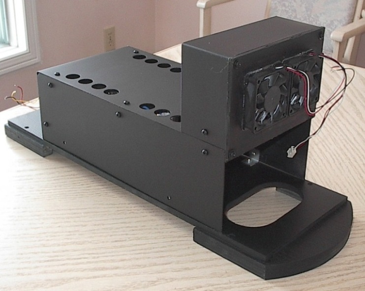

I have some of the chassis complete. The parts that make up the interior including the base are virtually complete. The heatsink fans are mounted and run very quietly, even with 13VDC (supply from a small power adapter). The rubber damping sheet works as expected.
The base is 5/16" laminate flooring, which is very hard and strong. The feet under this is 3/4" plywood. These will be wrapped with a stainless steel band to make them look impressive. 😉
The power supply shroud is 16 gauge aluminum (replaced the door kickplates on one job with stainless steel and salvaged these). Free stuff is good.
The fans housing is also this same aluminum, except for the rubber sheet the fans are glued to.
I painted the whole thing with high temperature flat spray paint.

I wound up having to increase the overall size of the case a bit, as I initially underestimated the size of the transformer and smoothing caps. The width now is 7" and the depth is 19". The height is not determined yet., but shouldn't be higher than the original 12" estimate.
I am stalled in the progress now because I don't have the copper pipe for the chimneys. I'll stop at the plumbing supply tomorrow and pick up a piece.
A shot from behind. The single circulating fan (which will run constantly when the unit is powered on) is not mounted yet. I need some small coil springs (like in a ball point pen) to mount it. This is like the rubber sheet, vibration control. Fan noise is unacceptible.

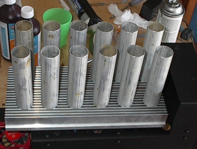

And no I'm not. Rummaging out in my garage, I found a broken aluminum skimmer pole that I'd saved thinking there would be a use for it. It's 1 1/4" OD and about 6' long. I sanded it a bit and cut it into 5" pieces.
This will now be a V-12. 😀

I am on a roll today.🙂 I have cut and drilled the 3/16" aluminum plate for these pipes to fit in and cut the top that they go through. I used a 1 1/4" holesaw to make the holes in the plate. I ground the "set" on the teeth of the holesaw to make a VERY tight hole for the pipes to fit in. I had to drive them into the plate with a hammer and block of wood. I was looking for good thermal contact between the plate and the pipes and I think I have it.
All of this multi flue chimney will be painted a couple coats of flat black. I'm counting on the thick aluminum plate to catch the radiated heat from the heatsink below and release it into the pipes as well.
That's enough for today. I have made good progress on the mechanical aspect of the build, now I need get back to the electrical with some more circuit design. In particular, the power supply.

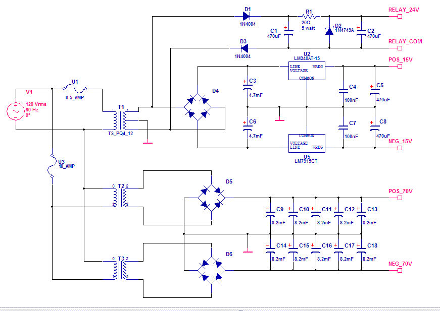

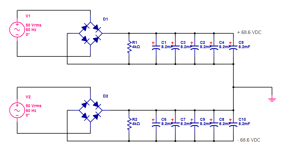

Included in the order are 10 - 8200uF 80V capacitors. I have decided to use banks of caps for the power supply, rather than the 2 big single caps. This will give me 41000uF per rail.
The power supply uses two FWB as the transformer has dual secondaries. Otherwise just a plain, linear PS with no frills.
Does this supply need snubbers?

Parts came today. I have everything I need to finish this except time to do it all. 🙂
Made some progress on the case (pics to follow) and I have been working on the power supply layout.
I need 24 volts to operate 2 relays (for soft start switching and speaker out). I also need regulated +/-15V for the Linkwitz transform. The components for these will be on a small circuit board, which I haven't done yet.
Here's how the PS is looking:
Finished board layout for the top portion of the power supply above (24V and reg. 15V). Printed it and etched it, now I'm populating it. Not much but it's a start on the actual circuit anyway.
The +/-70V will be wired point to point with #12 solid copper wire. I was trying to make everything fit - ironic in a case so big. The ten smoothing caps still take up a lot of space (but about half as much as the big ones pictured above). The 12-0-12 transformer is a 2 amp unit so it's not overly large. Pics coming. 🙂

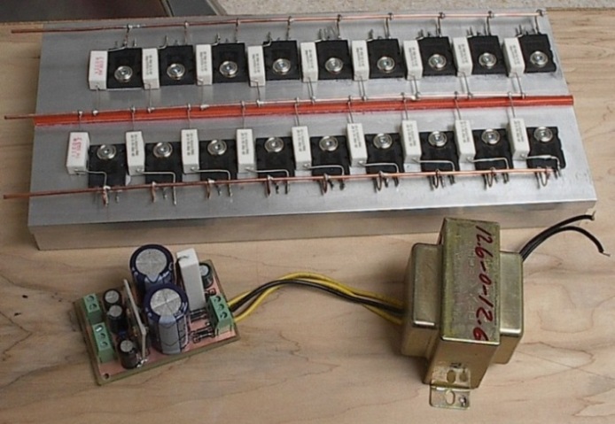

Here's the low voltage power supply board (with transformer) and the output stage with the emitter resistors installed. They are .82 ohm / 5W. These connect to a #12 solid copper wire that runs down the middle of the heatsink. It looks puny, but I don't think it will have any problem handling the current involved.

It would be a smidge counterproductive to undo the output stage that I've built in favour of MOSFETS, don't you think? Besides my moniker, the doctors say I'm not ready to play with MOSFETS yet. Most would say I need to stay away from the BJT's too. 🙂
I want ample SOA. With the potential for a supply upgrade at some time in the future, I thought I'd overdo it a bit. Besides, I have lots of MJL's.

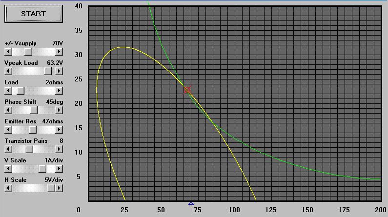

Here are you load lines for 1kW into 2 ohms with 8 pairs of MJL2119(3/4).
With a 45 degree phase shift the 1 sec non temperature-derated SOA is slightly violated.
So, 8 pairs isn't really that over the top for the power rating. For domestic use, with only moderate occasional abuse it should hold up quite well.
:up:
Thanks Glen,
The transformer I have now is a 50-0-50, 850VA unit, so not up to the task for 1000W into 2 ohms. I may get a bigger one in the future if I'm still interested.
Moderate occasional abuse is a given. 🙂:bigeyes:
