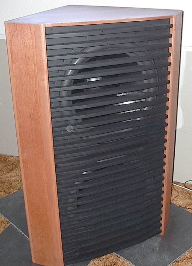

The sub I have now is pictured below. It has two 18" drivers (mj-18 from Mach 5 Audio). These were very cheap but well suited for this application - a sealed LT EQ'ed sub. The internal volume of the cabinet is 100 litres and the idea was to drive the resonant peak up to ~80Hz, thereby giving a flat, easy load for the amp to drive below that (where the LT has the most boost).
This sub, properly driven, is THE most impressive audio thing I've ever made. The bass it produces is pure, with no hint of "boom".
This has been driven hard by me and was truly tested when my son (17 years old) had a few of his friends here when I wasn't around. They gave it a workout!

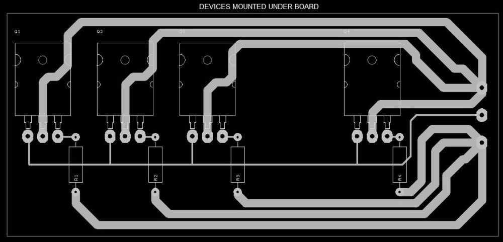

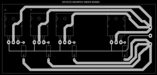

If you really want to mount a load of output devices, I would forego doing that on a PCB and borrow an idea from AmpsLab:
As you can see (if you look closely!) he's used solid copper wire suspended between two terminal blocks to provide the power, output and base wires. That would work far better than pcb.
If you really DO want to use PCB, then you could simply reinforce the power tracks with solder or copper wire bent into the right shape.

jaycee said:If you really want to mount a load of output devices, I would forego doing that on a PCB and borrow an idea from AmpsLab:
Hi jaycee,
The pic is not coming through for me but I went to Ampslab and viewed the layout.
I will be doing a similar thing as I won't be using a pc board for the output stage. I have also decided to use the heatsinks for the rails.

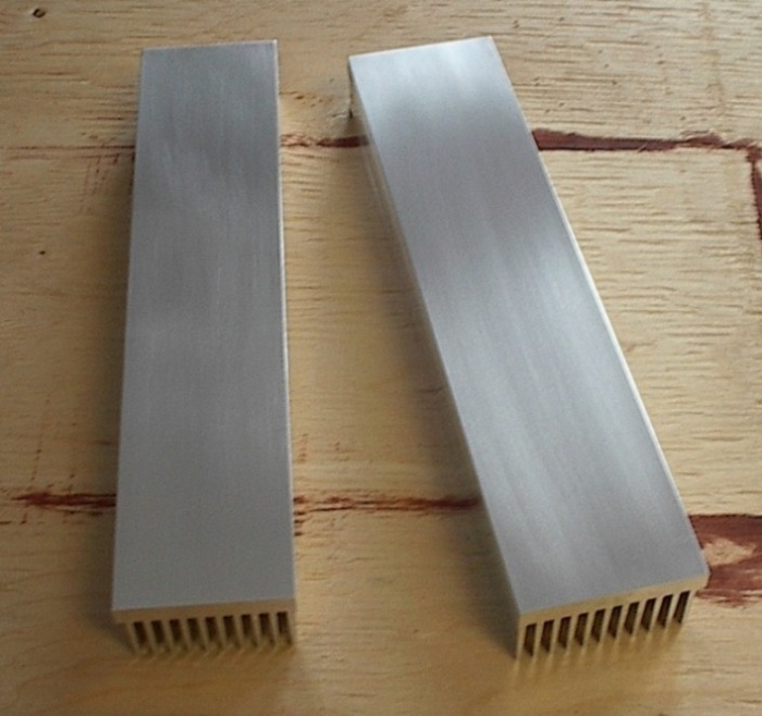

To this end, I have cut the heatsink in half. Well, not exactly in half - the sink has 21 fins, so one side has 11 and the other 10 (not wanting to waste that fin!). I did the cut on my table saw, using a 7" Morse Metal Devil blade (I use these at work in a handheld saw for cutting steel doors). The base of the sink is 3/8" thick so I did it in 2 passes. Clean cut.

Here's a pic of the cut heatsink. I took the time to make sure the surface is perfectly smooth by sanding with 400, then 800 grit paper. I put the full sheet of sandpaper on the very flat and smooth aluminum top of my table saw and rubbed the heatsink on it, using water as lube.

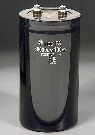

I will be getting 2 - 68000 uF, 100V caps from Apex Jr.
This should be good to start with?

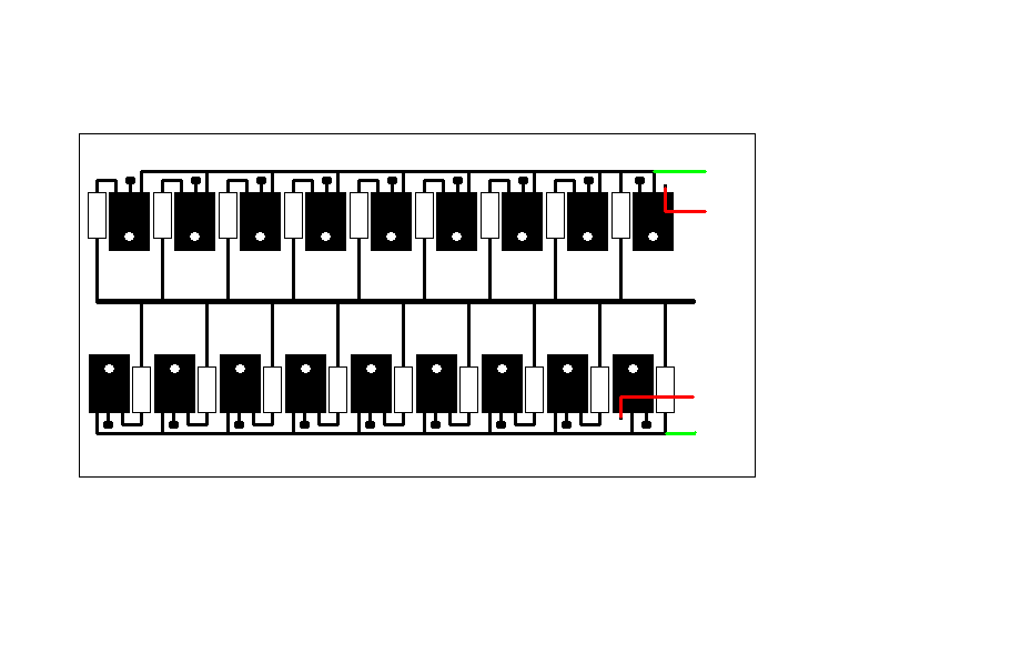

My original plan was to use a single board for the whole amp. I then though about P2P when I laid out the MJL's on the heatsink. With my decision to have the heatsinks at rail voltage, the deal was done.
The plan from the beginning was for this amp (like it's predecessor) to be in a case, not in the sub itself. A little careful design with the case and some cooling fans and the heatsinks will be out of reach.
I did a sketch of the devices on the heatsink (now two) and it looks good.

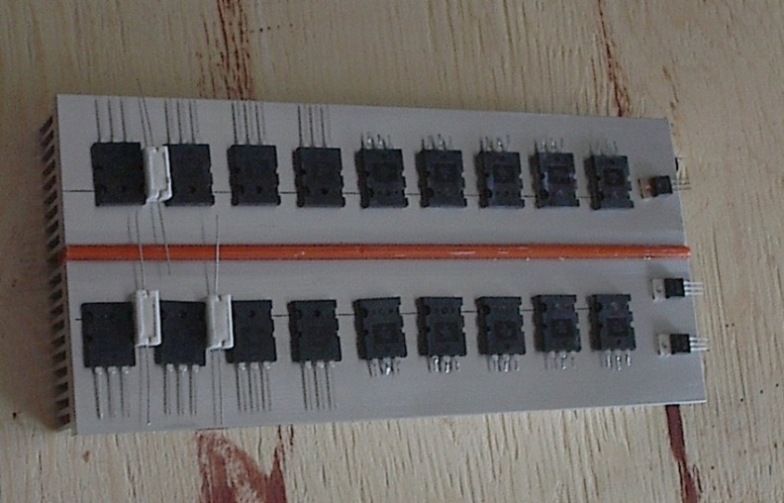

I put the heatsink back together last night. I glued a thick piece of plastic in between as an insulator.
See in the photo I'm recycling the devices from my original amp (the ones with the short leads). That means no sub till this is done!
The hardship I endure to save $50.00 worth of transistors.

Using the heatsinks as rail conductors enables enough current carrying ability and I'll use solid #12 copper wire for the output lead.
I have mounted the outputs on the heatsink(s). I made some aluminum dust and mixed it with the thermal grease and "lapped" each transistor in place. There is good conduction, both thermal and electrical between the case and the heatsink. I tested the electrical connection with a 60 watt light bulb and my 35 VDC bench supply.
The last 2 that are part of the CFP (Q6, Q28) are mounted with mica washers and thermal grease.
I made "bus bars" from 12 gauge and 18 gauge copper wire to supply the base of each output from the collectors of Q6 and Q28. There will be another one right down the middle for the output, after I get the right ballast resistors. These resistors will fit between each output transistor, under the bus bars.

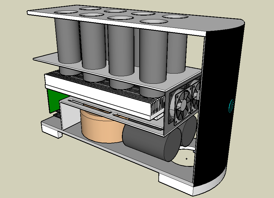

While I wait for parts, I thought I'd do some playing around with Sketchup to put some of my ideas on "paper". Having 140 VDC running through the heatsinks means they have to be out of reach. I could do as the tube dudes do, and cage it. That look is not appealing to me though.
I always planned a case for this amp, but having the heat source deep inside creates a problem. How to efficiently remove the heat?
I wanted to avoid fans, as they are noisy and for this much potential heat they might not be wholly effective. I've read about "chimneys" for heatsinks and that got me thinking. If I use temperate controlled fans with a chimney arrangement, this might be the way to go.
Looking at the attached picture, you'll see the 8 chimneys that start just above the heatsink and exit the top of the case. The case itself is a computer tower style about 12" high, 6" wide and 16" deep. 2 temperature controlled fans are at the front of the heatsink and a third fan, which will aways be running, is at the back on the bottom. The two front fans will be mounted on a rubber sheet (inner tube) to damp mechanical vibration.
On the bottom, there is the toroid and the big smoothing caps. An aluminum sheet separates this from the amp section. Also on the bottom is another 2 vent holes - one in plain sight and the other directly under the toroid. At the end of the heatsink is the circuit board for the amps front end (also a Linkwitz transform on the same board).
Yeah, it's complicated. It big, it's manly with exhaust pipes that resemble headers on V8 engine (in this case a 426 Hemi, ready for a '71 Cuda ))))O>. It's a challenge though and worth the effort for bragging rights alone.:

Keeping the fans at the end will create an uneven temp at the extreme ends of the heat sink.
You can even this out considerably buy blowing the air down at the center so it exits equally out the ends.
