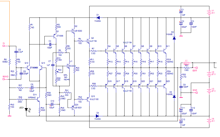

Replace those slow MJL21193/MJL21194's with a pair of MJL4281A/MJL4302A and see if it is still stable without base resistors.🙂.......
I prefer to add the 6Vac to the AC before the main rectifier. Then rectify the high voltage AC to form the low current high voltage DC supply for the front end.MJL21193 said:The extra voltage for the front end will be supplied from a 6.3-0-6.3 VAC transformer. This rectified voltage will be added in series to the main power supply for the front end (as shown in the schematic in post#158.)
"That's why you need a base stopper on *each individual device* when paralleling. Try it without them on a FET output stage and it's almost guaranteed to oscillate."
These transistors aren't insanely fast like FETs, the problem is more likely the previous stage not liking the capacitive input of the last stage. QSC parallells transistors like these without individual base resistors without problems.

CBS240 said:Replace those slow MJL21193/MJL21194's with a pair of MJL4281A/MJL4302A and see if it is still stable without base resistors.🙂.......![]()
I thought about this, but didn't mention it (fear of ridicule😀 ). I will replace Q3 and Q15 with the faster units. I have a few of these here.
I have attached the schematic from post#158 unchanged for perspective.
But QSC mounts everything one one PC board, with undersized heat sinks with the collectors at ground potential, and the layouts don't use huge copper flood areas to minimize the resistance. The RMX2450 also uses only 4 in parallel. Those layouts are more "ideal" from a parasitics standpoint, and in those cases stoppers are rarely needed. Go running bus wires off the PCB to remotely mounted devices spread out all over hades (or the huge copper flood areas I use for buses on the PCB) and you usually have to do more to tame it. Usually, if I use more than 4 in parallel, I design the stoppers in. I've had too many amps that oscillated for no apparent reason (other than possible parasitics) that frequency compenation wouldn't help but 1 ohm stoppers cleaned right up.
MJL21193 said:
Hi wg_ski,
Do you really think it's absolutely necessary to have base resistors on all of my output stage devices? I have decided to have one to supply all, not wanting to tear down the work I've done already unless it's needed.
This amps predecessor, the P68 500 watt version had no base stoppers at all, not even on the drivers. I guess Rod doesn't believe in them. Anyhow, that amp ran stable, and it had 4 paralleled outputs per side plus the CFP.
I just got lucky, I think.![]()
Not *absolutely* but many times it fixes things that have no apparent cause. Actually, the causes are well understood, if you have a model for your circuit (specifically, the circuit construction) that is valid up to a couple megahertz. As a general rule, if an audio circuit has a poor RF layout, you'll need to work on stability a little more than with a good RF layout. That usually means a little less open loop gain, and lower power bandwidth. Base stopper in the OPS scrub a little off both.
Why put them in the bases of each output? Because the parallel bank is actually a distributed network, with unequal resistances and inductances to each device. From an RF standpoint, a fixed resistor in series with each devcie helps equalize this.

In the schematic above, Q3 and Q15 are drawing a considerable amount of current. Do you think there is enough current supply from the auxiliary winding on the toroid for these, as they are included in the higher voltage supply?
MJL21193 said:
Hi Andrew,
They shouldn't be. The entire darlington triple should be running off the main supply. If you don't you'll find yourself burning out drivers when you clip heavily. Not to mention that the outputs will "stick" to the rails when saturated. Even in the preferred location, the predrivers will stick to some extent, but those MJE's are much smaller and faster and the sticking isn't as pronounced.
That's a good point. Still it feels like an easy test adding in common resistors to see if that's enough. I've seen an emitter follower BC547 taking of at a couple of MHz driving just one BD139 or similar transistor so it doesn't feel too remote that isolating driver and output will be enough in this case.
If it isn't enough then the whole thing probably needs to be taken apart to install base resistors like you say.
megajocke said:[B
It's those pedestals in the VAS waveform when clipping that might be a problem. Have a look at the current through the base stoppers when clipping into an open output [/B]
Do you mean the base stoppers on Q2 and Q24? They show an increase in current during clipping, but it still is below 1mA. Rms current through Q3 and Q15 jumps from 167uA to 15mA with 1Vpp clipping and no load. 4.8mA to 18mA with a 4 ohm load.
I am not seeing any increase in current through the VAS though, under any circumstances.
No those will be fine, check current through R7 and R36 (output stage stoppers). How high does it peak during clipping into light or no load?
megajocke said:No those will be fine, check current through R7 and R36 (output stage stoppers). How high does it peak during clipping into light or no load?
Current jumps from 1mA to ~700mA with no load and with a 4 ohm load that's from ~150mA to ~800mA when clipping 1Vpp. These are rms values.
OK, so now I see it. Take the extra voltage away and the current doesn't greatly increase.

All amps with higher input stage voltage I've seen use some sort of clamping to make sure only VAS and diff stage can ever saturate. Without separate rails for input stage there is no need for such circuitry though.
wg_ski suggested 1 ohm stoppers per transistor might be enough, and with this low value (equivalent to even less than a tenth of the value you put in) there should be no need for an extra supply and the problems it can create. The MJLs have about 2V of Vce(sat) so there isn't much to be gained really if the base resistors are kept small. The common resistors can probably be reduced a lot from the 3.3 ohms if the problem is oscillation due to incompatibility between output stage and last driver. If it's interaction between the individual output devices that is the problem then you probably need to follow wg_skis's advice with individual resistors.
megajocke said:I don't know if I'd be comfortable with saturating the output devices
Yes, I'll scrub that idea. Not worth the extra power supply complexity either.
Moving forward, I will try the output stage with just a single base stopper, with the thought that I can always add individual resistors if it doesn't work.
