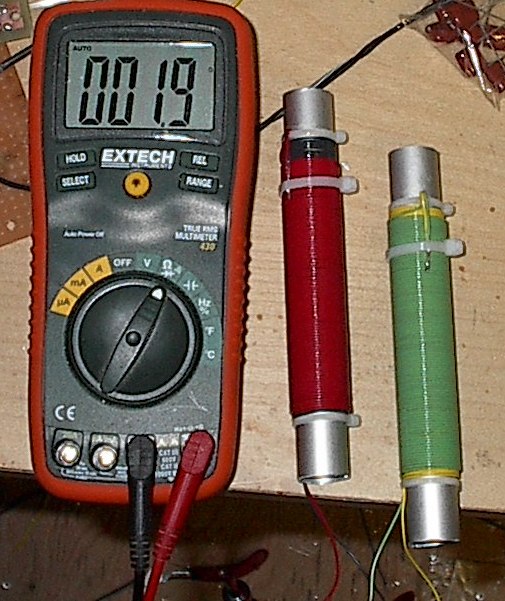

The testing I want to do will be relatively short duration. I would be submerging the load in cold water for cooling. This is what I did for my homemade "resistors", and the water got fairly warm after a brief test.
Mainly, I'd like to know if the power on these resistors is derated, similar to a transistor, or will are they good for ten watts regardless of temperature (within reason, of course).
I could just make another wound resistor of say ~.5 ohm and put this in series with the other two. Pic below for those new, that don't know about my resistors.

The ones in the picture are bifilar wound to kill inductance, I will just make another one, with an impedance of ~.5 ohms to make it to 2 ohms. My idea is to see how it performs at this low impedance. My last attempt was stable at 4 but unstable at what I now know to be 1.5 ohms.

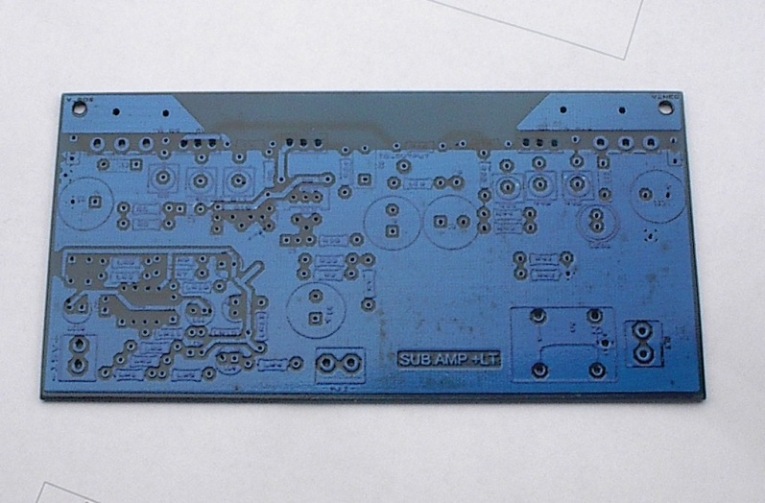

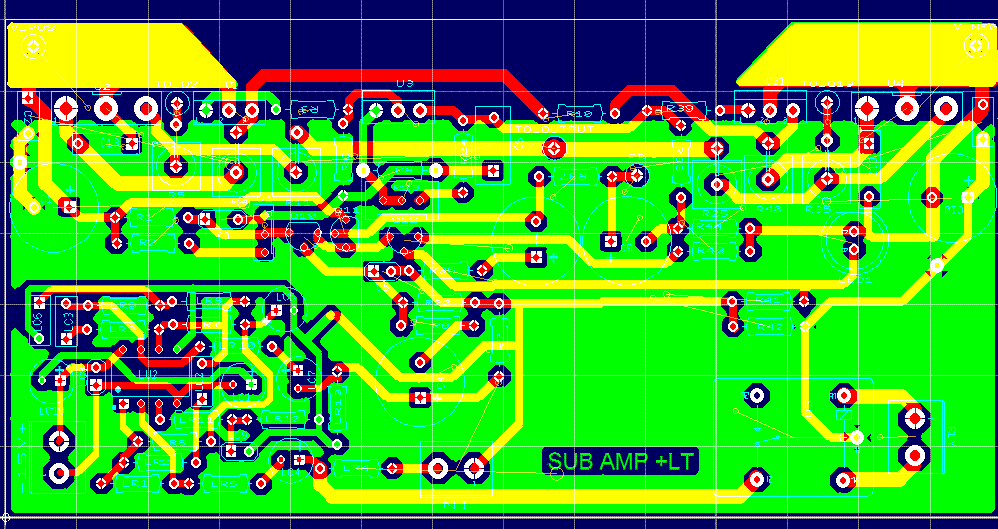

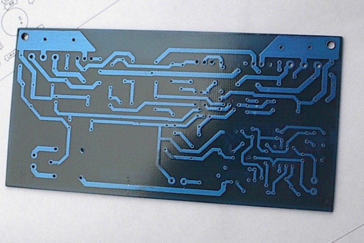

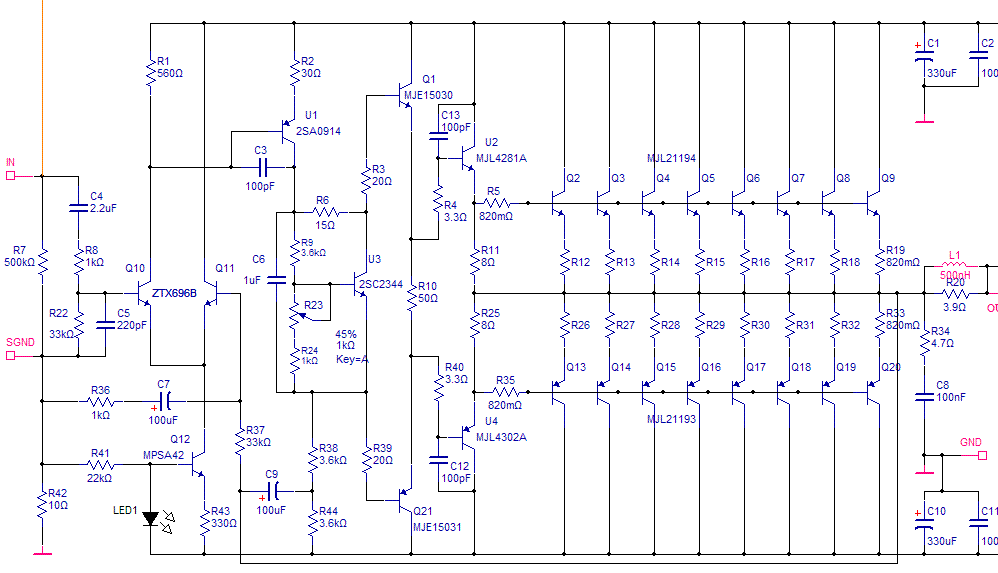

I spent most of last night doing another board layout. This really needs to be the final one now. Three times doing the same layout is a killer.
The board is bigger to accommodate the MJL4281A/4302A driver pair. I have tried to include all of the compensation components recommended, some of these will not be used unless needed. Better to allow the space on the board for them though, then try to squeeze them in later. I dislike a messy PCB.
As originally planned, I have also included the Linkwitz transform circuit on this board and, like on the last one, the relay that pulls the input to ground when the amp is off. My old version of this could produce a very heavy thump when powered up or down.
Board has been etched, silkscreened and is now getting the soldermask (I really need to keep this one).

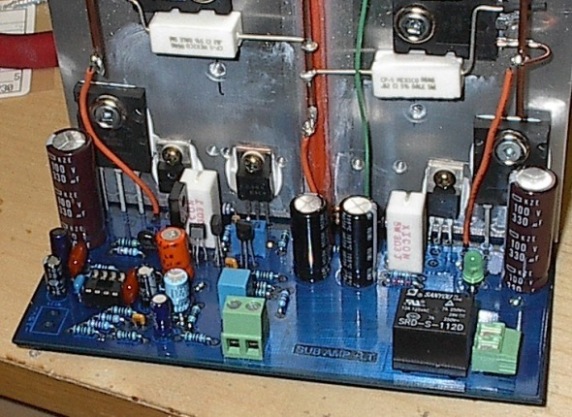

Another look at the new amp board, this time the component side. I have found the time since my last post to finish populating this and I'll talk about that next.

Anyhow, new amp board for the frontend is up and running. Last night I finished putting the components in and earlier this evening, I tried it at +/-35VDC. Naturally, I had the VAS wrong again. This time, it was from the layout. The pin out for the footprint was wrong - CBE instead of (for the 2SA914) ECB. I had to flip it and cross the collector lead over the base lead (like crossed fingers). It looks like it is walking away. 🙂
That done and everything looks A-OK. I am in the process of hooking up the permanent PS to give it a try.
Here's how it looks all dressed up:

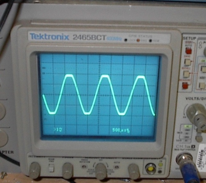

Alright. Full power test went well. No mishaps when I connected the supply. All voltages look good, VAS is not getting too hot, no sign of oscillation. Measured DC offset is less than 10mV, so very good indeed. I was a little concerned with this, as I had a rather high offset in the last try (~80mV).
Connected the 8 ohm load. Drove that to clipping. No sign of instability. Clipping starts at 45.2Vrms output so that's a little more than 250 watts. Clipping is nice, uniform. Switch to a squarewave and that looks clean. Flat with no ringing, even when driven to clipping.
I haven't found time to wind another "resistor" so I just used the two I had made. These presents a 1.5 ohm load for the amp. This is where the trouble showed up last time, with heavy oscillation at the top and bottom of the wave. Very pleased to say that the amp handled this load perfectly. No instability at all. Driven to it's maximum, 36.6Vrms output before clipping, this is over 890watts output into this load. Briefly driven into clipping still looks good, very uniform without any bad behavior.
I have one slight problem though, not enough quiescent current, so my Vbe multiplier is not quite right (could be a bad pot).
I have to thank those that gave me all the good advice. I'll be posting the schematic with the present configuration, to show the compensation parts in place now. As it turned out, I didn't need much.

That's great!!! 😀
I'm glad it's now working and on its way to becoming a finished project.
I was wondering if your old supply couldn't take the low ohm loads well.......but I see you are now using more power than before.
Glad you finally got rid of the oscillation. 😀
*If you are having trouble with the bias adjustment, try different ranges of fixed resistors + the POT until you get it right. When I built my sub amp, I tried several resistors, until I got it right by using a 1K ohm resistor + a 5K ohm POT. Now my stage is different than yours, but I feel it applies. I notice the lower fixed resistor also makes the bias adjustment much less sensitive when turning the POT, so it's easier to set the bias current.

Thanks EW,
The bias adjust has a 3.6K resistor above the pot (1K) and a 1K below. I changed the 1K to 500R and now it's fine. Right now I have it set for ~25mA through each device at idle. I'll leave it running tomorrow for a while to see how well it maintains that once it's warmed up.
Yes, before the power supply wires to the amp were tiny - 22 gauge and pretty long so I was losing some there.
I am very pleased with what I'm seeing, especially the power output. Rock solid stability into the 1.5 ohm load is more than I expected.
I have just finished a heatsink for the VAS, as I see this does get warm. It being a 50mA device, I don't want to take the chance on overheating it.
Next up is to get the on board Linkwitz transform working. It provides 18db of gain at 20Hz to make those big drivers pump.
Hopefully, I haven't botched anything there.

Here is a pic of the clipping performance into the 1.5 ohm load. A little blurry, but this was the best out of 4 that I took. This is almost 900 watts into my homemade resistors. The leads from these (which are just the tail ends of the 24 AWG telephone wire) start to smoke after a few seconds.
The resistors themselves are in a bowl of water.
