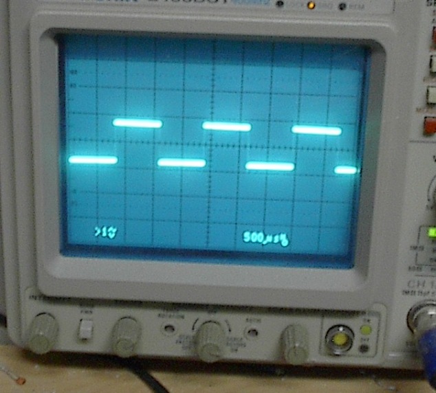

Impressive, looks like perfection on that O'scope 😀

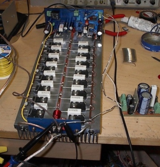

So it looks like your amp has no trouble delivering high power now, but because of the lower supply rails, it looks like you need less than 2 ohms to get 1000W.
I'm pretty sure your amp could drive over 1000W into 1 ohm. A 4 ohm sub then for you should be a nice, easy load on that amp! 😀
IMO an amp that can drive a much lower impedance than the speaker you are using, always sounds better, with more powerful and cleaner sounding bass.
BTW, if your load resistors are smoking, than that's a good sign you built one he11 of an amplifer!!! 😀

Thanks again EW,
The insulation on the lead outs is sizzling, the wire gets that hot. The water itself is getting noticeably warmer, with bubbles forming around the resistors.😀
The fact that it can easily drive such a low impedance is good news, I won't have any concerns at 4 ohms.
I still need to get the LT working and check it's performance. It is a complete duplicate of the one in the original amp, so it should be fine, barring any of my usual missteps.

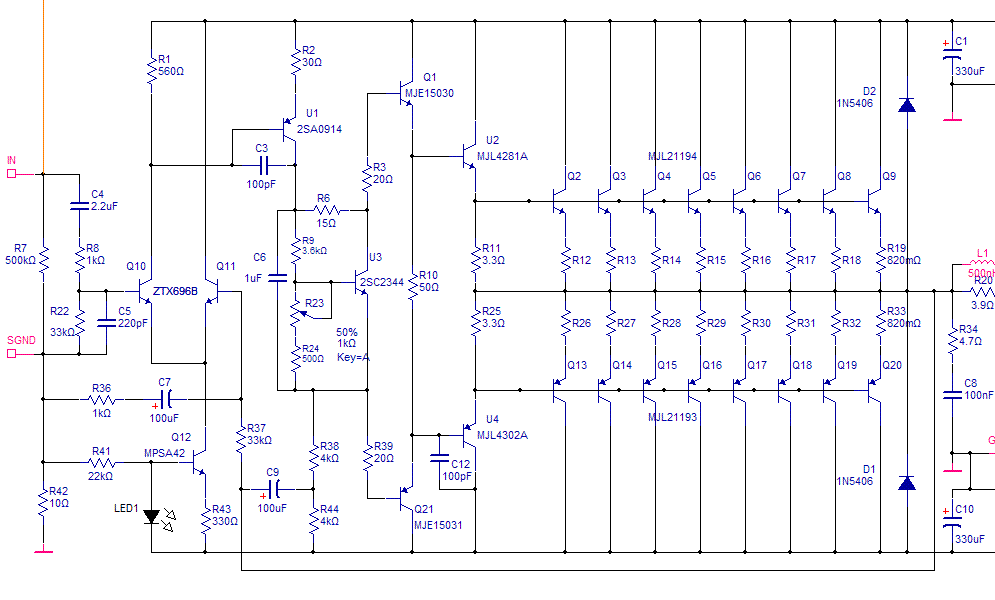

Here's the winning schematic. The only extra compensation component is the 100pF cap on U4. Without this, there was some nonsense in the lower wave during clipping. None of the extra base stoppers were needed.
I increased the bootstrap R's to 4K, as I felt that ~10mA was too hot for the VAS I am using. No ill effects.
Also, I need to move U3 out to the centre of the heatsink, to get better thermal tracking.

Nice job... this looks like multisim. If so could you sent me file, to see how it will simulate it.
One more thing, why so high emitter resistors?

The higher emitter resistors are good to have at higher rail voltages to help balance the current. The current hogging effect gets worse the higher the rail voltage is and the higher thermal resistance to heatsink is.
If the combination of resistors, rail voltage and thermal resistances are wrong then one transistor will take all the current regardless of how well the matching of Vbe:s and thermal resistances were done.
Have a look at the attached LTSpice simulation, try playing with the values of thermal resistances and changing Gm to reflect different emitter resistor values and see when it runs away 🙂
If you multiply effective Gm * Rail voltage * Vbe tempco * thermal resistance you get a number indicating the amplification of mismatch. Vbe tempco = 0.0022V/deg C. When it is 1 there is so much positive feedback that mismatches will get infinite amplification. For 0.5 there will be a gain of 2 for mismatches. This works out to below 0.2 for this amp as the transistors should have very good thermal resistance when mounted directly to the heatsinks.
It might be possible to reduce the resistors a bit, but there isn't really any need I think as there are effectively 16 in parallell driving the loudspeaker. I would worry a bit about the cooling evenness if reducing them though, when using a tunnel like this the transistors furthest from the fan will draw more current.

Thanks Luka,
PM me your email and I'll send the file. Simulated performance is very good, with THD at 0.08 % at full output.

Squarewave @500Hz. A little blurry again.

Examined the output just from the LT on the scope. Output goes from 1Vrms at 120Hz to 4.25Vrms at 20Hz, so gain is pretty much on the money.
Connected to the amp with no load the input of 300mVrms at 20Hz will drive the output to maximum voltage (~49Vrms).

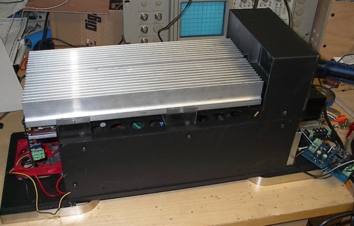

Here's how it looks now. Addition of the small board on the end of the heatsink that holds the output terminal block and the Zobel components. As seen in the pic, I have the supply hardwired to the end of the heatsink.

Looks great! Really good progress here, will be interesting to see how it all fits in the case.
Dr.EM said:Looks great! Really good progress here, will be interesting to see how it all fits in the case.
Thanks Doc,
Tight! That's how it all fit's. 🙂
When we consider that the top half of this large enclosure is taken up with the chimney tubes, I'm not left with much room. Bad enough for space constraints, but running all of the wires back and forth is a bit of a nightmare.
I may have been hasty in thinking I could have a listen tomorrow - there's just too much to do.
One thing I did manage to finish is the mounting for the heatsink. Many trips to Goodwill and other thrift shops has left me with a wide assortment of junk. One of these is a Sharp record player with a cool smoked plexiglas lid. It has some nice 90* corners, so I just cut it into 4 brackets. Screwed these to the aluminum shroud that covers the PS and then to the heatsink. The heatsink shouldn't get hot enough to affect this plastic
Here's it partially assembled. Clearly seen are my brackets, already screwed to the shroud but not to the heatsink yet.

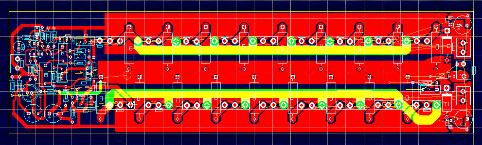

For kicks, and because I got a bit sick of working on the actual amp, I did a full PC board layout for the entire amp circuit, minus the LT. Now that I have it down to a stable design, I thought it might be a worthwhile exercise.
I was able to make it fairly compact too - 255mm x 70mm (10.25 x 2.75 inches).
If I (when I 😉 ) build another one, this is how I'd do it. To wire every thing up like I did, is very tedious.

The most recent high(ish) power amp i have made was the infamous Quasi's ACTRK600 with 94Vdc rails and 110Vdc driver rail, the layout you just posted is not unlike the layout for this amp and it seems to work very well, i think keeping the output stage grouped together is good from a resistive loss and thermal tracking standpoint on the pcb as long as your heatsink is substantial.
to be completely honest the ACTRK600 layout and your layout which you just posted are much easier to work with and practically i have not found any problems.
what program are you using is it protel ?

Hi Dan,
This is one of the things that I will do differently the next time. When nothing about the design is in question, it only makes sense to use a PCB for the whole thing. Especially if it can be kept fairly compact.
I'll be building another one of these within the next year, so I get to try it then. 🙂
