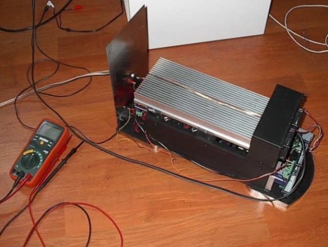

Well...it certainly took a while to find the problem.
I constructed another +/-15V supply to test the LT and found the output was still no good - very distorted. Searched and searched for what could be the possible cause. Solder bridge? No. Loose component? No. Bad opamp? No.
I did some measurements with the power on and hooked up the oscope to look at different places. With the scope, I saw part of the output on the supply! Also on the signal ground. Studied the board, trying to figure out how this could be. Shut the power off and checked the resistance between the signal ground and the main ground - 22K!! This was supposed to be 10 ohms, that would be the value of R42. Look at R42, it looks like a 10 ohm, the bands are correct. Pull it out and measure it - 22K.
Now, that was 10 ohms when I put it in, because I measured it (I measure every resistor). How is it that it changed? The amp won't work properly with this value and it was working fine before.
The resistors used here are ultra cheap ones from Sure Electronics (Ebay). Maybe they weren't such a good deal after all.
Anyway, replaced it wit a known good one from Digikey and everything works A-OK now. I will be giving it a test drive on the sub shortly.

This resistor is for isolation for the signal ground, so it didn't see any excessive current. It's a bit worrisome - I've built quite a few circuits with these resistors. Now I'm wondering what will happen next.
It's connected and operating trouble free. I'm putting it trough it's paces right now..
One thing is that this amp has more gain than the Rod Elliot P68, so I had to readjust the level on my HTR. A tad too high.
Also, I think I need to make an active filter to cut below 20Hz. The LT tries to boost this too much and given the LFE content in some movies, I think it would be a wise move. I just tried "Cloverfield" and there is too much. Those big 18" cones pumping in and out at 8-10Hz is not healthy.

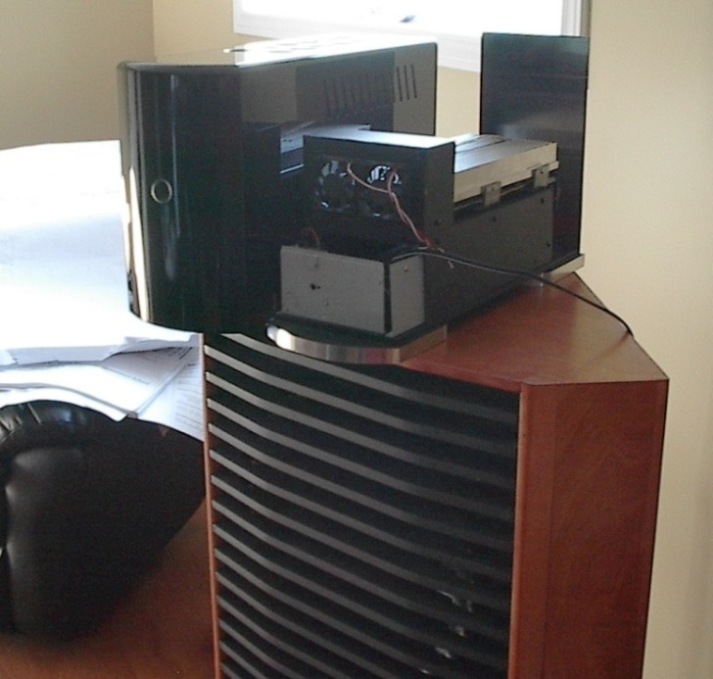

Here it sits on the floor, halfway to the woofer. I have installed the back panel - a piece of stainless steel. Mounted the banana jacks and even cut in the IEC connector. There is still a lot of work left to do before it's complete and in it's case.

The current state of affairs: Works like a charm.
