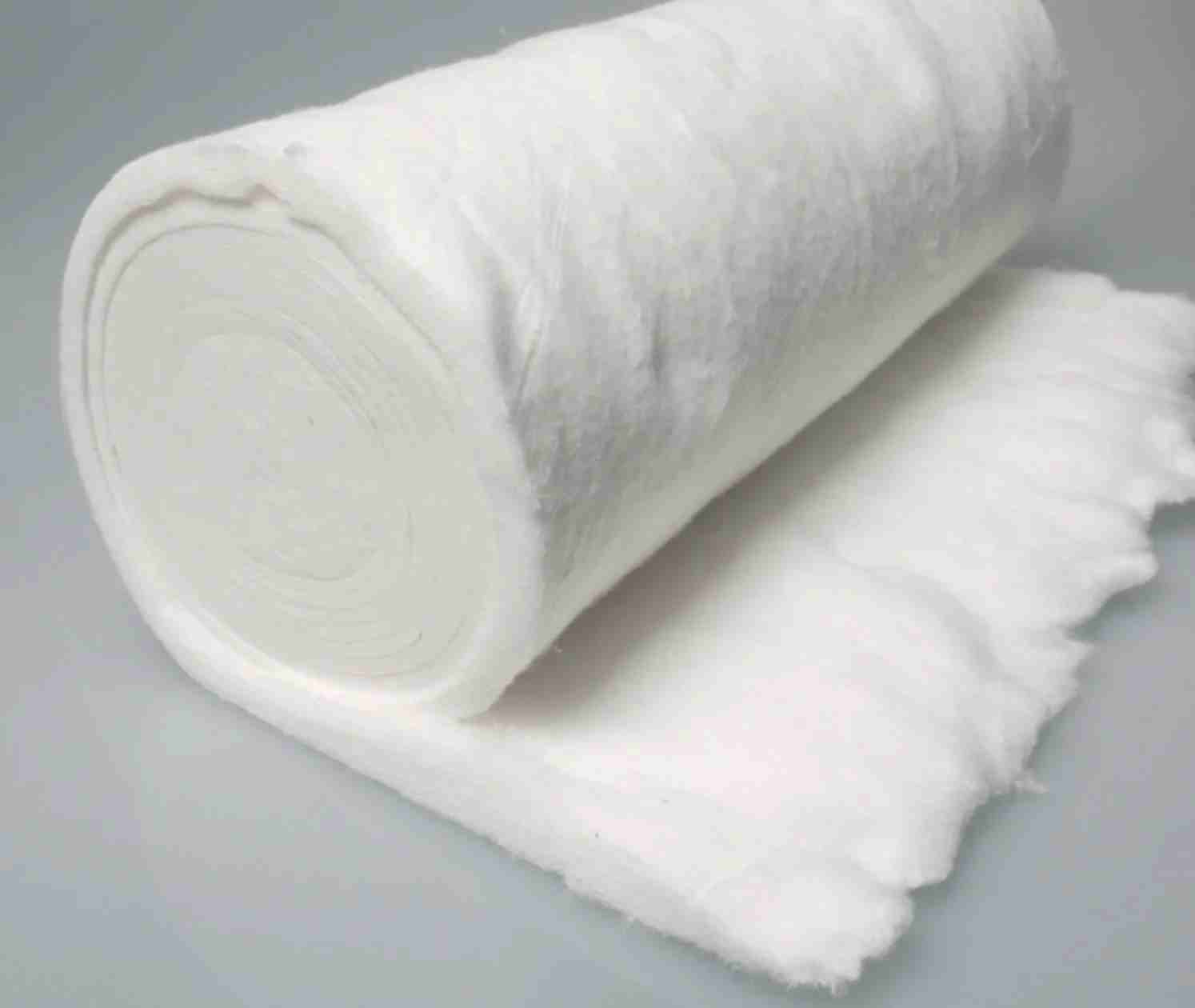

Maybe it's a matter of sourcing? I used most of 2x 100g packs @ about 4zł ($1) a pop from a medical / cosmetics corner shop next to the makeup section.
Oh, do you mean like cotton wool?
I thought you meant the shredded denim based stuff that seemed to be the rage a while back.

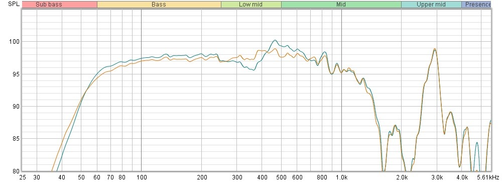

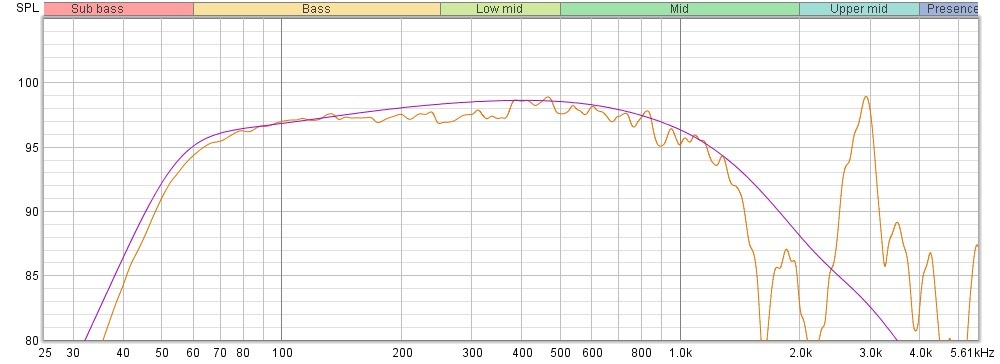

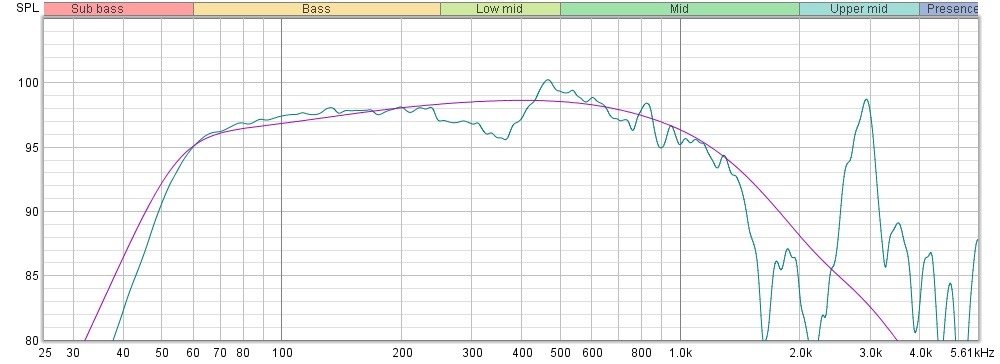

So, I think I have reached a compromise I won't flog myself over.

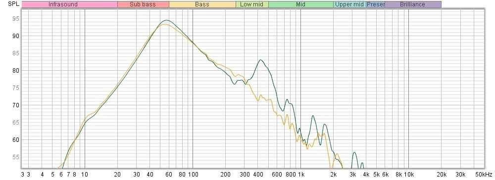

Firstly I removed all damping and dividers and measured. Then I moved the internal divider from infront of vent to behind the driver with some rockwool to damp reflections. It has given a much better alignment response. It matches my original sim which may be what made me throw my toys out the pram.
Green is undamped/undivided cab
Orange is divider behind driver with damping to top and bottom of cab and rear of driver
Undamped/undivided vs sim
Damped/divided vs sim
Still a bit troublesome around 300hz but the datasheet FR does not match mine and I can't find another near field measurement to compare to
Vent measurements

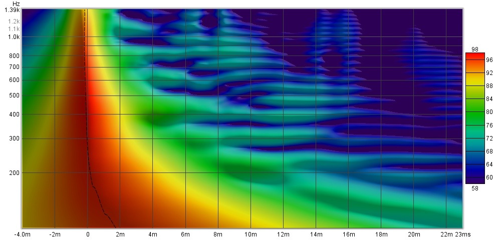

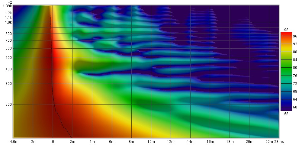

Undamped/undivided spectogram
Damped/divided spectogram

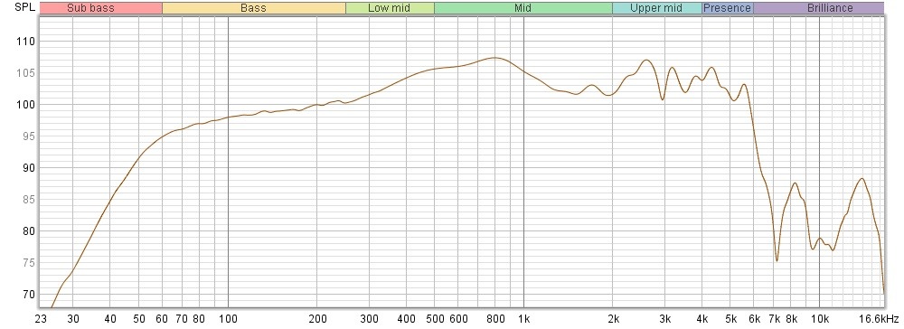

Far field measurement at 90cm/4.3ms gated merged with near field (NF has had baffle step curve applied in Vituix)

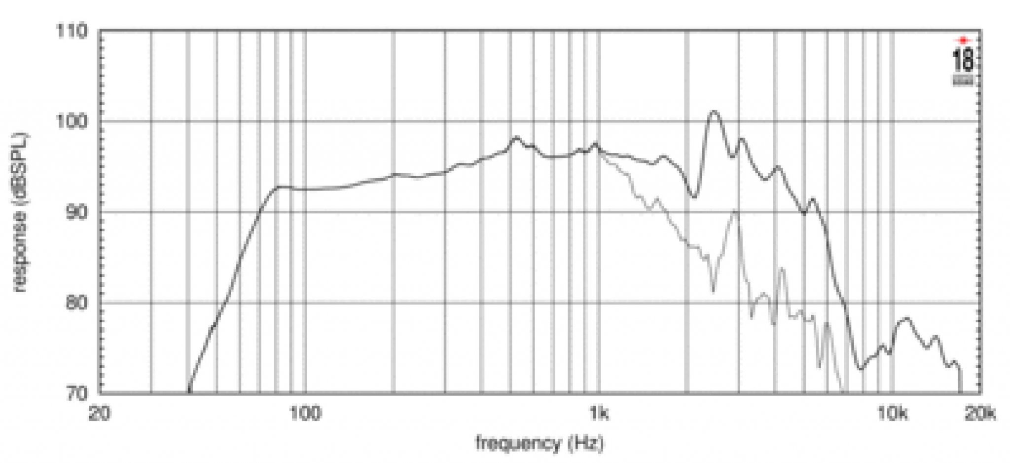

Datasheet FR
What are your thoughts? Could you live with this?

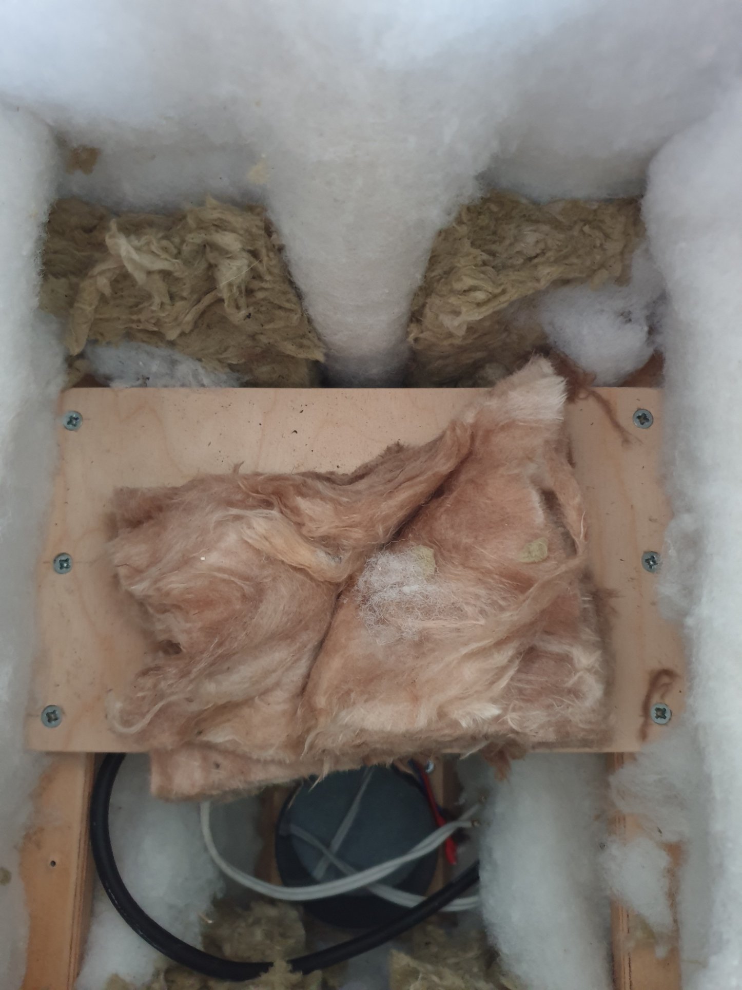

grahamgraham, good results for sure! The problem seems to be gone without much penalty on the low bass, looks like less than the previous setup on post #184. Damping / divider arrangement here seems very effective.

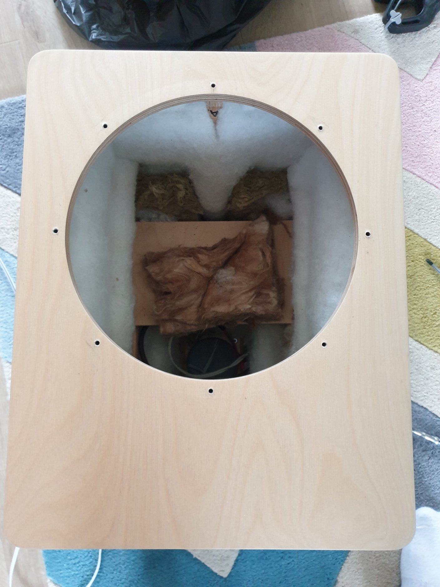

Could you possibly post illustration / photo on the current setup, the divider and damping? I kind of said in my previous post dividers don't work so, would be valuable info perhaps !😀
I suspect this is very common issue with ported two way speakers and think most just don't mind about it, don't measure the finished speaker or don't see it in the measurements, or just don't find it valuable info worthy to publicly post about it.
Did you compare the sound? Was this dramatic improvement or not too much of a difference? I mean the port mid leakage is roughly -10db down in the worst case scenario, without damping. I've observed the leakage can be almost as loud as the Helmholtz resonance itself. edit. here is one, with divider panel and huge mid peak https://www.diyaudio.com/community/...ernal-standing-waves-and-port-leakage.362003/
Here you go, its just under half of the internal height with a gap at the top as to not create a TL path. It is located on the second brace about two thirds in to the cabinet. This is without damping behind the driver, the stapled on bit of earthwool was a failed experiment - it needed more.

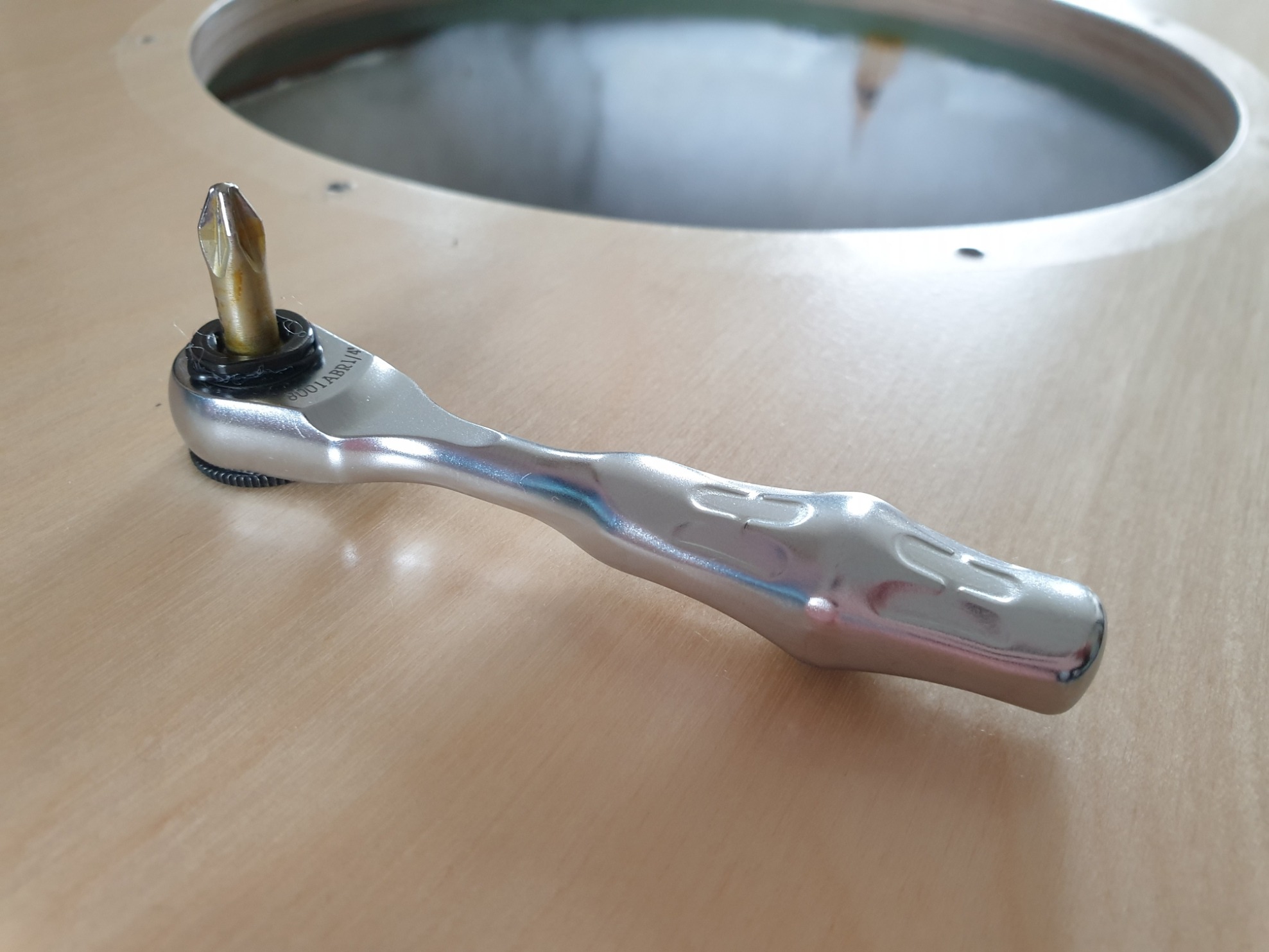

None of it would have been retrofit possible without this darling little beauty:
The diagonal divider makes sense in the mind but from what I have tried and tested you don't need to be as fancy as cattering the waves, just block one whole chunk so there isn't a critical mass gatrhering/

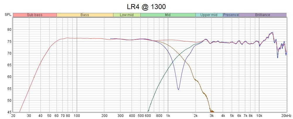

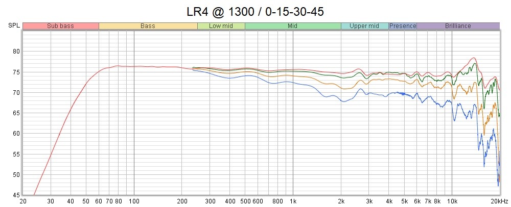

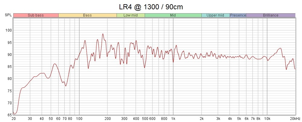

It was a bit of a comedy show today. I got all set up and started measuring then the water company started drilling up the pavement 3 meters in front of my house! Inbetween the racket I managed to put this crossover together:

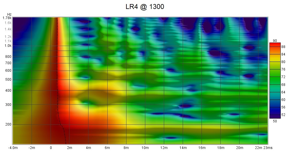

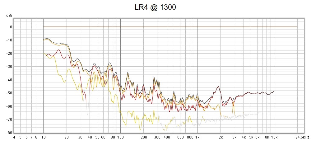

A bit of ringing in thr 400hz region where I had the standing wave.
Distortion was just about 90db. The peak at around 1800hz seems to be common on all HF10AK measurements. Not a bad result but due to the noise today I am sceptical of anything under 400hz tbh.
I have redesigned the crossover for 1khz as woofer is becoming to directional at 2khz and causing an off axis dip. Hopefully this should limbo under that issue. I won't have the front room to myself for at least a week so I have verified the 1khz crossover with a highly gated measurement and it matches sims. It sounds very very good.

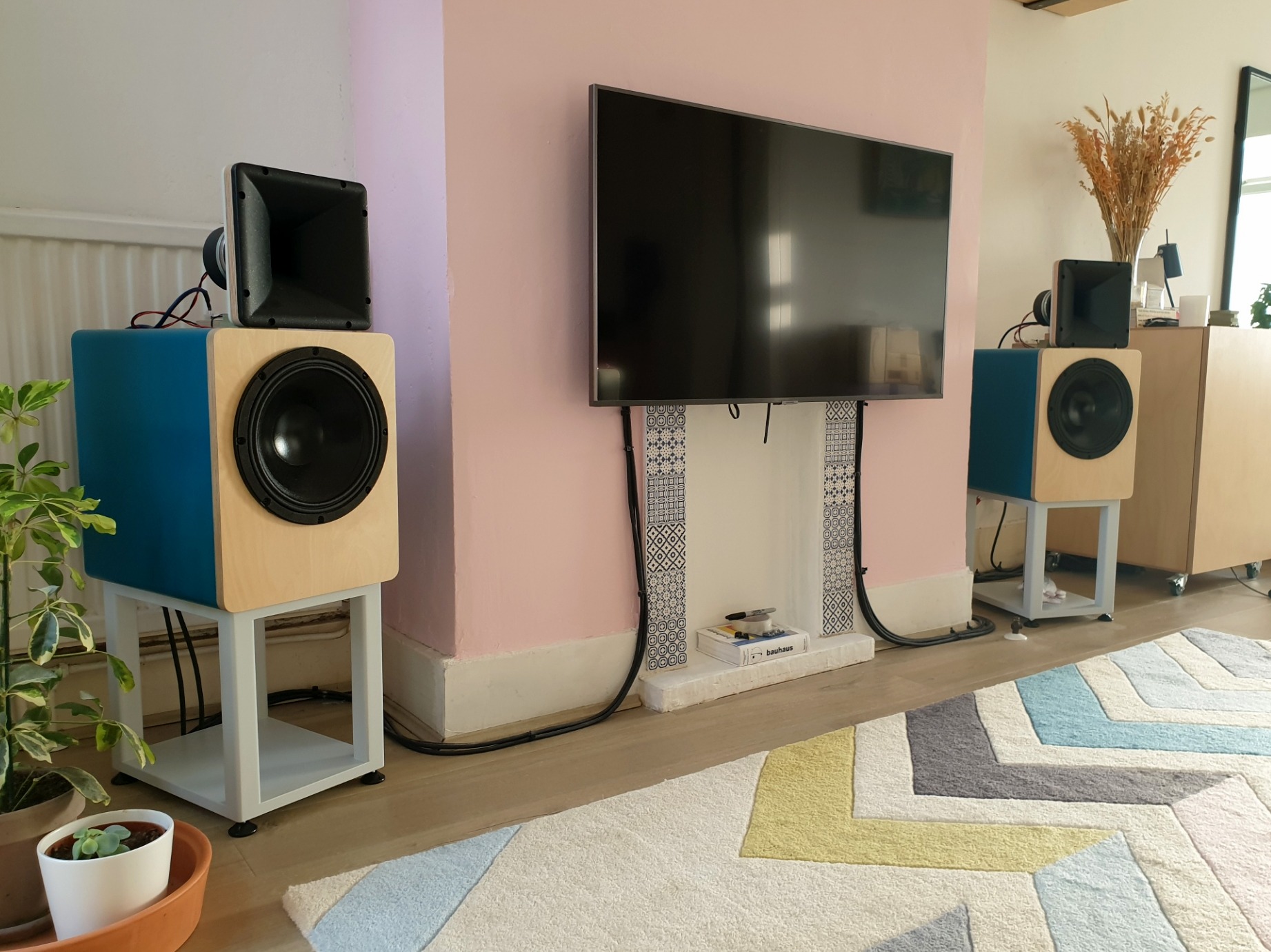

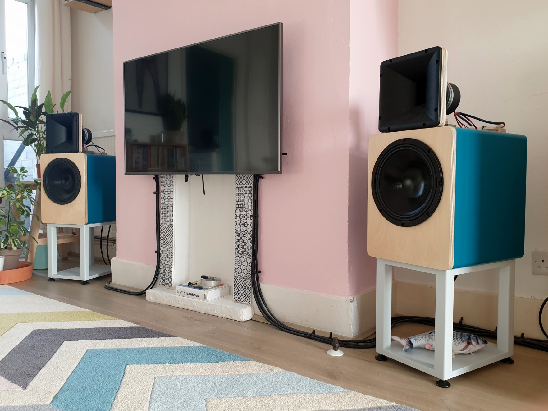

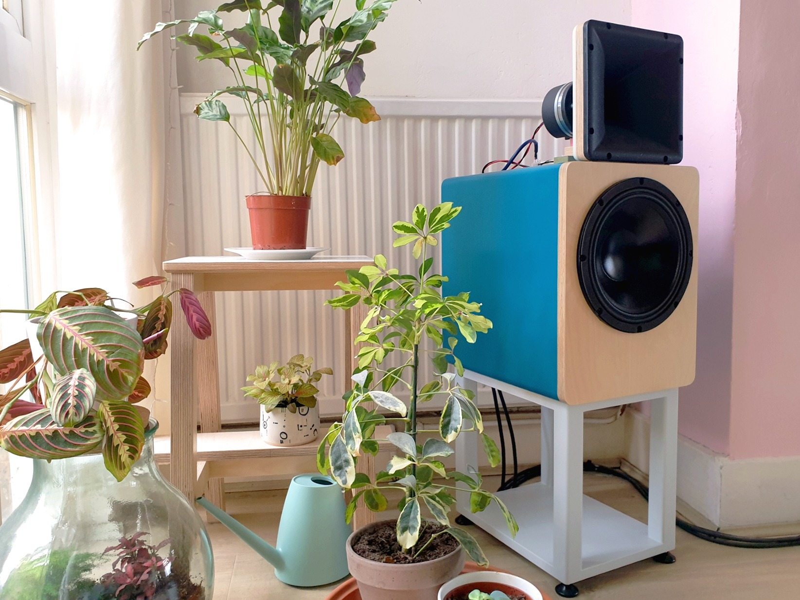

In the meantime the sun briefly came out today and I was able to get some pictures for posterity:

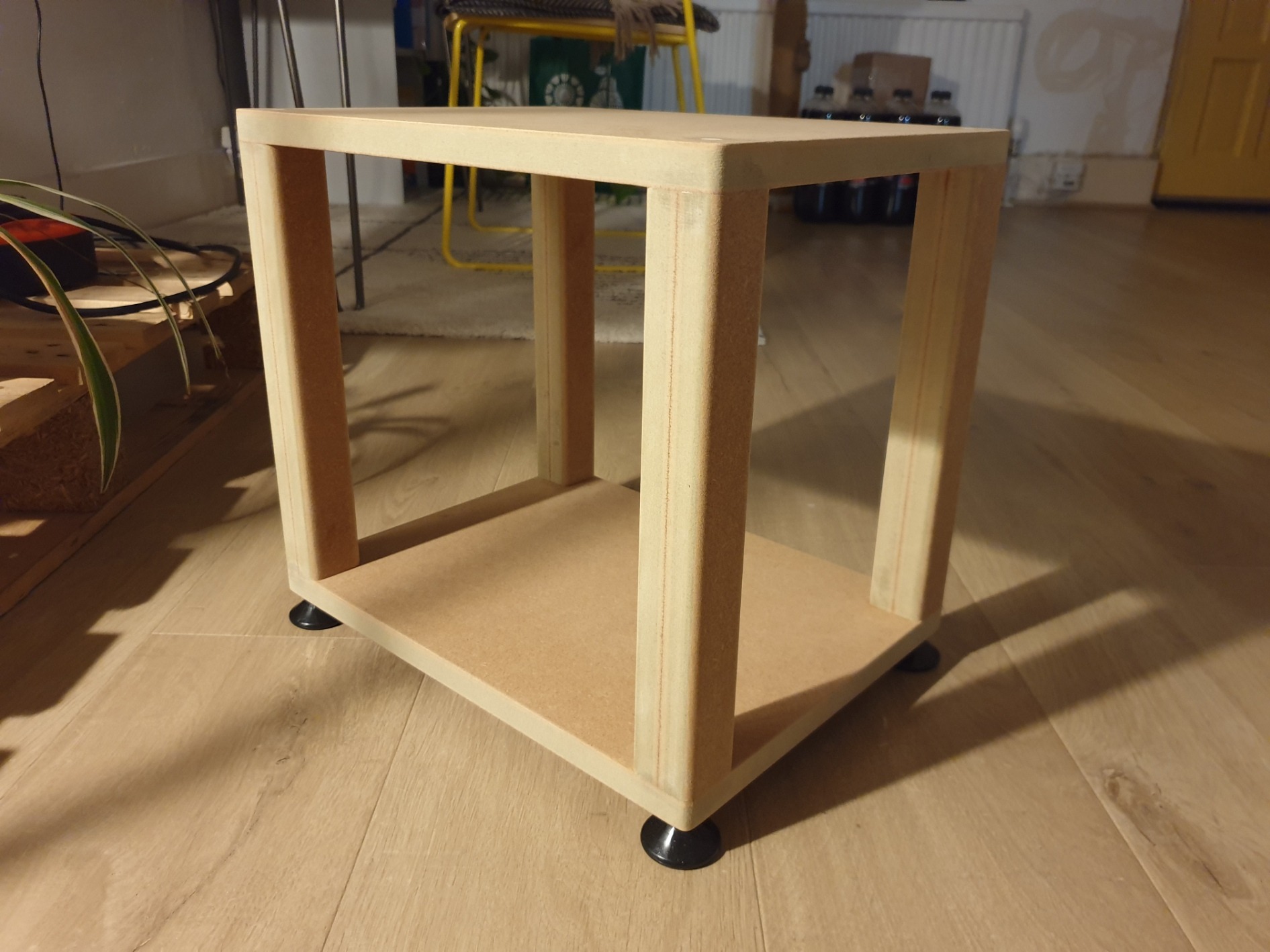

I knocked some stands up earlier this week out of 18mm MRMDF. Not as sturdy as I was expecting but they will do for now and keep me in my wifes good books. I used some tilting adjustable M6 feet and threaded inserts. I still need to make the horn supports.
