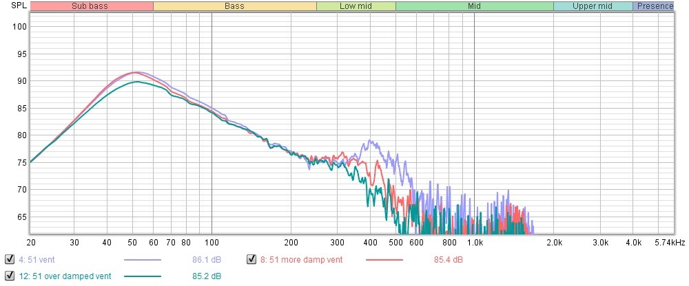

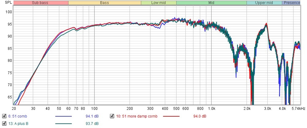

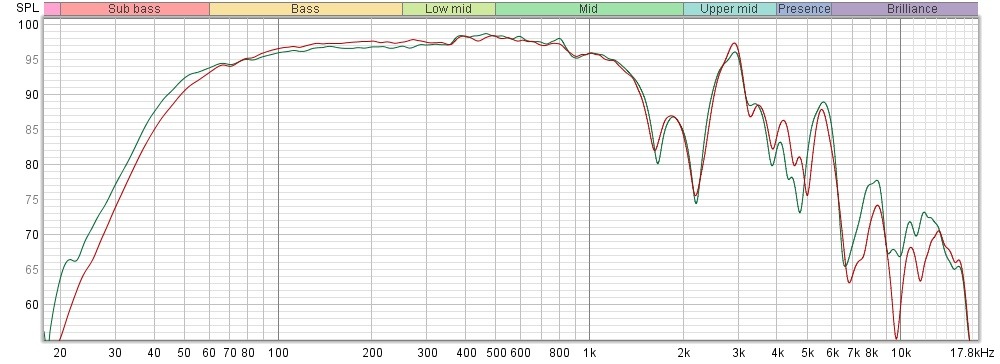

Looks a lot better, no problems at all! How does it sound? Can you overlay the start setting to the latest one? It looks like the bottom (port output) wasn't affected much at all? Nice!
No idea how it sounds as yet! Sure, here are the 3 comparisons - poly batting / rockwool / rockwool and poly batting in middle
To me it looks like the drop in vent ouput could be made up by tuning a little higher.

Frustratingly I feel I have already failed at this project and it's pretty close to being done. That sounds pretty dramatic but it might help me to put this down and get some perspective.
This is the largest speaker cabinet I have made at 30L. Previously the largest vented box I had made was 10L but this, seemingly, came with none of the issues I am having now. Maybe I didn't see them before but trying to make a perfect midbass cabinet to use for a long while has certainly brought them into focus.
Stupidly, I made the box 300x400x400mm. I hadn't expected standing waves as I had never had any I didn't expect before and that couldn't be dealt with by way of a bit of stuffing etc. However, what I didn't account for is the bigger the cab, the lower the standing wave, the harder they are to remedy and ergo, the thicker and more effective the damping needs to be.
So, this 400x400 standing wave showed up bang on time around 400hz. I have finally remedied it but at the cost of the low end extension and that is where I feel this has failed. I wanted the vented alignment to be acoustically on target. As it stands, with the standing wave entirely eliminated, I have lost about 10hz and a couple of db to the low end output. In turn this means I have to correct it with DSP which is what I wanted to avoid doing in the first place. Had I wanted to use DSP on the alignment I wouldn't have built such a large box. Drat.

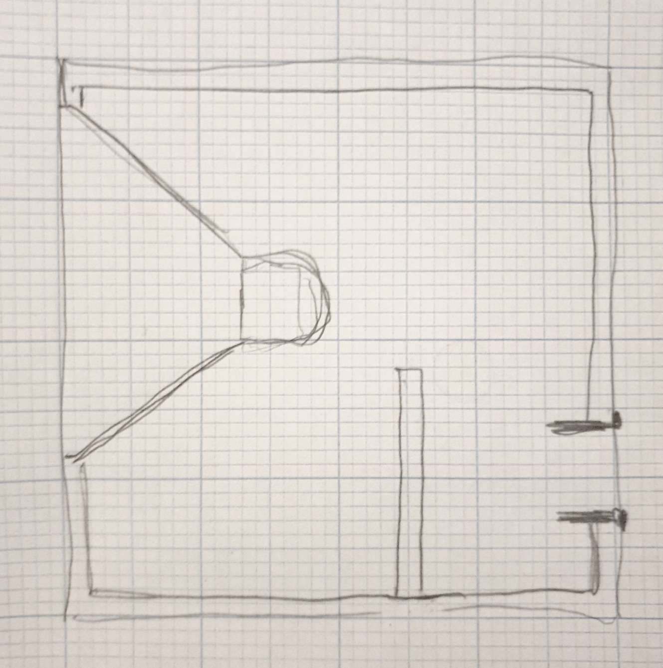

This crude diagram shows what I did to smooth it out but for some box geometry reason has cost the vent output:
This is the measured NF response:

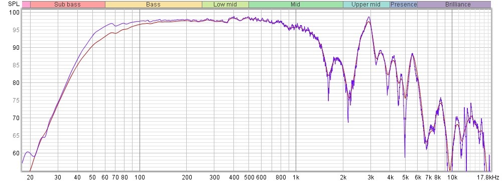

This is the current response vs previously damped response:

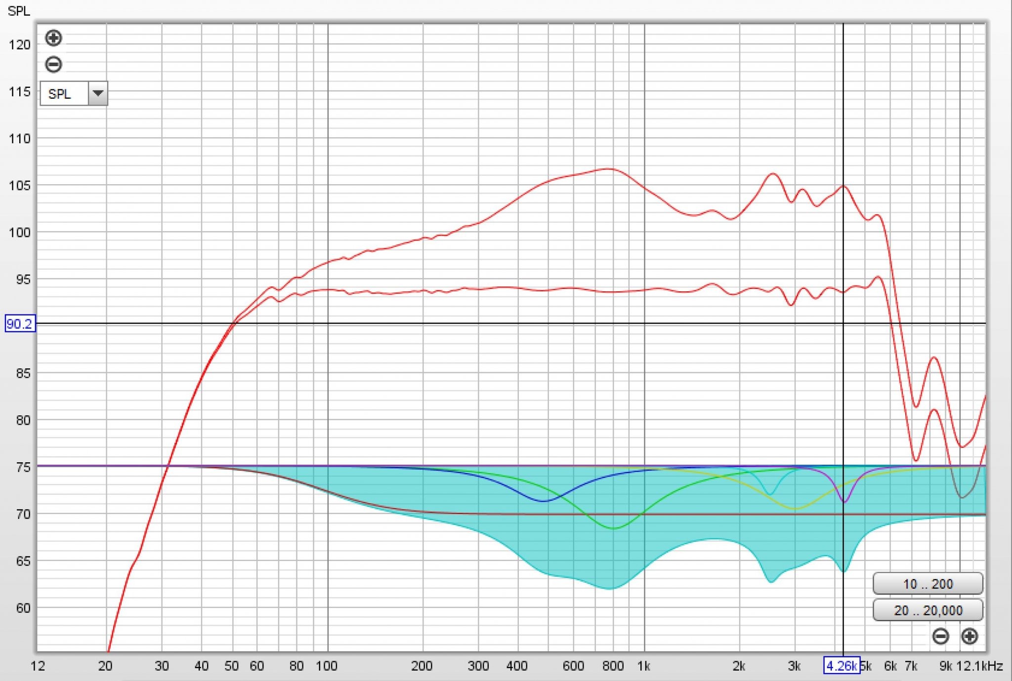

I have three potential angles of attack to this.
1. Eq the BSC to augment the bass:
2. EQ the bass end with a 3db parametric:
3. Get a grip my son.
So the bigger the box the bigger the damping material simply means your damping should be a fraction of the box dimensions. Therefore it's not like there is an actual problem.the lower the standing wave, the harder they are to remedy and ergo, the thicker and more effective the damping needs to be.
Actually, it could be said that the proximity of your standing wave frequency to your box resonance frequency happens to be a factor, and that is completely coincidental.
In any case, compromising the standing wave situation to ensure proper reflex action isn't always the best choice 😉
May I suggest you decide on the overall response you want. The way you go about achieving that ought to be less of the point, until you've made that decision. In other words, if the way you go about it gives you different results (and not saying they should but sometimes it happens), then it's those results which tell you what you'll get.I have three potential angles of attack to this.

When you do your initial development for fixing the standing waves, ie determine the needed damping material, you shouldn't let the concern about damping the reflex resonance interfere with the answer you get. It's only after this that you have to put the compromise into place.Would you mind elabourating on this a touch, pelase?
Up to a point the standing waves will be more of a priority than the reflex resonance, due to the nature of them as an issue and their higher frequency etc.. You'll have to determine that point and accept what you get in the bass. I don't think this is a reason to avoid larger enclosures.
Simulators these days allow you to sim a reflex box with lots of damping which I think is a better idea than the old rule of thumb to try and avoid damping.

Can you show us the impact of the standing wave pre vs. after dampening?
It looks to me like you changed the tuning frequency by whatever you did, if you were to lower the tuning frequency you might get back to what you wanted. Damping affects the apparent enclosure volume which if you keep the port the same length will change the tuning.
I would not be too bothered about the difference between the above graphs as below a few hundred Hz the room will be in control and the speaker is along for the ride. EQ'ing the in room response will have a lot more impact than the difference between those two curves will.
