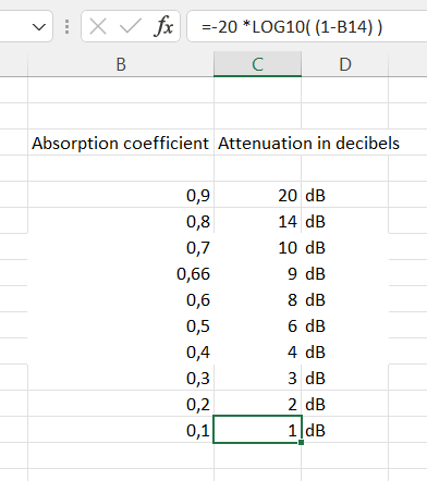

So the bigger the box the bigger the damping material simply means your damping should be a fraction of the box dimensions. Therefore it's not like there is an actual problem.

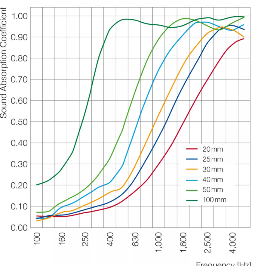

Small expansion to this: damping materials don't have equal attenuation on all frequencies. While most materials are very effective around 1kHz even as thin layer there can be significant differences lower in frequency and big enough boxes this needs to be taken account.
While the increasing thickness of material, for bigger box, increases attenuation on lower frequencies some materials might still not have enough attenuation. Basotect absorption coefficients attached to illustrate some coefficients, grabbed from here https://plastics-rubber.basf.com/global/en/performance_polymers/products/basotect.html
ps. while the absorption depends on many things including air space between the material and wall, the absorption coefficients give a hint how the material performs at low frequencies.
