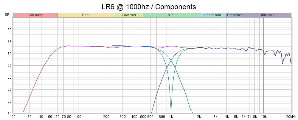

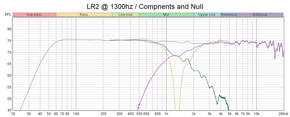

Here we have crossover mkiii (mkii was 24db at 1k) which is a 36db LR at 1khz.
What is both interesting and annoying is that dip at 2k from the previous 1.3k crossover has not gone away. Both the woofer and the tweeter both narrow around this area so, I think no matter where I plonk the crossover I will get a dip at or around 2k. The question is if it is better than mkii (https://www.diyaudio.com/community/threads/10-cd-horn-2-way.375829/post-6935423)? Probably not much in it between the two.

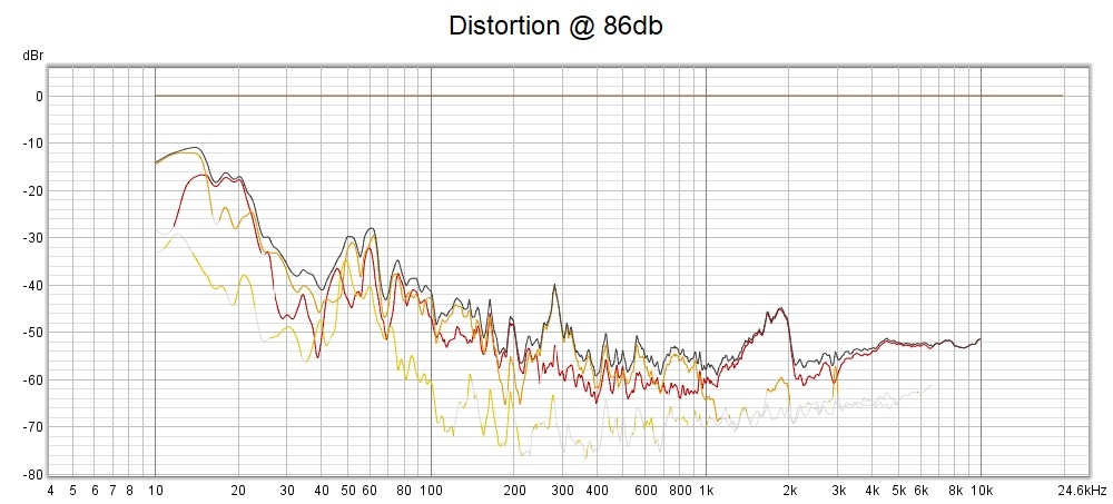

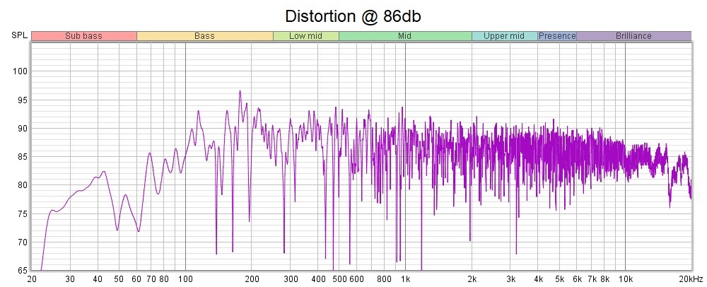

Distortion at 86db:

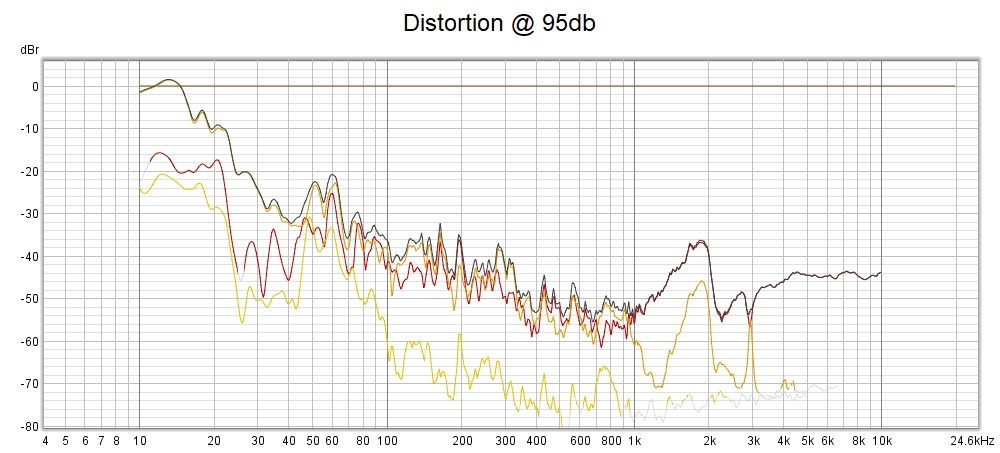

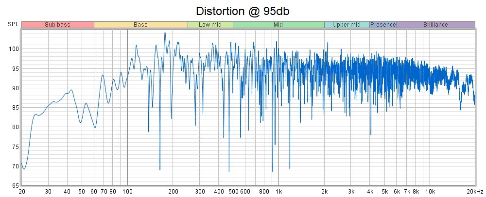

Distortion at an neighbour-rousing 95db:
Clearly the system is being pushed here but what I thought was interesting was the ramp and peak of the tweeter at/around 1000-2000hz. Clearly if this driver was to be pushed it needs a higher crossover.

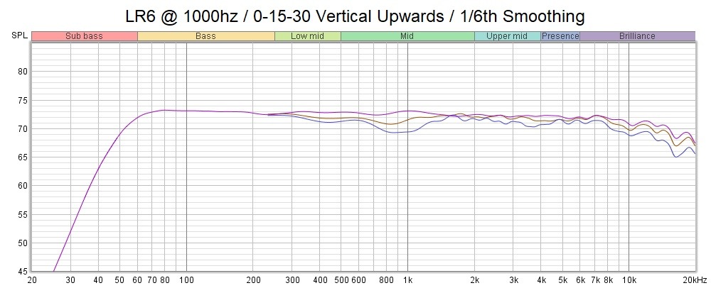

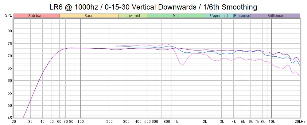

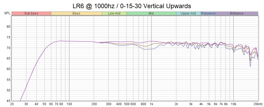

I tried to do some vertical polars but they became unreliable outside of 30 degrees. 1/6th smoothing but we get the idea. Luckily the listening position is only around a +/- 5 degree window from on vertical axis. However my knees get a very poor show.

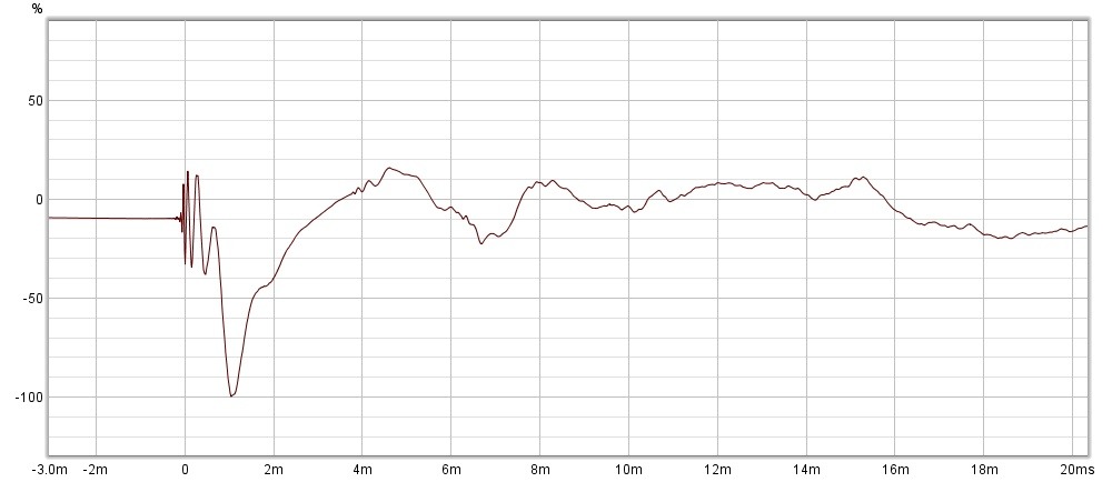

Unwindowed step response:

What I am finding particularly interestnig to think about at the moment is trade-offs. Most specifically what tmuikku has talked about in avoiding the limitations. The old cliche we read here a lot about iron-laws and every speaker being a compromise rings true. Defiantly trying to make the perfect speaker out of a two way is tough unless you have a stockpile of beryllium.
To avoid the poor downwardly vertical polars I would need to add a mid.
To avoid poor directivity matching I would need to add a mid.
To avoid floor bounce I would need to lower the woofer and add a mid (or have the speakers on the floor)
To avoid distortion in the tweeter I would need to add a mid.
OR
Is it co-ax time?
You could measure the vertical response laying the speaker on its side, rotating it horizontally. Feed the data into VituixCAD and see the DI and power graphs as well as how the polar response looks like, early reflections and their DI is also available.
Horizontal polars are pretty good I suspect but the vertical might contribute to the sound depending your listening distance, speaker and room height for example, and the xo, c-c.
There's Kimmo's rule of thumb for optimizing power response with vertical c-c of 1-1.2x wavelength at xo frequency, or vice-versa. As I understand right now this is for LR4 and time aligned sources with wide radiation at xo frequency.
https://www.audiosciencereview.com/...-on-the-vertical-radiation.23239/#post-775837http://www.htguide.com/forum/showthread.php?44128-VituixCAD-v2&p=639178&viewfull=1#post639178
Based on this, you'd time align the drivers and go with a LR4 xo frequency that has 1-1.2x wavelength of the c-c of cone and horn. I guess this would be around 1kHz. The horn wil be wide there which as I understand aligns with the rules. But I'm trying to catch up on this myself, can't say I have firm grasp. Wide sources can be simmed easily in VituixCAD with the default drivers.
Yeah, basically there is no way to make the vertical polars perfect with so short wavelengths and non coincident drivers. Above some hundred hertz, solely due to driver frames, SPL requirements and other stuff. MEH would allow close enough spacing for point source summation, coaxial, woofer with fullrange system. Two way with waveguide tweeter won't ever get into 1/4wl c-c so the next question is what the c-c should be then. Basically there is possibility to point the lobes somewhere playing with the c-c and while there is not too much data on this I believe, blind listening tests, I'd speculate similar sound of the first reflections to direct sound would help them integrate better with the direct sound in the hearing system. But this is just speculation since I do not have sufficient background on hearing systems, or not too much experience on loudspeakers for that matter 😀 Anyway, a possibility to tune the system and affect its sound, tool in the tool box.

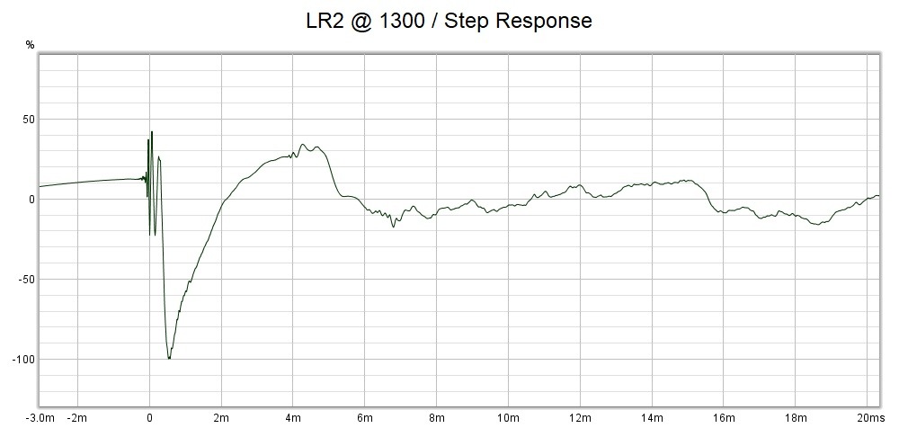

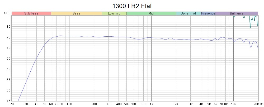

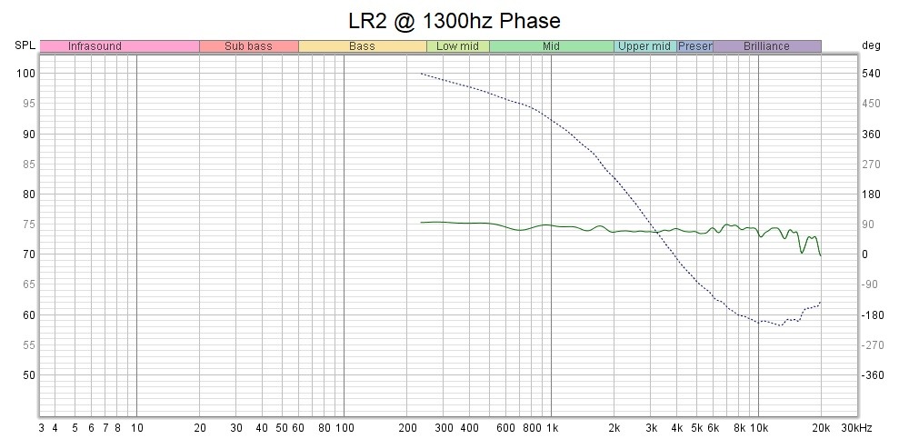

I think I may have settled on a filter set up with an LR2 @ 1300hz. It doesn't look as pretty as the previous but it does control the distortion peak from the HF10AK just below 2k a bit better. At 86db is is safely under -50db THD until a suspicous looking spike at 290hz.
There doesn't seem to be any compromise that fills in the off peak dip around 2k but I will have to live with this. Both the woofer and the horn seem to naturally recess here so whichever way you have it (higher or lower crossover) there will be a trough.
The step response isn't what I expected. I have a 0.14 millisecond delay on the woofer to get the null to deepen to the max. I guess the drivers aren't time aligned but are in phase at crossover. Looks more like an LR4 step response.
Speech does come through cleaner, I feel, which is important as these are for everything from watching the news to bangboomcrash movies to late night quiet music sessions.
I do not understand why your step response has this wiggles where the signal starts. Is the woofer interfering with the compression driver/playing to early?
Apart from that I predict with this tuning you will find yourself bringing down the treble after a while. The off axis shows quite a bit of lost energy around 2k, the problem with small waveguides. The presence band could be standing out just a bit too much.
If the problem cannot be solved both on-axis and off-axis, due to the smallish waveguide, you might find yourself choosing between applying EQ to control treble or trading some on-axis linearity at the first hand for a more balanced tuning. This of course is easier to visualize with a set of angled measurements both vertical and horizontal.
