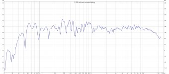

Here's a couple of measurements.
The first measurement is an 18Sound XT1086 with a Celestion CDX1-1445 and no baffle whatsoever.
The second measurement is the same waveguide witha BMS 4552 and a big fat roundover on the baffle : 4.5" on each side!
From what I can see, the use of five dollars worth of PVC pipe to create a roundover is making a bigger difference that using a $200 compression driver. For $45, the Celestion performs quite well, the main issue with the first measurement is the dip at 2500hz and the peak at 1800hz. It's true that both can be "EQ'd" away, but the PVC pipe fixes things elegantly.
More importanly, and the big "x factor" is whether the diffraction produced off of the baffle edge in measurement one is audible.
Personally, I'm inclined to say "yes."

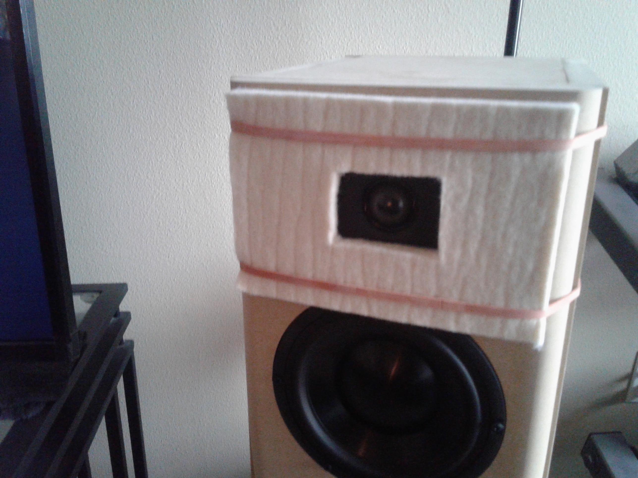

I know i don't shut up about it but get foam or felt around the behringers baffle to catch those reflections.
Norman

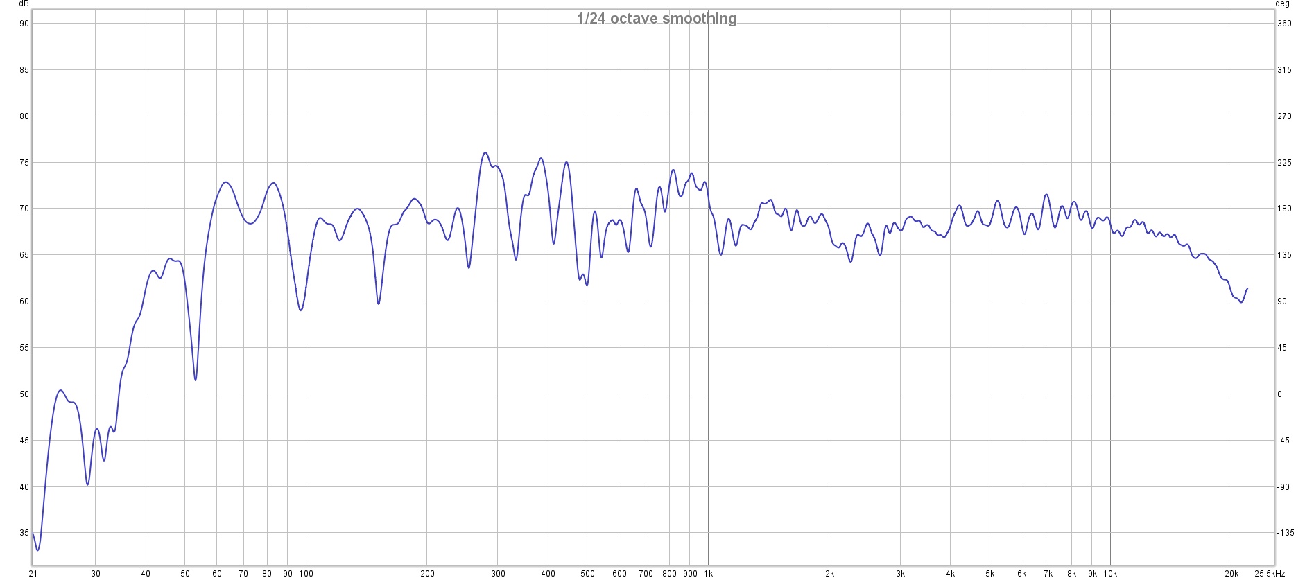

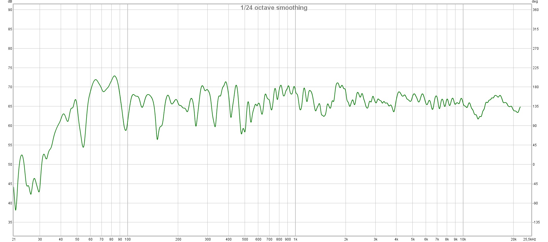

I have the Behringer Truth B2030A and JBL LSR306P MKII neck to neck here. Great for the price but quite far from being great speakers IMO.
Based on what I've measured so far, there doesn't seem to be anything revolutionary about JBLs image control wave guide. But the wave guide looks really trick, which very well may be why JBL chose it.
Below are on-axis measurements of both in sweetspot at a distance of approximately 2 m. They are placed directly on front of a large speaker with much distance to front wall, hence part of the reason for the low level in the bass.
JBL LSR306P MKII:
Behringer Truth B2030A:
