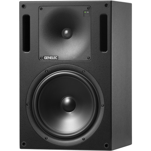

Check out smooth waveguide domes in monitors.
All those slots and sharp changes of direction in the throat and walls of a horn/waveguide are placed there to direct the flow of air (fluid) and the sound that goes along with the flow.
Horn/waveguide theory would have us believe that smooth spherical sound waves travel the length of the horn. I would like to believe that. This might be true if the fluid flow was always laminar. Due to friction at the horn/waveguide walls the fluid flow may become turbulent. Diffraction edges also cause turbulence.
Turbulence is is not going to happen in a horn or waveguide because the "flow" is too small. The only place that turbulence is a factor is in woofer ports. And the friction at the walls should be negligible. The sound waves are never perfectly spherical in any device, but they are more so in some devices than others. Sharp edges create diffraction and the less diffraction there is the closer the waves are to spherical.
It is my impression that turbulence caused eddy flow is the stuff of HOM’s.
