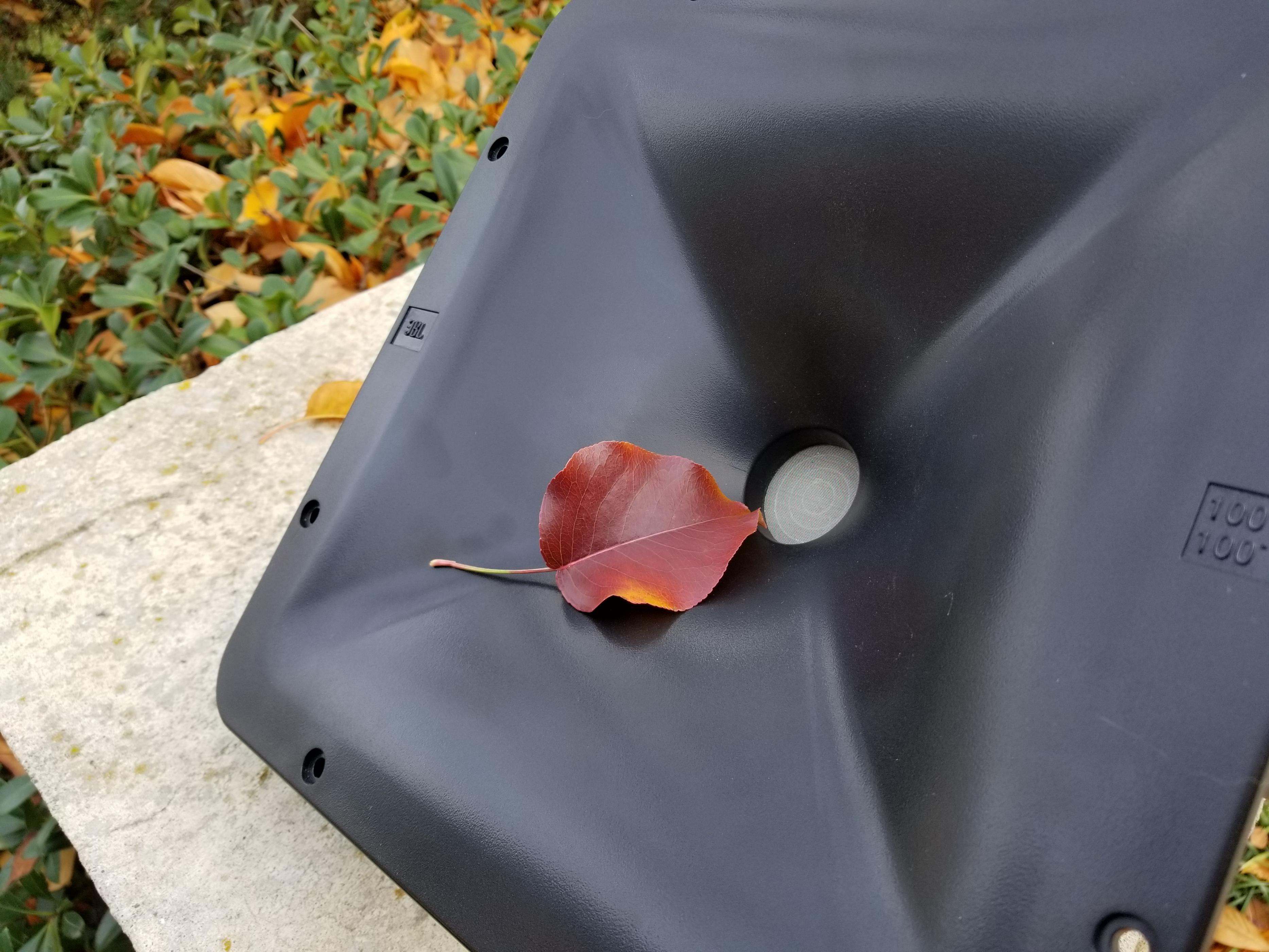

Can you post pics of the newest pt waveguide ? Especialy slightly off axis ? Is it quite flat ? It looks like not much break from horn wall to baffle lip.

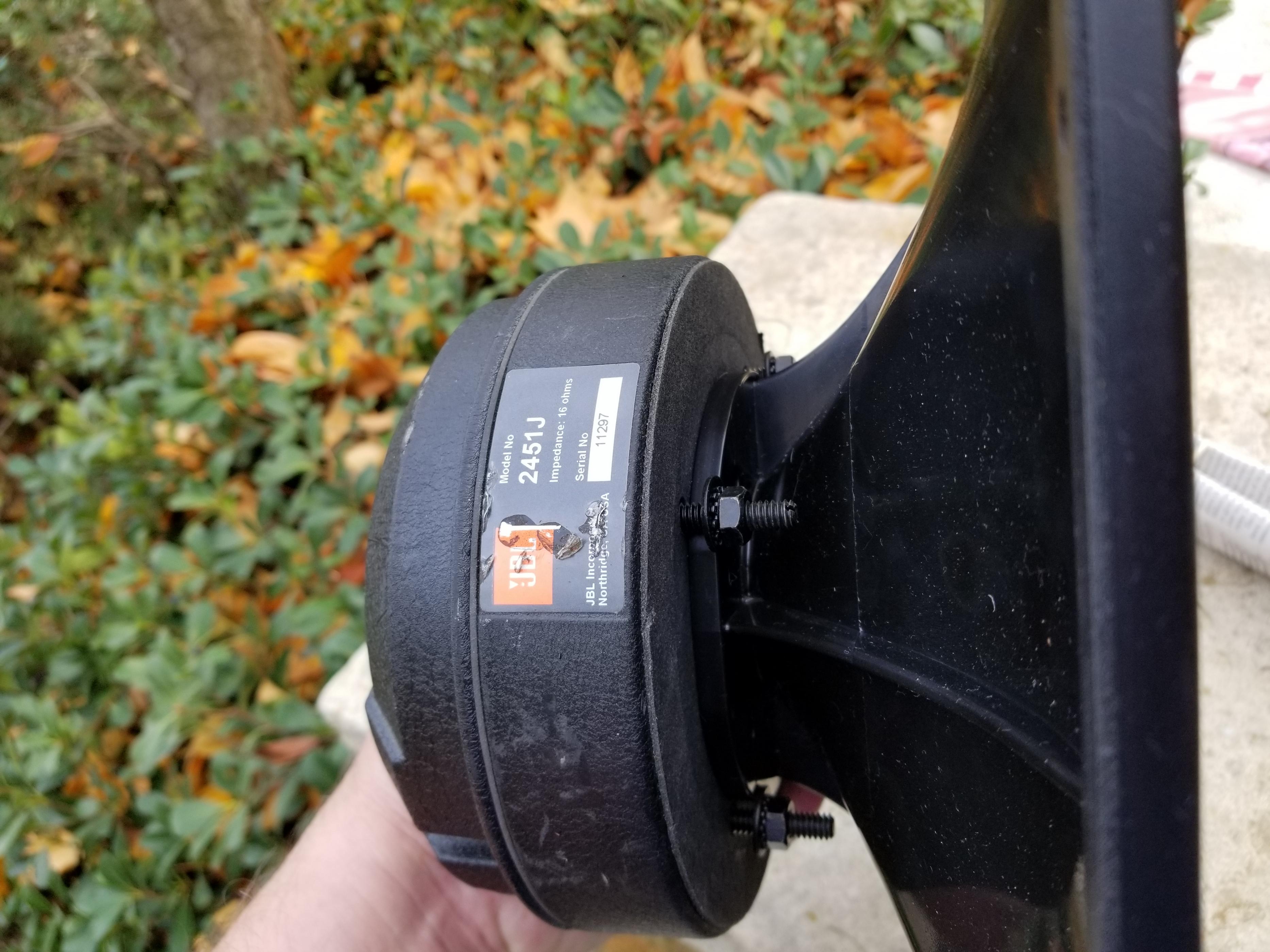

The snout of the JBL 2451 is short compared to others including the 2450. The shortening of the driver snout happened with the transition from 2 inch to 1 ½ inch throats, “distortion reduction” and the shift away the older 2 inch bi-radial horns.
Over on the other site other people have placed a ½ inch spacer between the JBL 2451 driver and the PT waveguides and smoothed the frequency response curves.
The PT H1010HF-1 bolt circle does not fit the bolt circle of the JBL 2351. The flange just fits inside the JBL 2451 bolt circle. You can see in the pic that nuts and washers sandwich the waveguide to the driver.

Okay 10-20K is not so critical, apparently doing a lot of stuff in the 1 ½ inch throat is not so critical to the listening experience either. Take a look at the M2 spins, Constant Dispersion takes a hike above 8-10K here too.

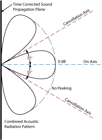

For optimized controlled dispersion we want to crossover from the woofer to the CD waveguide as low as possible. The GedLee approach is to crossover in the neighborhood of 600Hz, any lower the cost starts to increase rapidly. Also from my vantage the size of the waveguide begins to fill my “small space”.
Many of the smaller waveguides posted here crossover in the 1.5 to 2K range. For example the PT H1010HF-1 is 12 inches square and fits into my interior design plans much better.
Keeping an eye on directivity, looking at the overall dispersion of the speaker including the overlapping desperation patterns of the individual drivers at the crossover frequency, even with an optimized crossover there will be lobing or narrowing of the vertical directivity. The extent of the lobing will depend on the crossover frequency and the distance between the driver centers. Look at the attached figure taken from RaneNote 160.
Linkwitz-Riley Crossovers: A Primer
In my “small space”, sitting in the sweet spot how will the lobing at the crossover frequency effect sound perception? Or will it even have a perceptible effect?

This vertical lobing is a necessary evil. It would of course be better not to have it, but the tradeoffs in getting rid of it are not worth it IMO. The lobes happen over a fairly narrow range of frequencies and drop the power response a bit, but I can't say that I have ever noticed them as a significantly bad effect.
Its certainly a reason that I try and minimize the number of crossovers as each one will have this problem.
It would be a very hard thing to test!
I am planning on slot loading my midbases so that using digital delay I can get it within 1/4 wavelength and avoid vertical lobing without having to use a synergy horn. As the slot acts as an acoustic low pass the horn has to go low and the whole thing will need a lot of EQ.
