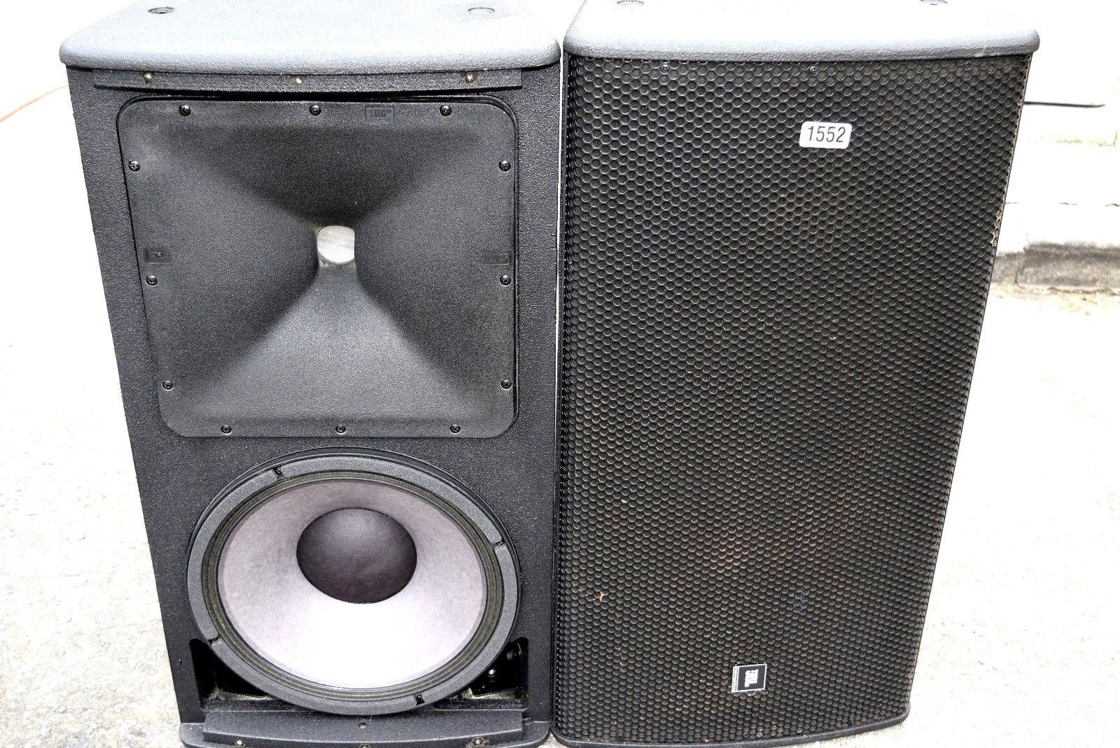

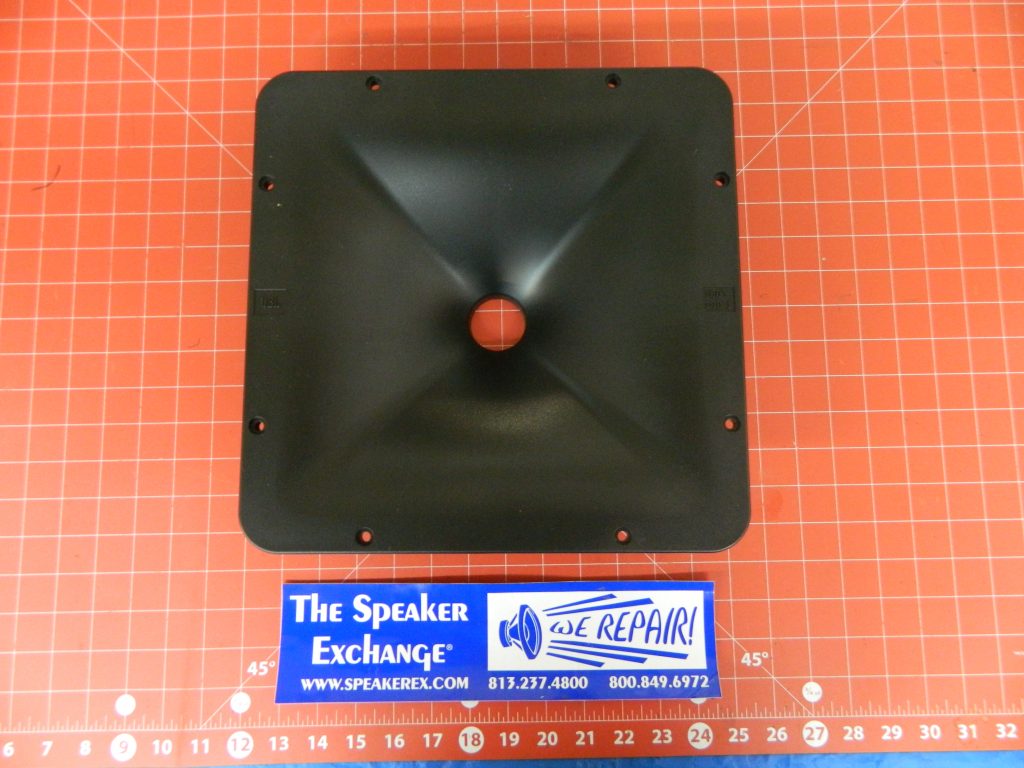

The jbl 100 x 100 pt waveguides close to oblate spheroid ?
I ask because I am waffling between both waveguides and 2431 and 2432 compression drivers...................
The older horn on the right does look more OS except for the bubble in the horizontal throat dimension.
Then again the horn on the left may be rounded throat / conical.
The JBL PT waveguide that's in the Econowave - it's very close to oblate spheroidal. There's a roundover at the throat and at the mouth.
Where it diverges is that an OS waveguide has a straight line that connects the two sections, and the PT waveguide in the Econowave has a spline.
Here's a measurement of the JBL ring radiator 2408H-2 on that waveguide. This is about as good as it gets.
Two of my current speakers are with this JBL PT-Waveguide + JBL 2450SL driver. The horns were originally JBL 2332 bi-radial. PT-Waveguide is the exact same mouth size as 2332, so I could have compared them directly in the same system.
PT-Waveguide requires a bit less EQ for flat response, and soundwise, it is more disappearing (like modern B&W). Technically speaking, PT-Waveguide is better than this conventional bi-radial horn, but I believe many audiophiles here actually would prefer the sound of old horn, not only because PT-Waveguide is very ugly. Conventional Bi Radial horn actually sounds more natural in different ways in my opinion, so I would recommend to check them yourself to see which you would prefer. I still own 2332, and I sometimes feel I want to go back to 2332.

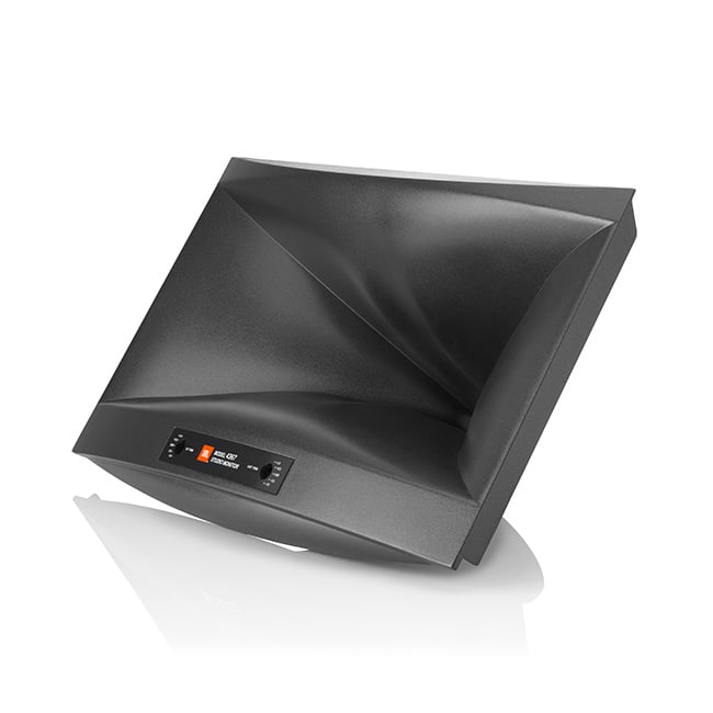

IMHO, JBL's "Image Control Waveguide" is simply a new twist on an old concept: a diffraction horn.
In the SCL-2, it makes a lot of sense: the use of a diffraction slot allows for a loudspeaker that's shallow with a wide horizontal beamwidth. Very useful for a speaker that can't be aimed. (Since it's in-wall.)
But if you don't have a engineering reason to use a diffraction slot, it's hard to justify the ICW.
Having said that, I'm using diffraction slots in nearly all of my waveguides lately, because they're such a problem solver. I like how 18Sound does it in the XT1086.
