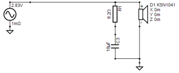

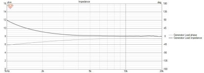

Impedance curve of classic Motorola KSN1041
From about 2k be little different than usual , 600 ohms to around 50 ohms
Drop in 8 ohm Zobel around 10 to 18uf to start curve around 2k
Bing...Straight line 8 ohms
Drop in 3rd order 5k crossover
Of course the FRD comes from old Motorola Datasheet
with gracious amounts of smoothing. But that is basic 5k super tweet
Impedance data is important if you add padding, the Zobel needs
fine tuning. All rather simple.
You just cant use conventional crossovers without Zobel
no transformer needed.
