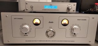

The Nick Sukhov BB-XXI amplifier with a power of 2x150 W has a patented [ https://photos.app.goo.gl/wGfoEdXYJg6ypRGQ8 ] improved output stage in the new ABBA class, which, thanks to effective Gm doubling compensation, provides nonlinear distortion 30 times less than the usual AB class. The hardware costs for these improvements are simply negligible - in my case, this is just a couple of additional low-power constant resistors. The input stage is implemented on the MUSES03 op amp, DC servo on the OPA192 e-Trim op amp provides DC zero at the output with an error of no more than +- 25 microvolts without the need for any tuning operations, and there is not a single coupling capacitor in the circuit, - all connections from the input to the output are organized on direct current. The push-pull output stage operates in the ABBA class mode on ThermalTrak transistors and provides ultra-precise and quick thermal stabilization of the initial collector current within +- 3% when heated in the temperature range from 20 to 100 Celsius. The volume control is organized on the MUSES72323 chip and the ESP32 DEVKIT V1 IoT module, which also provides control from the encoder, IR remote control and smartphone. A detailed description of the circuit, PCB gerbers, BOM and datasheets of Nick Sukhov BB-XXI amplifier are here [ https://www.patreon.com/posts/umzch-vv-xxi-v-81828557 ]. A short trailer is here [
], the lab test procedures is here [
]. 1NickSukhov_AMP_BB-XXI_PCBbottom.png2NickSukhov_AMP_BB-XXI_PCBtop.png3NickSukhov_AMP_BB-XXI_withPS.png4NickSukhov_AMP_BB-XXI_LabTesting.jpg5NickSukhov_AMP.jpg
