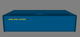

I've been working on a case design using Protocase's software.
All the measurements and fastners are metric. Case is glossy powdercoat heavy gauge galvanneal steel (1.98mm/14 gauge). PEM standoffs are 8mm, screws are M3.
Price for a single unit is just a little more than a DL-103R. The price gets more reasonable in the 3~5 unit range. Here is the Protocase Designer file:
View attachment salas_ufsp_case.zip
