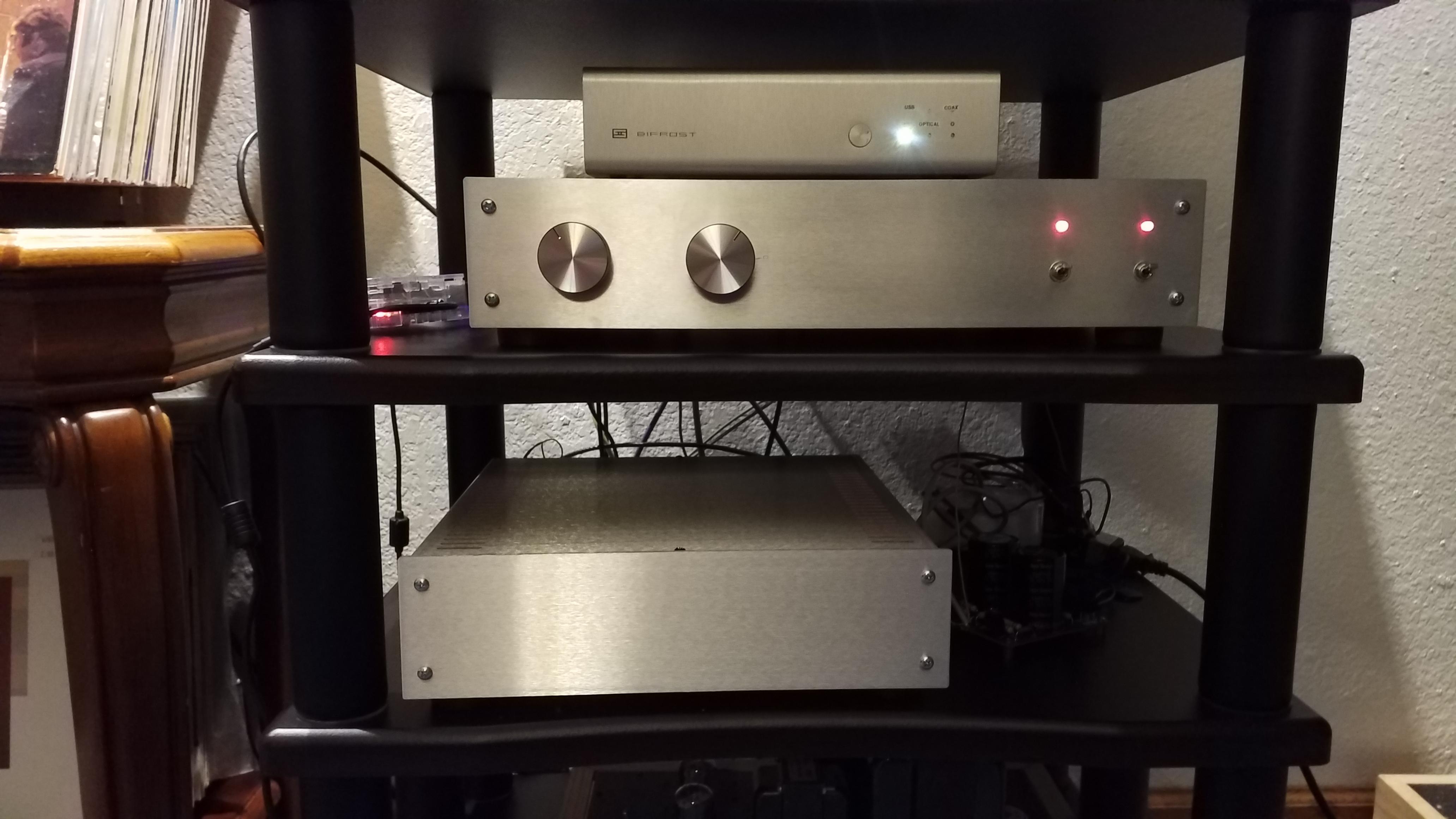

Boards fit nicely in to a Par-metal 20-12123, 12 inch by 12 inch by 3 inch chassis. Next up is a proper chassis for the power supply.
Nice and tidy
That looks great and really affordable, I may abandon the Protocase idea. Any thoughts on how well the aluminum shields the UFSP at 62dB gain?
I am running mine at 43db with only a slight hiss at a very loud listening level. Par-metal sells the enclosure in a Gold/Clear alodine finish for EMI shield. I chose the unfinished version and am very happy with it. The line amp in the photo is a DCG3 in a Par-metal case.
