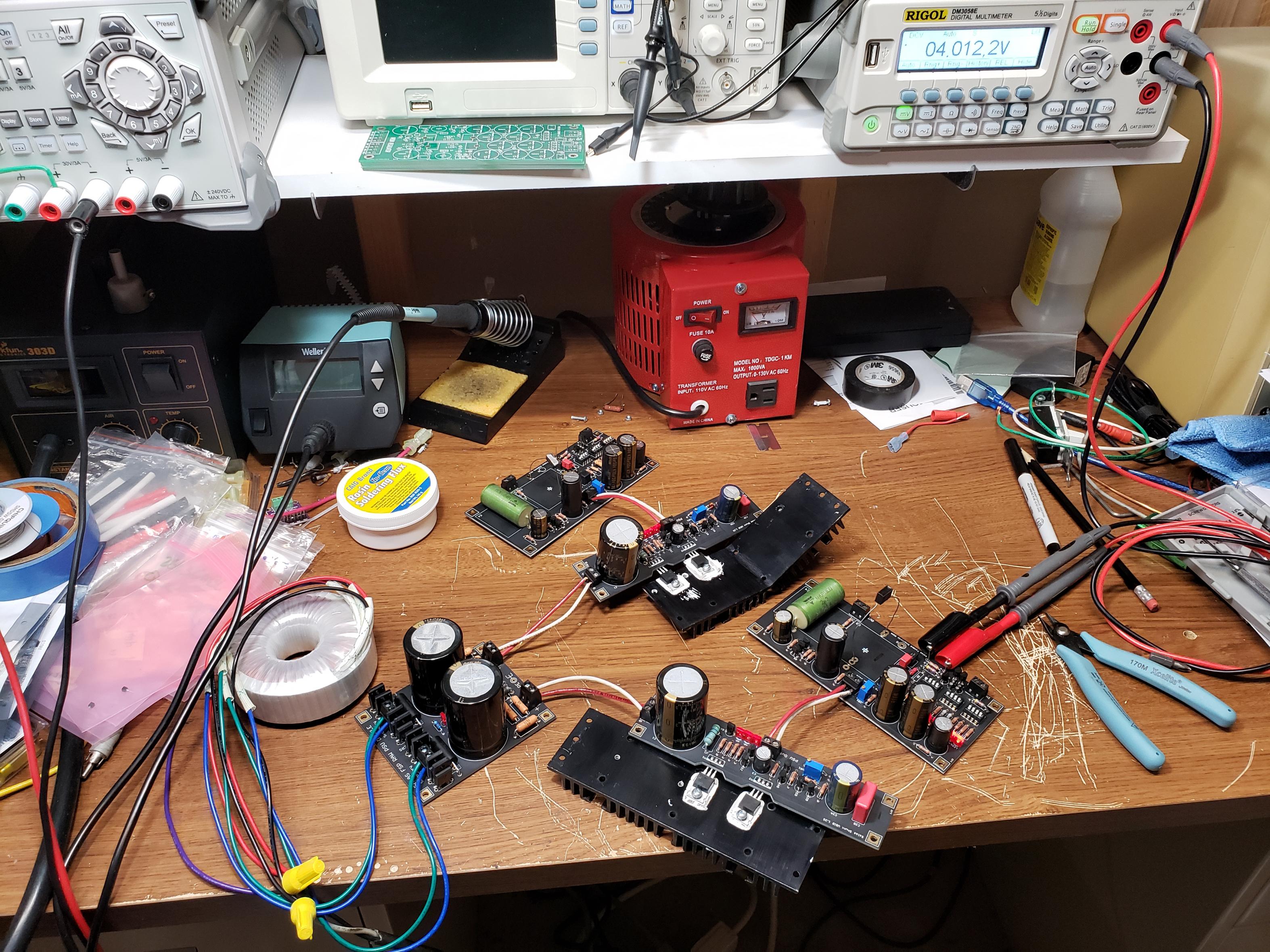

Success! I was able to hook everything up and get 4.0V across TP1 and TP2. I did have to lower the regulator voltage to 31.9VDC. I have it set for MM and 47k termination. I'm waiting for the rest of my pieces to come in so I can try it. I'll be pairing it with Wayne's 2018 BA linestage with a little more gain.
Since you got bench gear and you like measuring here's a test idea. Put together a 10k series 100R to GND resistors L-Pad. Send through it 500mV RMS 1kHz sinewave from your generator to the phono inputs. 5mV should reach them. To mimic MM cart level low noise signal. Compare channels output swing on your scope. To confirm gains match success. 1kHz spot check does not need an anti-RIAA input filter.
Yes its general purpose 1:100 divider to bring gen noise down. Always load it with over 1k at phono input because it has 100 Ohm Zo not to lose signal. 47k all load switches off will do. Build member Bonsai's inverse RIAA proposition. Its mainly useful for response checks and squarewave checks. An Accurate Inverse RIAA Network
If you buy Hagerman's instead, its gonna do well for confirmation work but its compatible with UFSP for up to 1kHz accurate square only. Because it has an extra 50kHz constant that UFSP avoids by design choice. Last octave in frequency response test should be droopier for UFSP because of that. See #18021 #18032 #18045.
FFT 1kHz you may run already with just the divider. For best noise results shield the divider. Two small resistors fit in a connector's metal barrel.

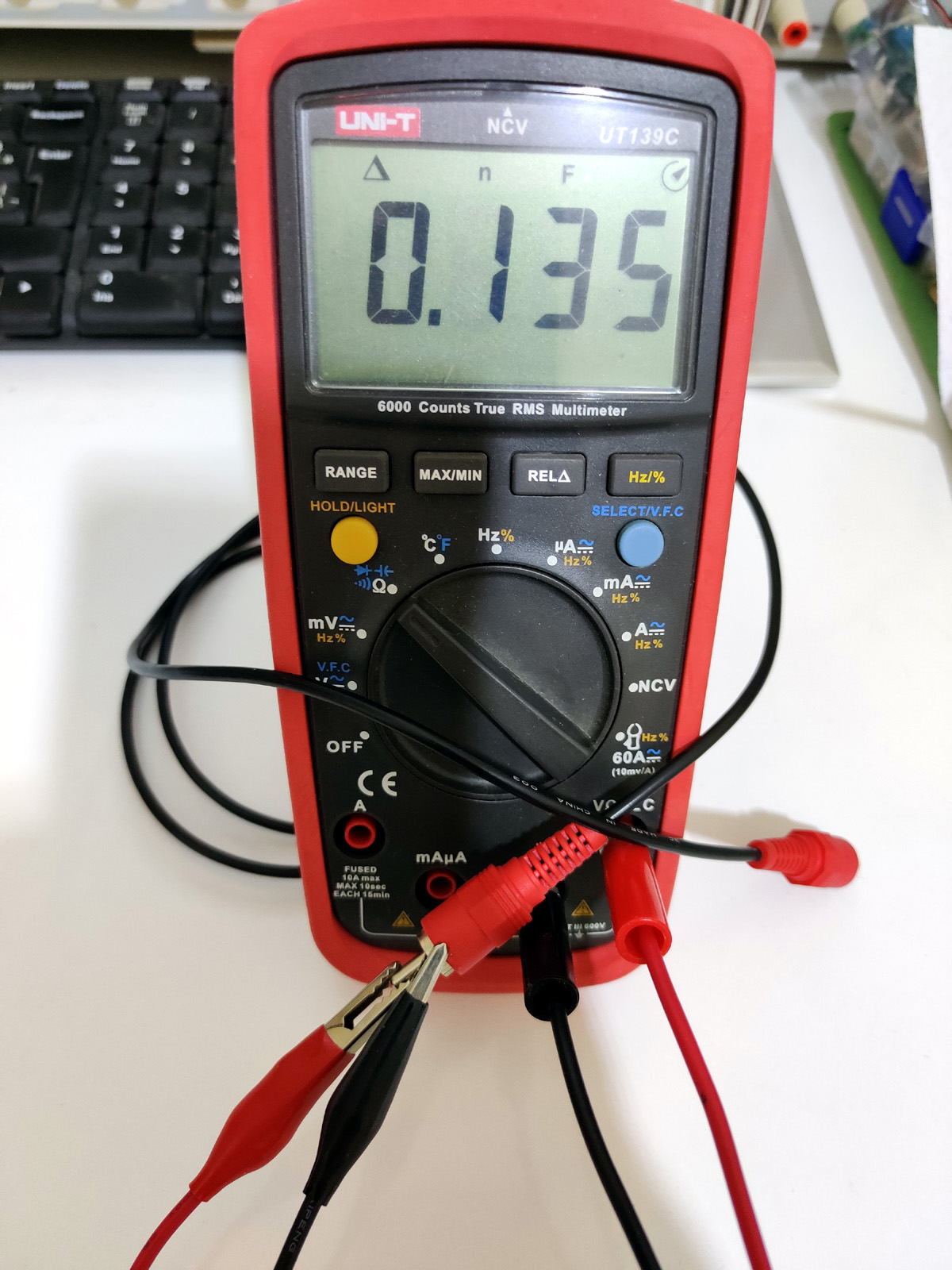

This dirt cheap 1.2m RCA interconnect cable shows 0.135nF (135pF) on an affordable DMM for instance. My calibrated LCR meter said 134.7pF at 1kHz. Pretty good agreement. Readings differ on how its laying also but +/- 10 pF.
Way cool. Thank you.
Don
