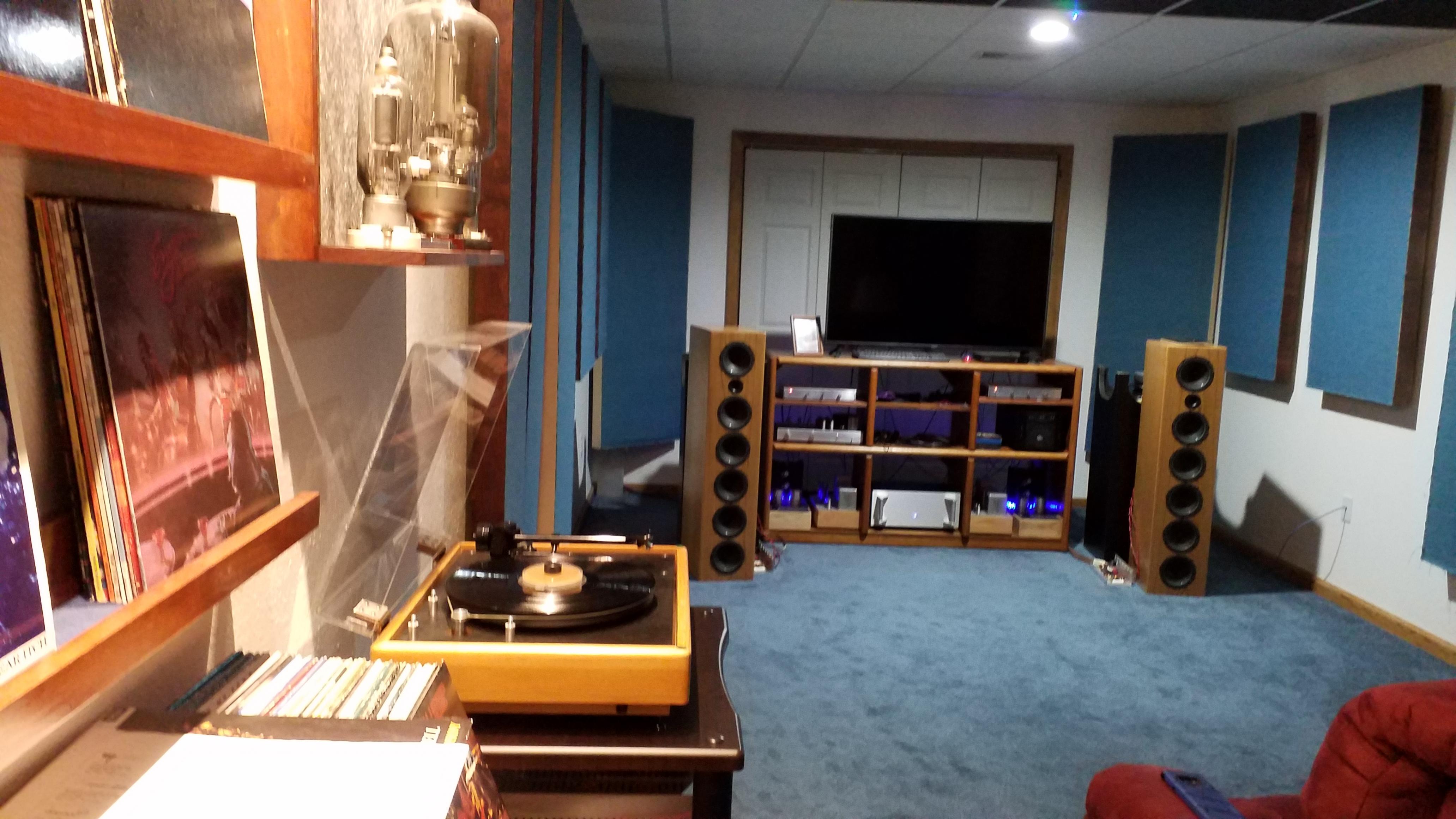

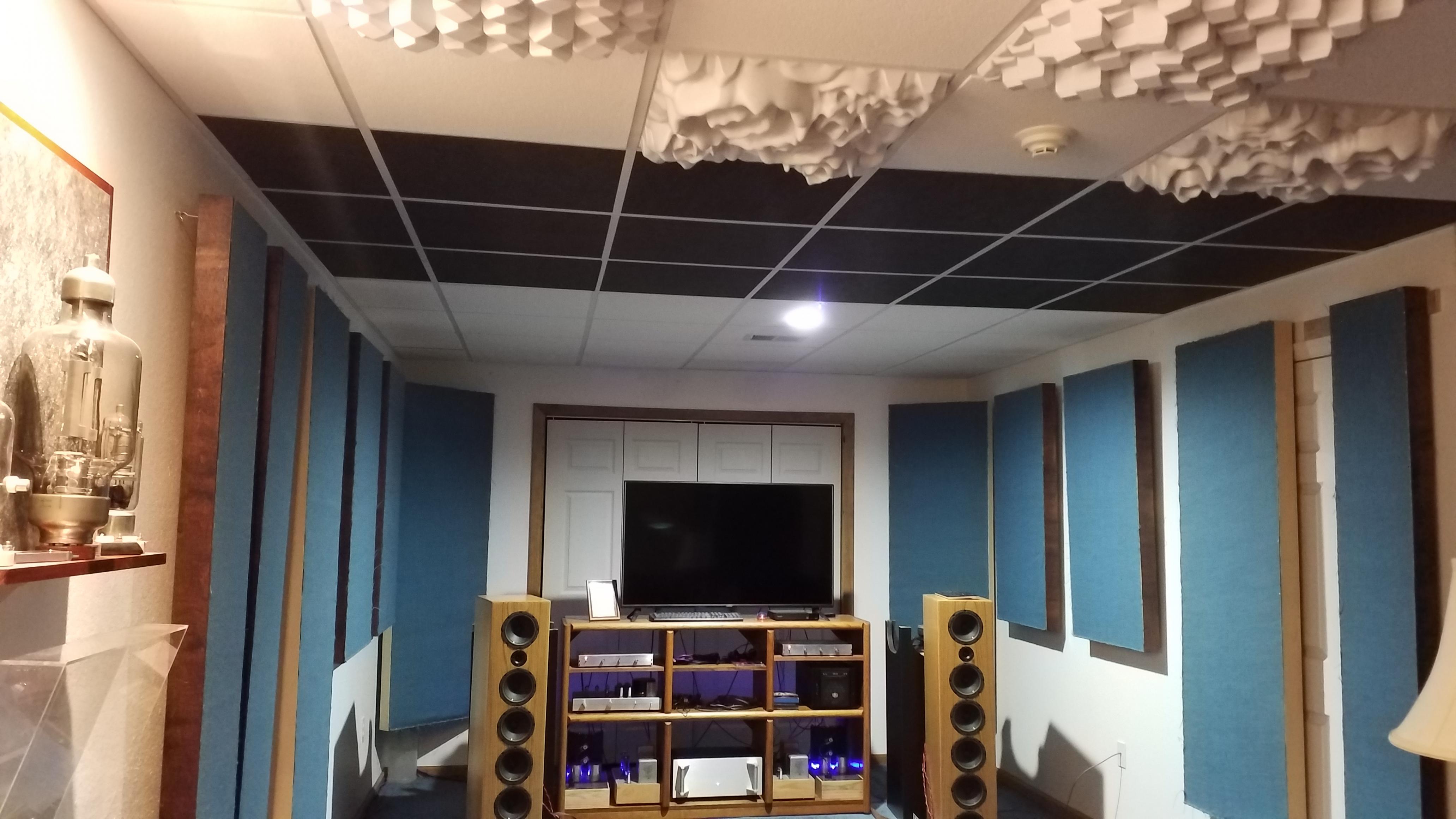

This kind of Stentorians are like your main speakers, or there are more versions? They look able to go very loud as their name suggests. How sensitive they are?
Wow! Great listening room. And how much peak power can they take? Interestingly their name is from Homer's Iliad. Literate people here sometimes used to say about big loud guys the phrase having a Stentorian voice.
I bi amped the system and am driving them with a Aleph J . The low end is done with a set of 160 watt mono blocks ( class AB of course ) driving a pair of Audio Concepts Saturn sub woofers , a pair of 12 inch woofers , compound push pull. The system will rock the house. The Saturns are 30 years old and have been kept in good condition. I can find no reason to replace them.
Must be very satisfying for symphonic and stadium rock. So the DCG3 is tasked to drive long cables from where the turntable rack is all the way to the back where the amps are?
The DCG3 drives those cables with ease. Very glad I went with that preamp. I can reach the controls from my listening chair.
Nice comfortable listening layout. Are the long cables one stereo run that goes to an active crossover unit? Or more runs are involved in parallel directly to the amps and increasing the driven capacitance? Are they normal spec coax or special lower pF per foot type like some Mogami and Belden?
The coax is terminated with BNC connectors to match the preamp outputs. I hate RCA connectors, too may failures.
You are a practical man. And evidently experienced as you gave priority to what really matters first. Acoustics, big sensitive speakers, basic electrical spec, secure connections. All DIY. Congrats and enjoy.

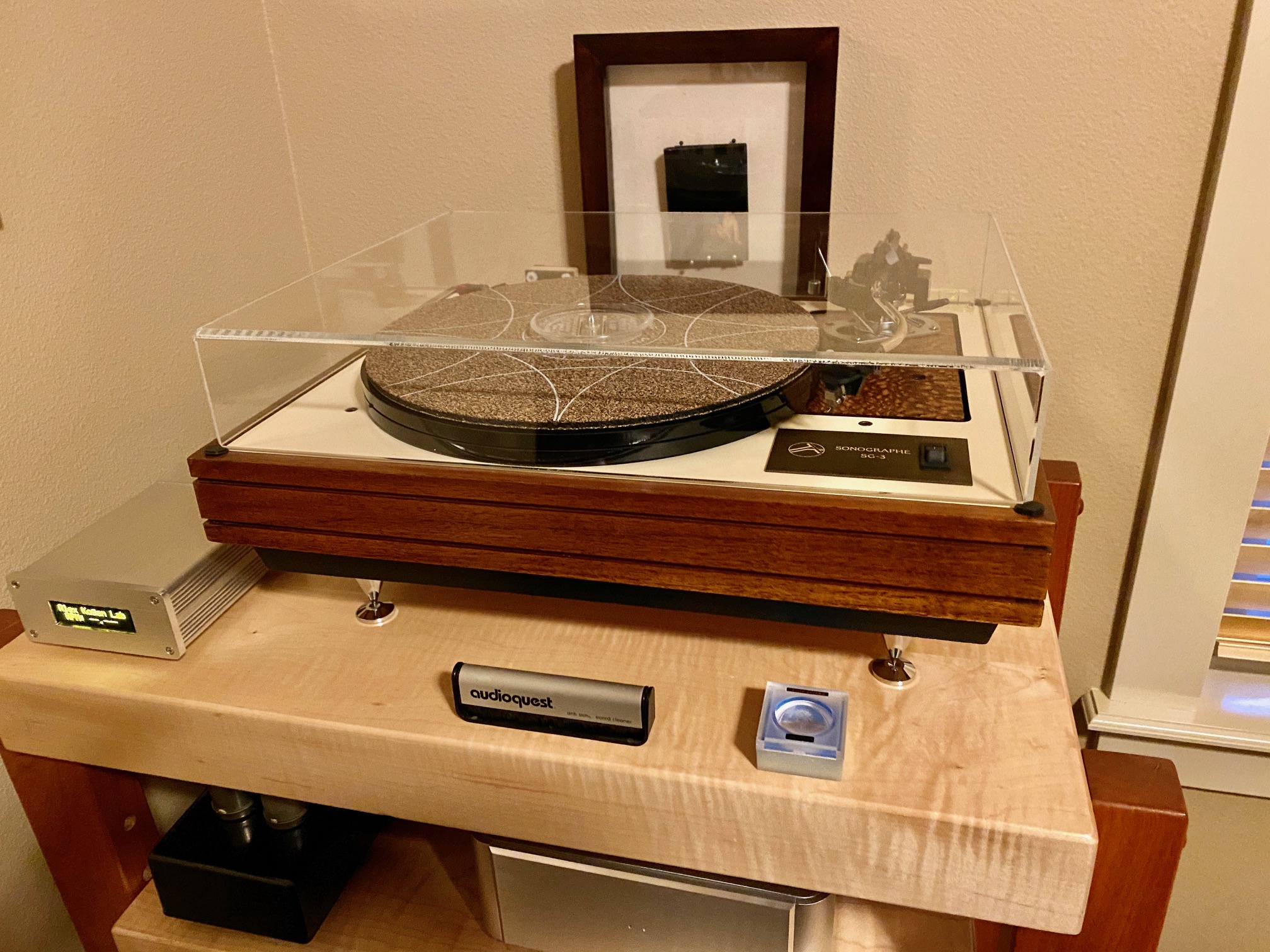

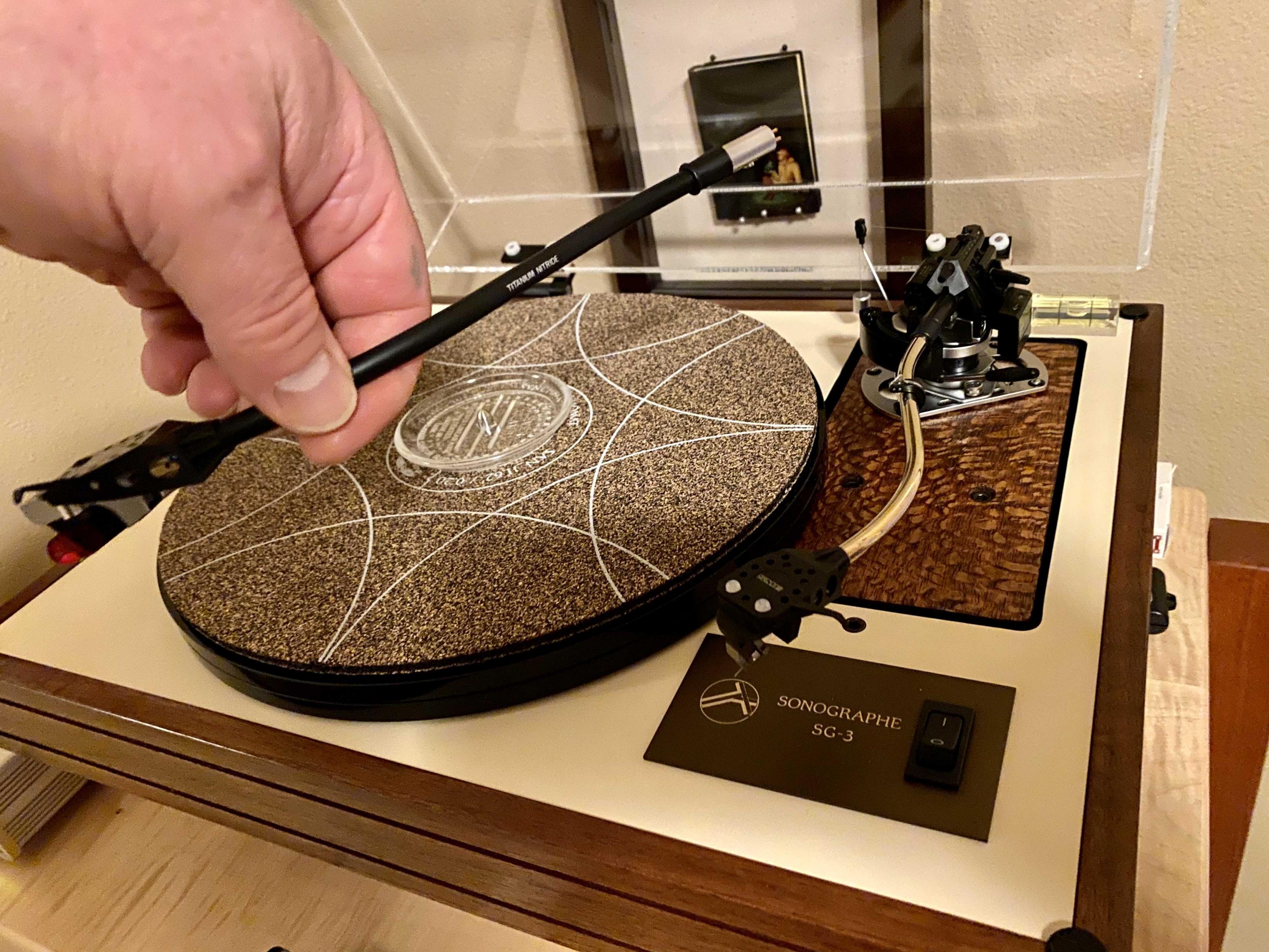

Interesting American table. Not very usual.
I have two of these nice tables from the end of 1970’s . Both fully restored. One is with SME III and the second one with Mayware Formula IV.
