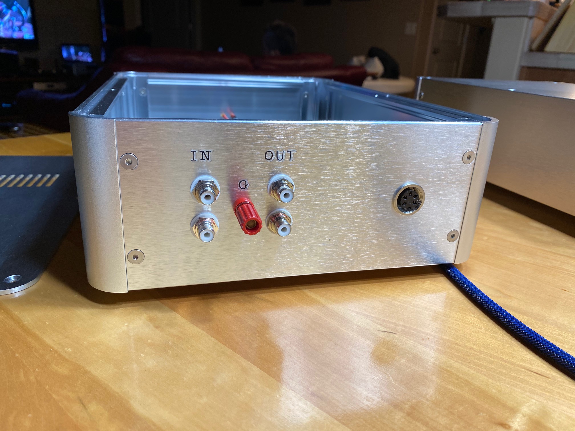

Just curious what you use to cut your sheets for the box from scratch.

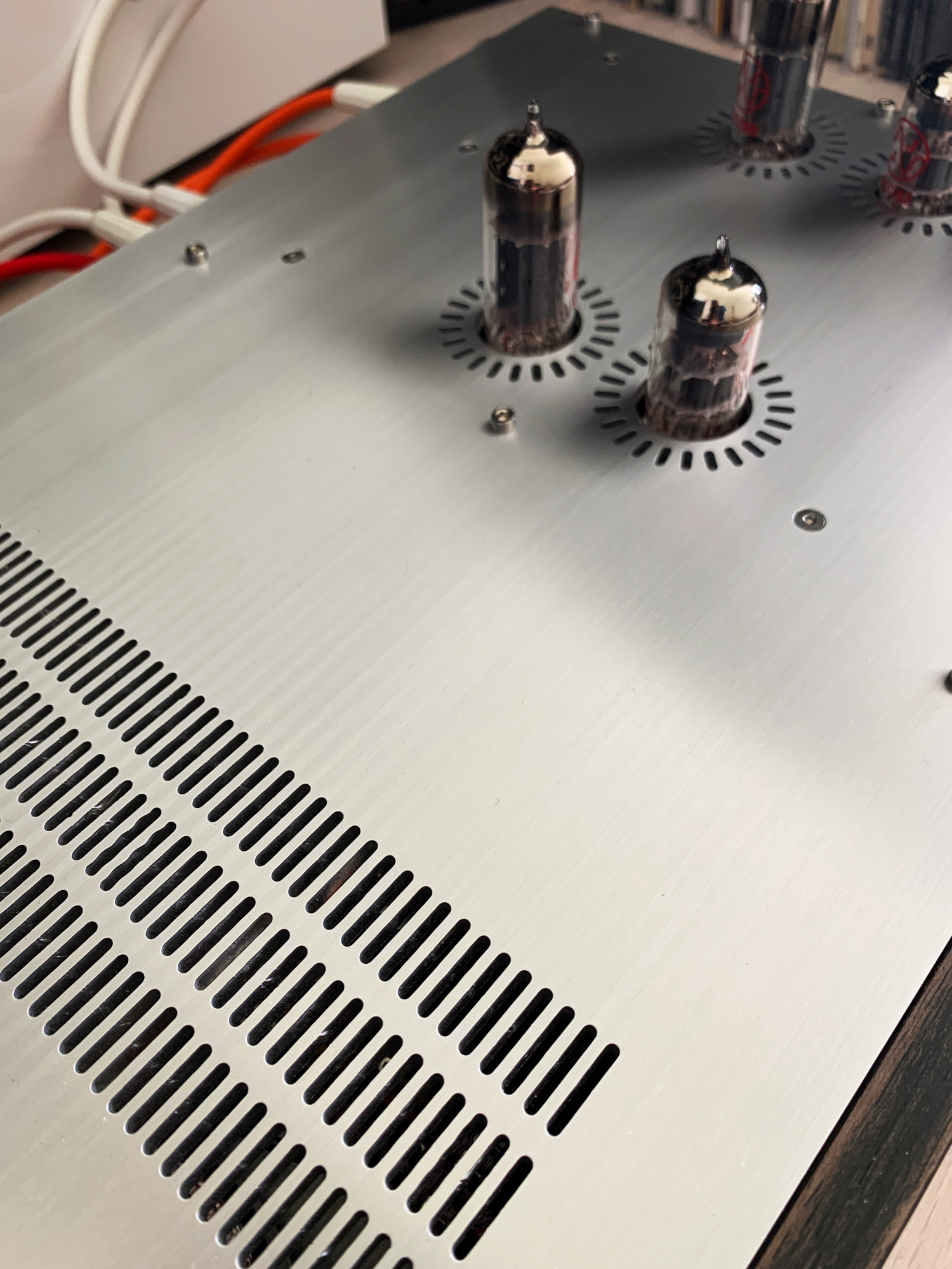

Non-ferrous blade on the tablesaw and miter saw...plus some 2D design and files uploaded to services like: Laser-cut metal parts Shipped Fast | Instant Quotes
For vent holes and such—if you want to get fancy—otherwise drill press and time...

Thanks! Chassis are definitely a challenge. I've been using a range of thicknesses. If you check the link you will see that in aluminum they have a really nice range. .375" panels can be directly tapped (side rails), then top, bottom, back, front for whatever you are trying to achieve. That image I posted has the board hanging from the top—so I went thicker, .187". For Ultra, .375" for side rails as a foundation, .125" for bottom "heat sinks", went .08" for the top with a design cut into it, .125" for back and front—though the actual front will be wood over metal for max faraday. The real challenge is finishing the raw aluminum—Johnson wax works really well after you brush/polish it to preserve the look. Media blasting would be ideal—as would anodizing. After all this—informing a layout—6L6 and I will see what we can pull of with a Modushop version...try to get this phono masterpiece into as many hands as possible!

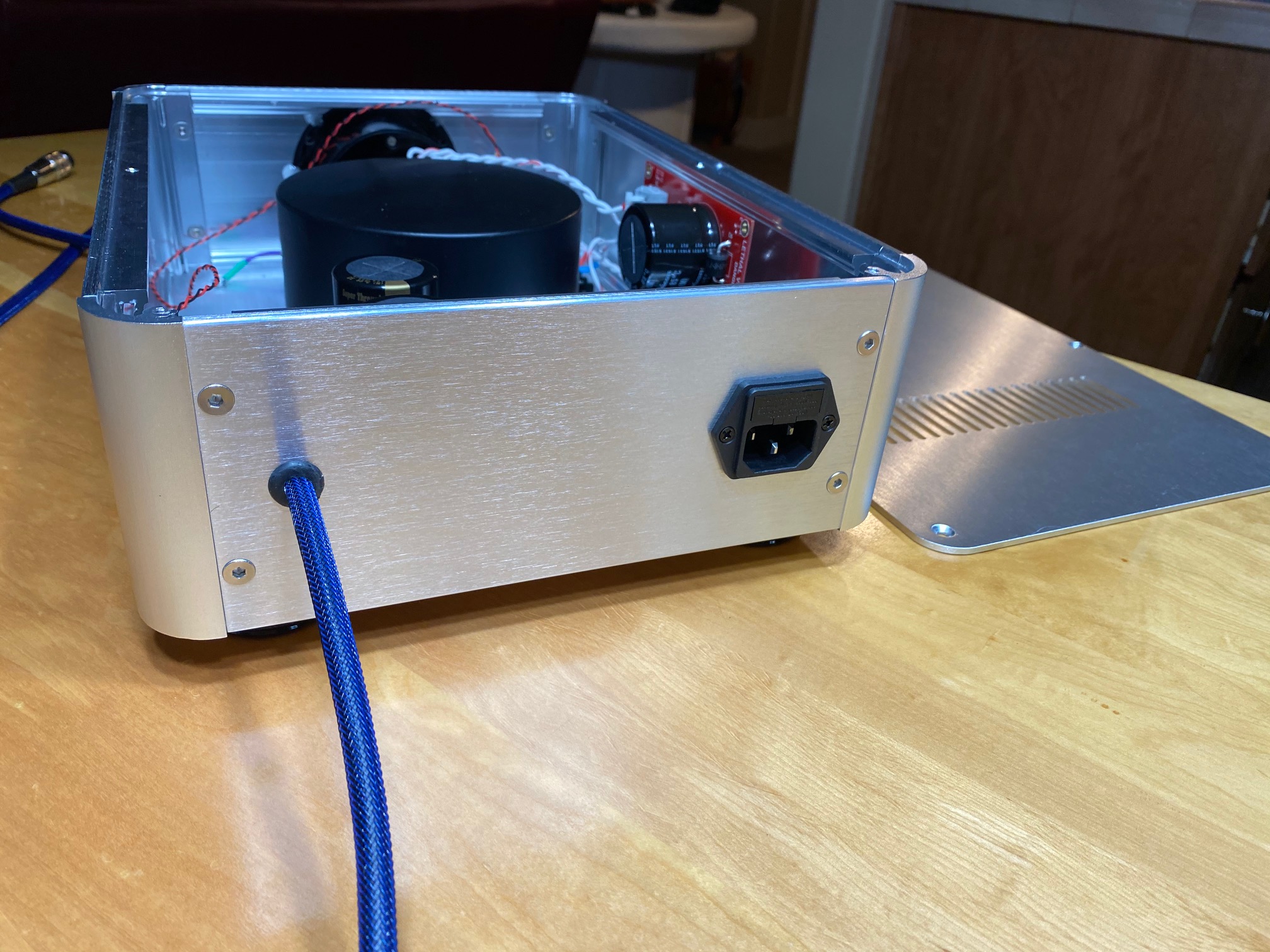

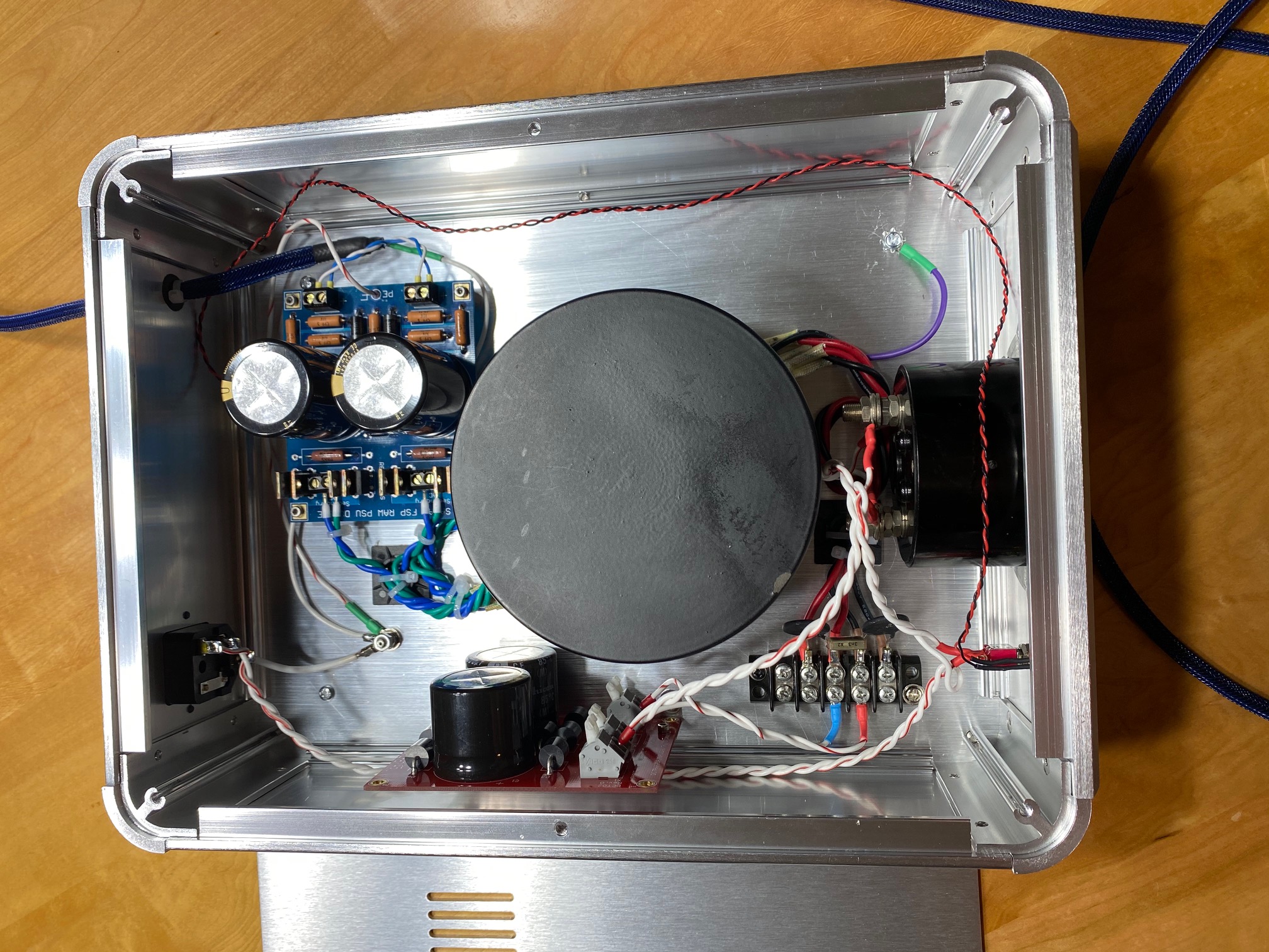

I fixed my original FSP. It is the one with wrong C3 caps. Thanks to Salas and his dedication to details. He found my mistake. So, I use 0.1uF Mundorfs now and re-boxed it.
About AT-ART9:
I purchased one from LP GEAR about 4-5 years ago. It is very nice cart and based on my subjective opinion, it is way better sounding one than my Bentz Micro made Ply (it is a “Glider”, modified for Wilson Benesch). I didn’t ever regret for my decision to acquire it. These new models more expensive, but might sound even better than already classic ART9! I had only one challenge with it and it is hard to set it up (may be I’m spoiled by not encapsulated carts in the past). Its Al body and its bottom cover is quite bulky, and it is blocking view of cantilever/stylus during fine tuning.
About FSP vs. UltFSP SQ:
My UFSP definitely has more airy sound. I started to feel that right after first warm-up. I also hear well defined and very articulated sound. Lot of details that I missed on FSP. Also, it is more silent noise-wise than FSP.
However, I’m not sure if it is a fair comparison for my case since I used different caps:
FSP C3 and C4 both are Mundorf Supreme SilverOil
UFSP C3 is Mundorf Supreme SilverGoldOil and C4 is ClarityCap CMR
Also, I used different resistors:
FSP is mostly with PRP 1%, 100PPM
UFSP is uses mix with mostly 0.1%, 50PPM.
Gain is almost the same on both units and both uses Vishay’s z-foils for critical locations.

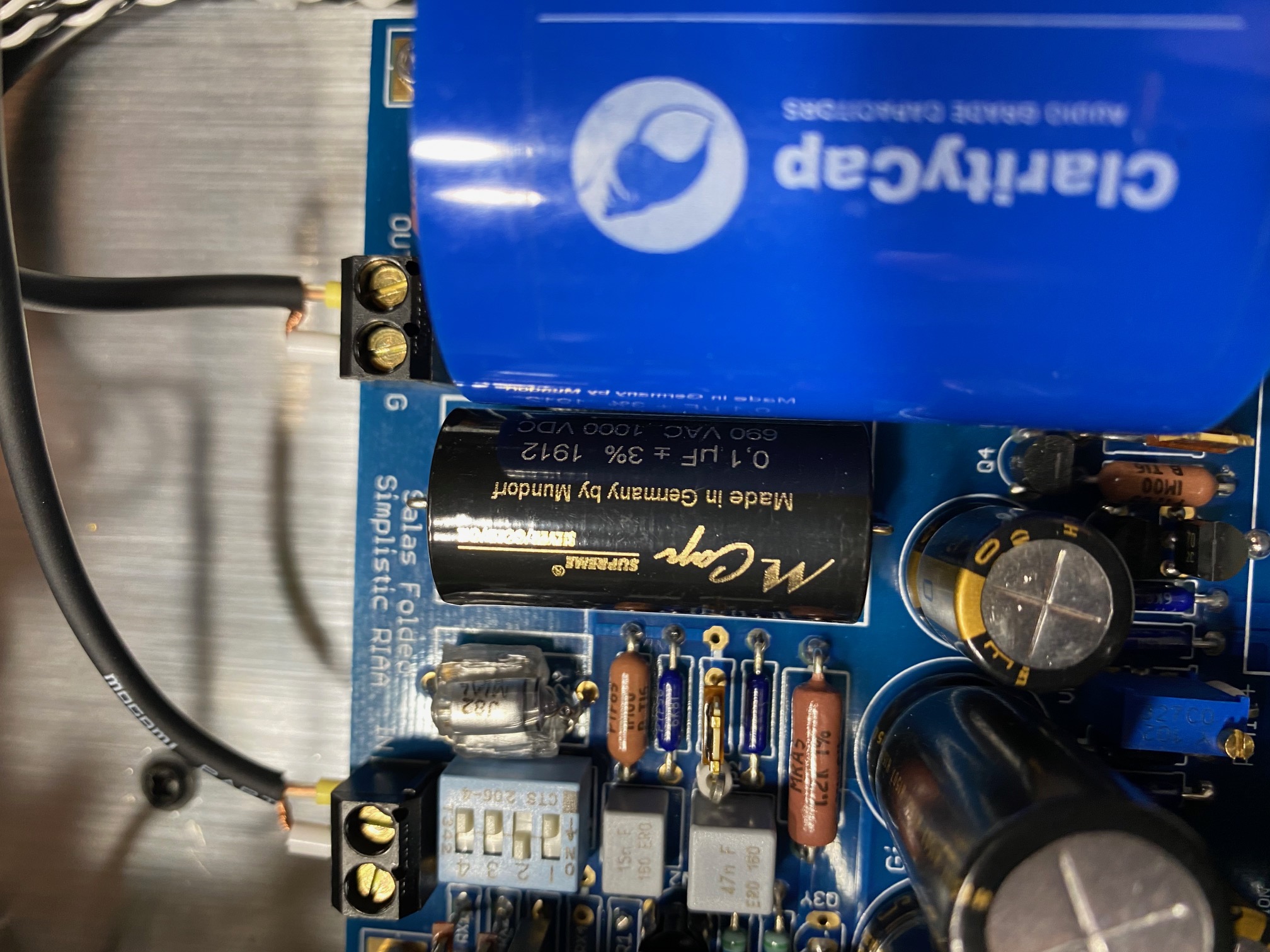

But why we see a Clarity MR blue C4 in the first photo instead of a Mundorf SUPSO as described? Also C3 is a SUPSGO not a SUPSO as described. Shot at different points in time after some parts swaps or from two different FSPs or something?
P.S.
We can see the described C3 C4 Supreme Silver Oils in an older post of yours #17921. In post #17913 they are both MR blue though. Two different FSP builds.
P.S.

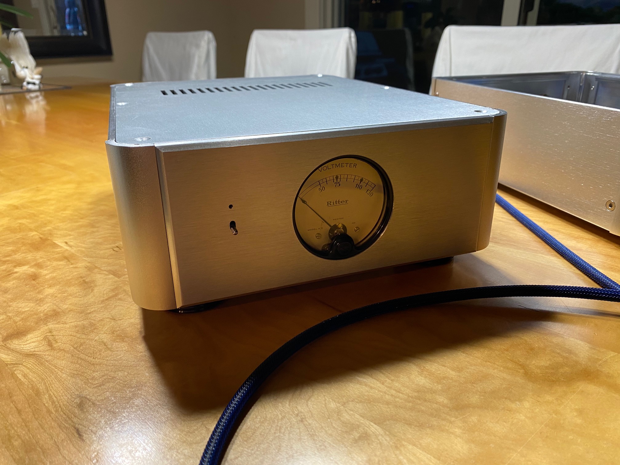

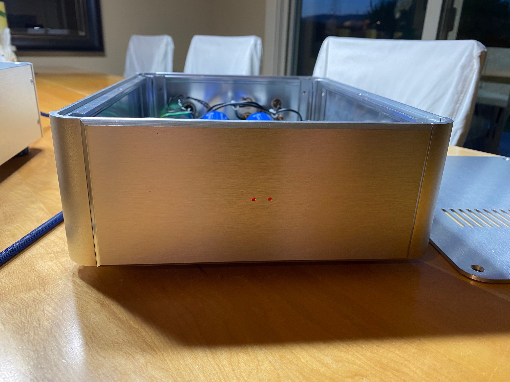

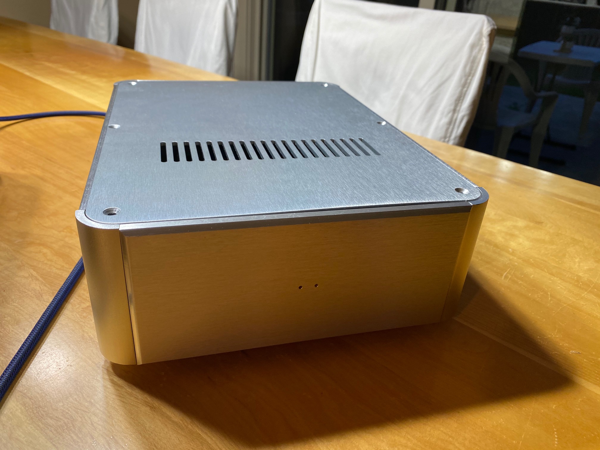

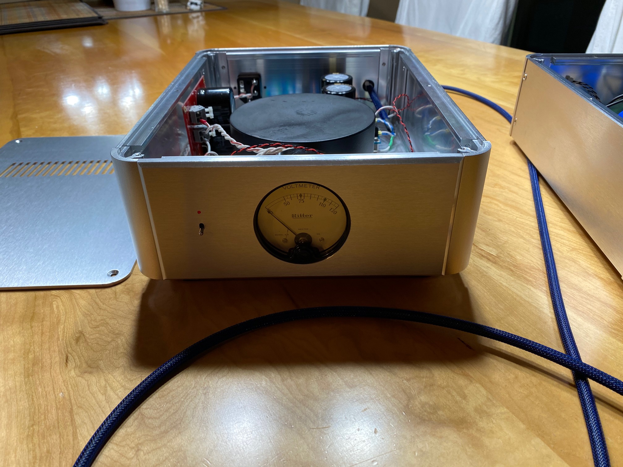

@myleftear—
Almost every amp I've built to date has had a wood front in one form or another: F5, Aleph J, M2X monoblocks (Current)—Wayne's BA18 Pre, ZM Iron Pre—FSP.
Recently built an Aikido pre that deviated from this with a full alu enclosure and wood over alu front for looks—I would easily label it "quiet" though I can tell when it's on—there is a slight hush (ear to cone) perhaps the nature of tubes?. I haven't noticed any adverse effects. I haven't A/B'd any of it either. My speaks are 97db—so they are quite revealing. Aleph J is the only project I would say is "not quiet"—but it has a sweetness that is only recently back I think due to Aikido—but haven't lost any of "clarity" I gained from M2X. And the quietest pre is Wayne's. We are talking ear right to cone here.
FSP NEEDS it's lid on—I can hear a difference with it off. Also heard a difference before I roughed up all the contact points where the chassis pieces connect. I would say perhaps—that may indicate further benefit from putting back some missing aluminum on the front? UFSP chassis will have wood for looks over aluminum—so maybe we will see? With FSP powered (SUT config.) on the "noise floor" goes up a hair (It's really more like "absolutely barely")—and proceeds to change with different carts—This is a new experience for me—I think it's progress with the rest of the system and in general.
@alexkosha—
Nice case! Details about the board and meter????? Fabulous. Is this from the same person that made the wood sided ones? This chassis looks like it's fabbed from some "factory available" items—corner pieces—if not from a branded company? More info if you have it!
I'm laying out UFSP wide and shallow around 340x160mm, 50mmH. Do you see an overall benefit to the shielded trasnfo?—assuming in regard to proximity in the rest of your system.
P.S.

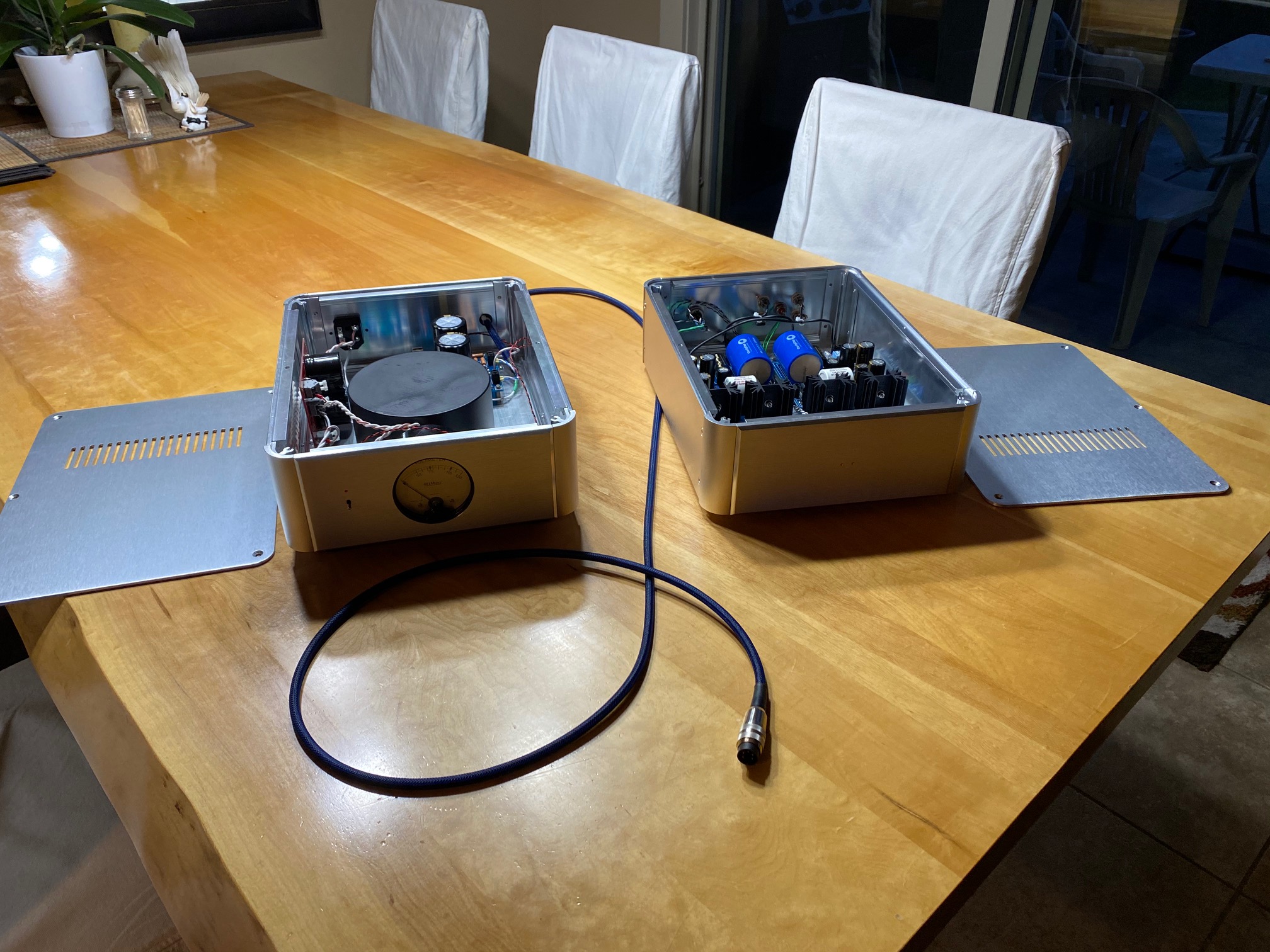

Absolutely right. It is two different FSPs.
#17913 one was connected to Triode pre with 100k input impedance. Therefore, I intended to use 0.047uF in C3 position. Ended up there with 0.47uF due to supplier mistake and my lack of verification.
My UltFSP replaced one described in #17921.
