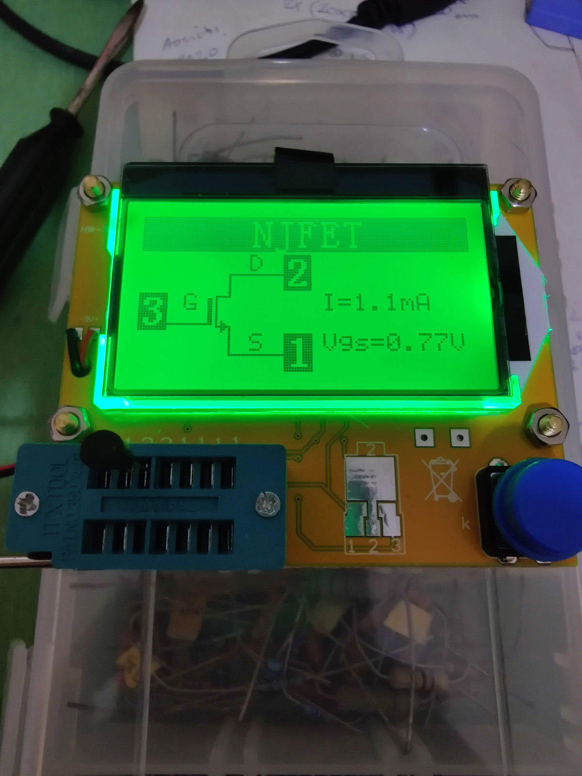

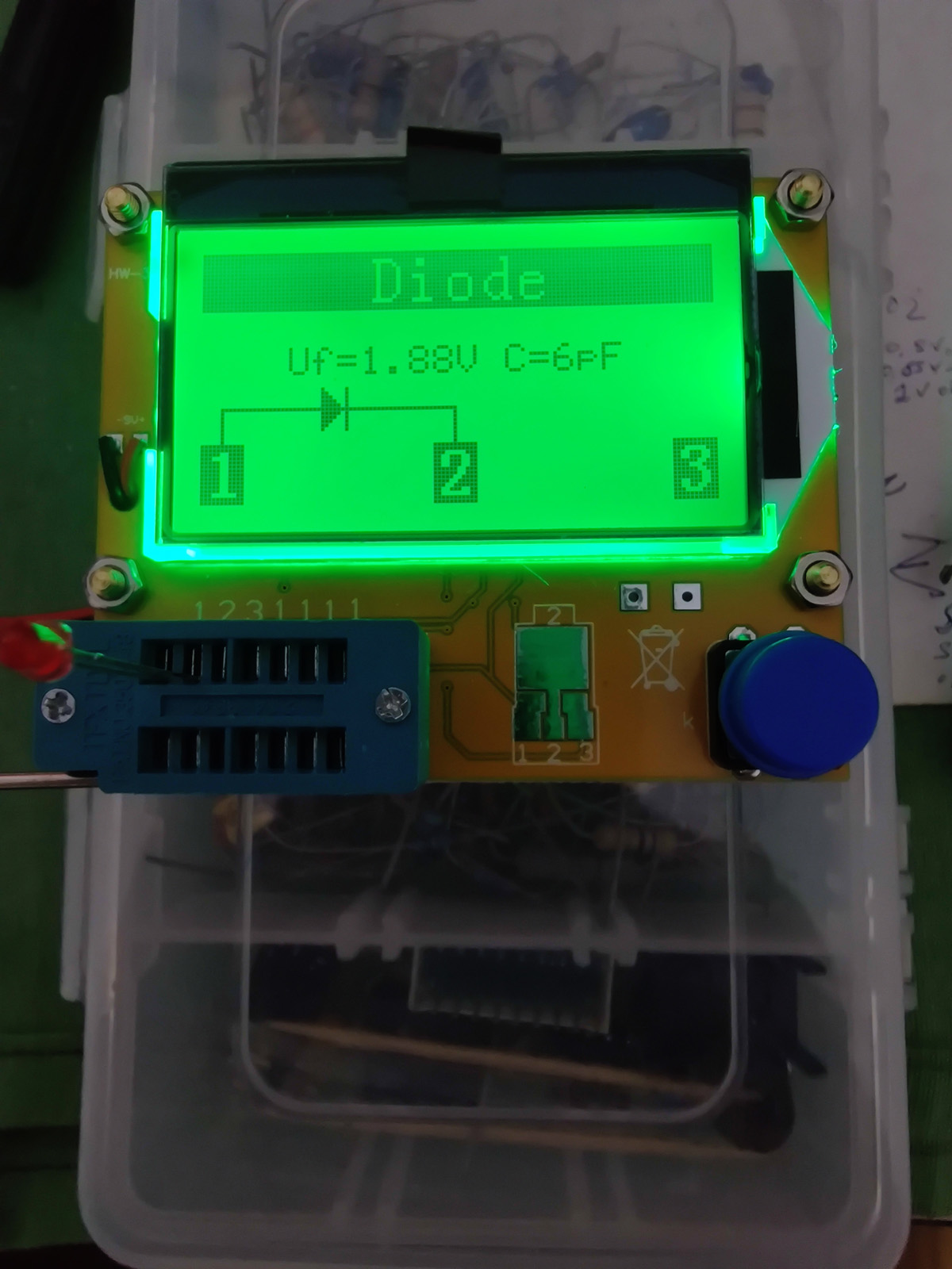

Test life is a struggle
Cheap tester:
I know everything, here's an LED :wave:
2SK170BL:
Hold my beer 😀

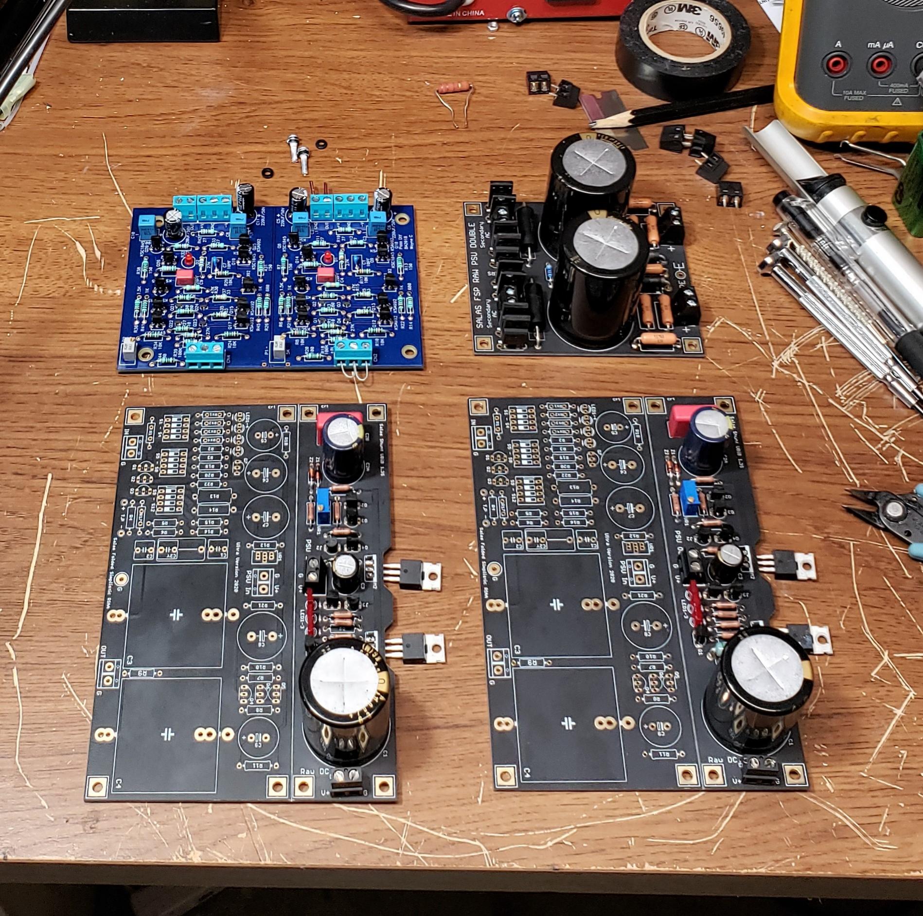

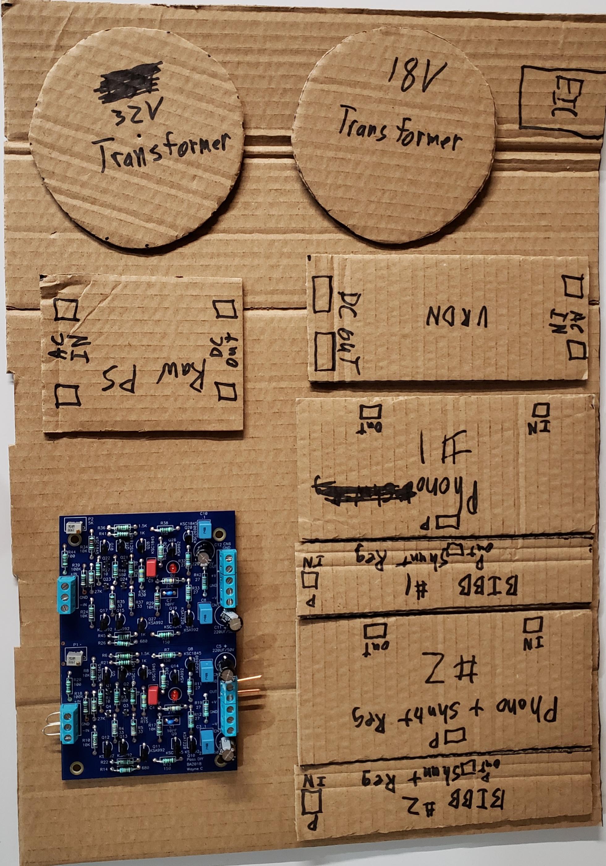

Here is how I plan to place the boards in the cabinet. I've ordered torroid shield covers for the transformers and plan to place a partition between the power supplies and low level boards.
A PSU board's AC in next to phono signal in is precarious for hum interference. Especially if you will use MC cartridge. Its not only the transformers themselves but the AC power wiring emitting a field too. Primary and secondary. Metal partitions are good in stopping RFI (not when aluminum) but not that good for 60Hz fields. Distancing is more effective. Better rearrange with the Wayne's board at the back and anything phono input related, including RCAs, most away from anything AC power. You can even part the 1.3S sections from the main phono boards and mount them against vertical panels of the box to make extra space. Turn the phono boards for I/O facing the back, allowing In connectors to trafos max distance. Shielded coaxial signal cabling is a must too. Twisted pair signal cables are passable in two box builds mainly. AC cables should be tightly twisted and neatly tacked away along the chassis corners behind the trafos like heaters cabling in tube preamps.
