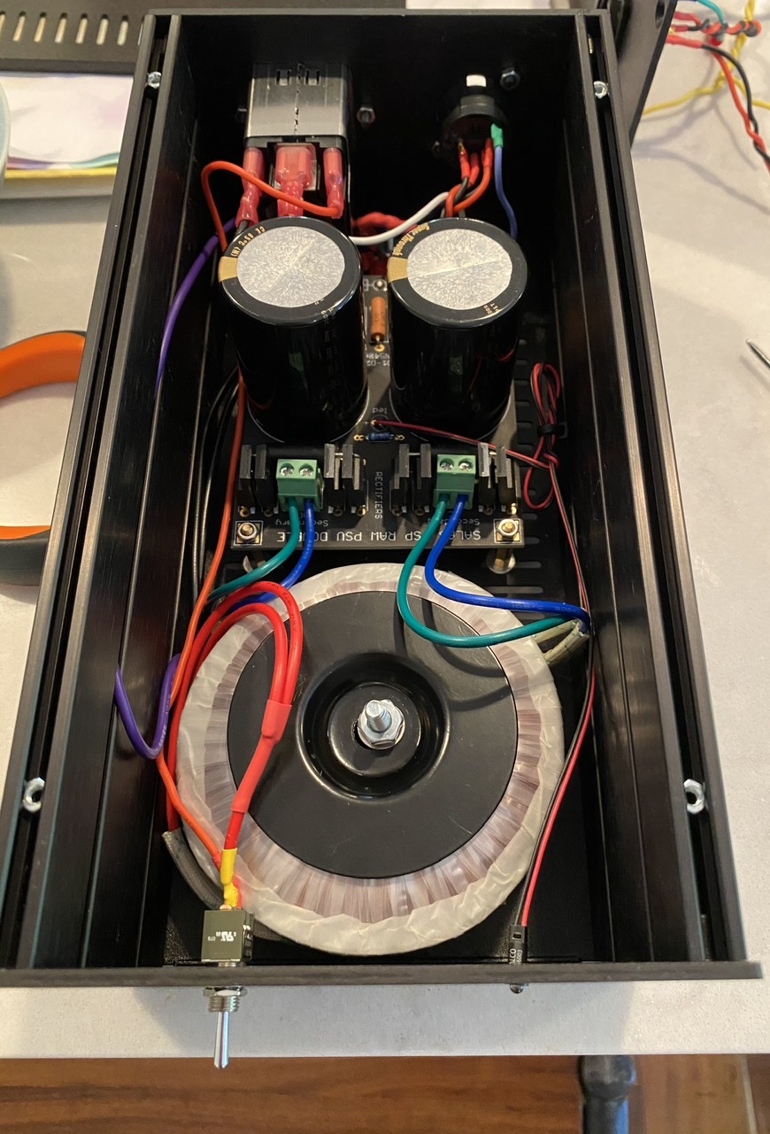

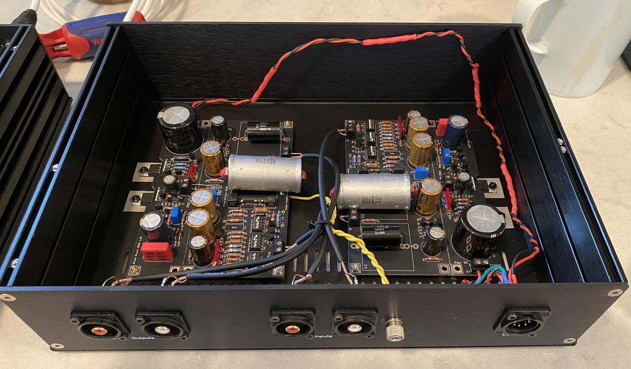

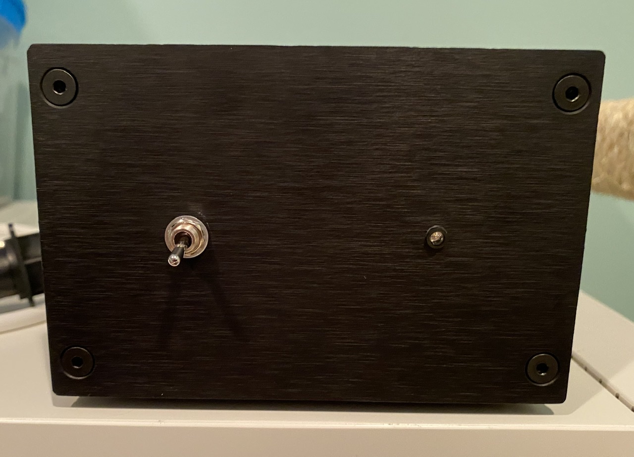

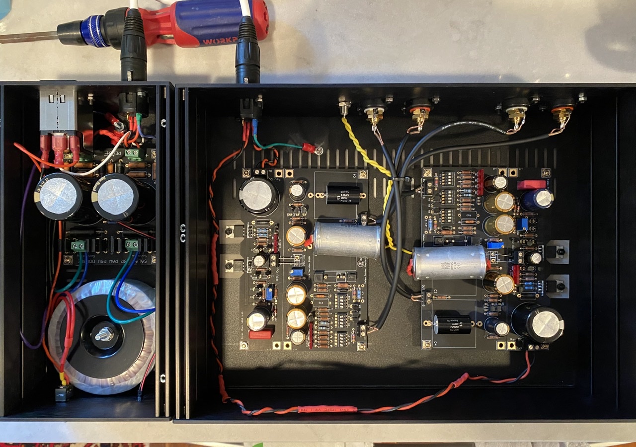

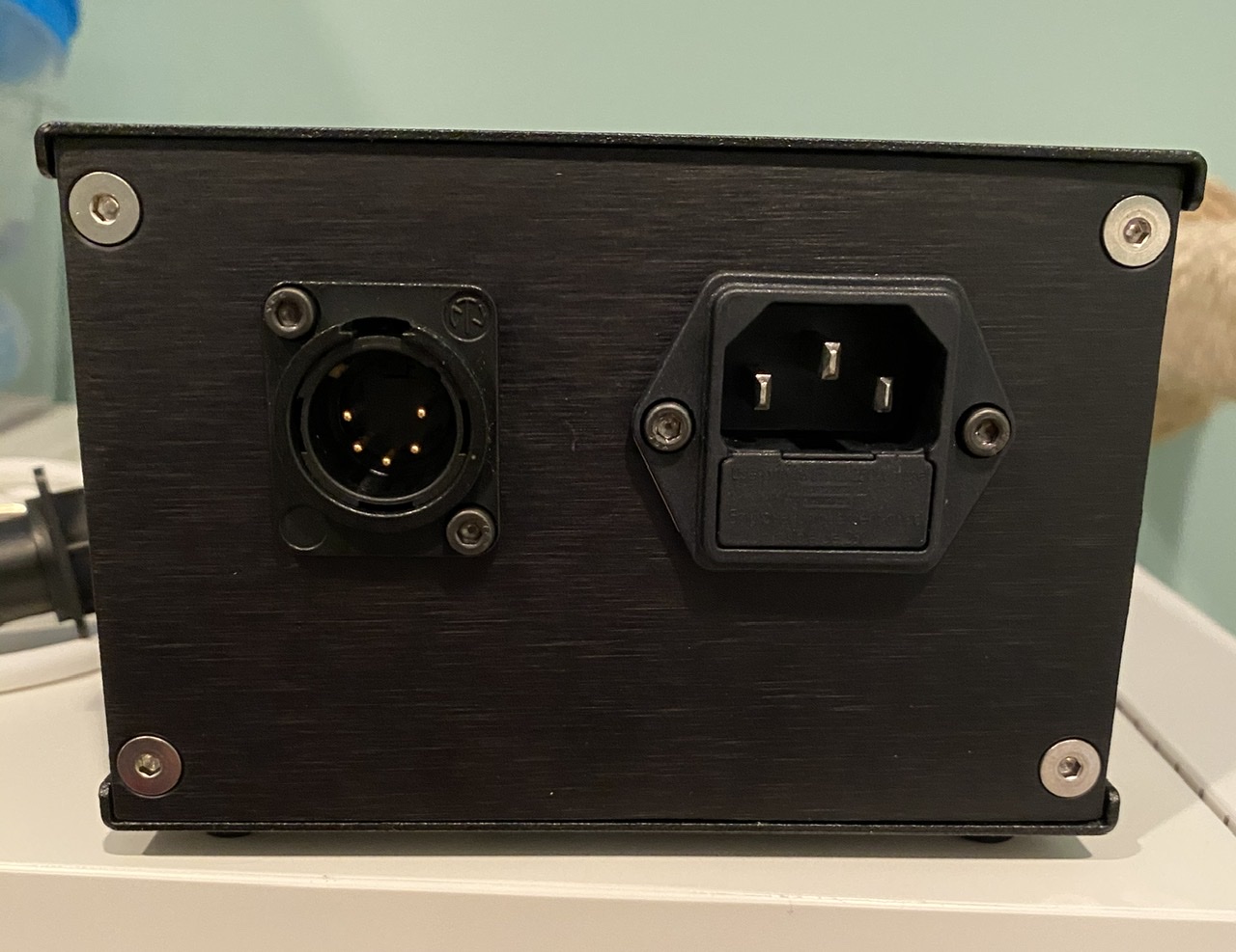

Ok — pretty much done here. Got it fired up for a quick listen at 40db gain on my Pioneer PL-560 and Ortofon 2M Bronze. Listened to the Analogue Productions 33 of Nina Simone — Little Girl Blue. Piano was particularly noteworthy, and the UFSP is dead silent. Looking forward to spending more time and messing around with C2Y a bit. Clarity and Miflex caps should arrive in the next week or so.

Very nice tidy build. Congratulations. You will surely put it through its paces soon. Give it some hours of play or simply power on idle time for electrolytics to flex a bit until the boutique films arrive.
By the way if anybody who feels well acquainted with his UFSP build sound by now, wants to also try hear possible differences for somewhat hot-rod PSU CCS current, all you have to do is piggyback a 10 Ohm resistor over the 5.6R R1 in each shunt reg section. You may weigh if worthwhile vs some extra dissipation or not for yourself. If not worthwhile, simply remove the 10 Ohm. Takes no disassembly anyway. Fun test.
Let us know how it will play!
