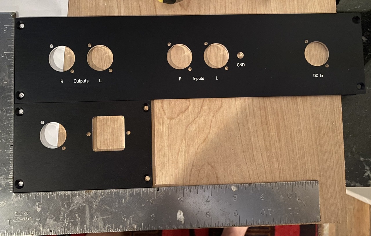

Chassis arrived today with custom back panels. Man, Gianluca at Modushop is amazing. I sent the CAD files late on Sunday expecting to hear back early in the week. I heard back in minutes, he fixed some issues from when I converted from FPD to DXF, and — 4 days later — they are machined, printed, and delivered in the US (all for more than reasonable prices).
PCX was sold out of all the caps I was interested in, so some CMR 2.2 and Miflex KPCU .1 uF are en route from HiFi Collective.
Fingers crossed for a successful finish to this build.

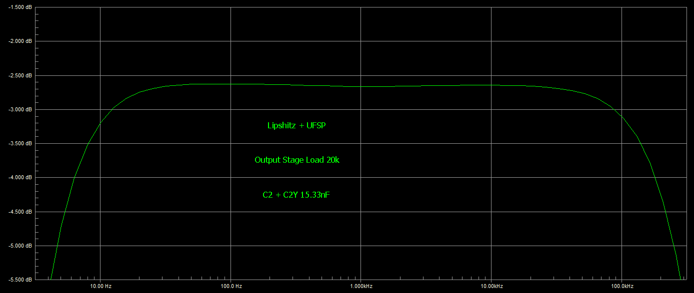

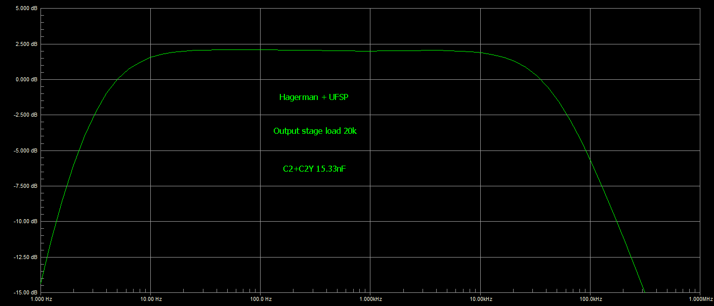

It's a modified Hagerman inverse RIAA.
I will have to simulate it for studying its details but it seems like it worked pretty good in practice.
I run the sims in combination with UFSP for your C2Y. That inverse RIAA worked very well for 1kHz square testing because together they keep necessary flatness up to 10kHz. UFSP does not cater for the extra "lost constant" or "mythical" 3.18uS pole (50kHz F4) included in the Hagerman so their combined response should be dropping faster in ultrasonic frequencies vs a classic Stanley P. Lipshitz inverse RIAA. Frankly lost constant sounds kinda pinched to me with records if included in the phono's RIAA network. So I avoided it in all phono versions. Other than it would make a 10kHz square look rounder than with UFSP's 100% compatible Lipshitz inverse, no other harm when using the Hagerman in testing.
Simulated -0.5dB Hag+UFSP shyness at 20kHz maybe reproducible on the bench or not, because exact HF can fall in the experimental error region of generator's cal response, scope's cal response, simulation's modeling precision, and passive networks parts tolerances.

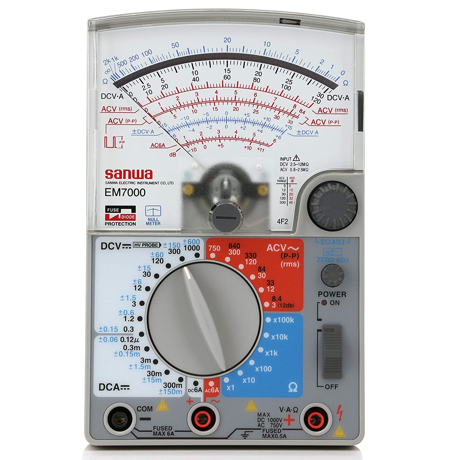

I remembered to try my cheap Pro'sKit MT-2017 analog meter yesterday, and you know what? Not only its Hfe measuring of TO-92 transistors was in the right zone but also watching DC fluctuations on its needle was more natural to monitor their swing. You don't get DMM accuracy, ok that's understood, but with just a glance you know if things are alright and how important a deflection is as a percentage. No decimal digits dancing party to watch.
Also no battery power is used up for voltage readings on a needle meter, so someone can hook it up and watch over something forever. 🙂
I believe I made this same point a while ago. With a DMM it is easy to get carried away chasing the last decimal place, when all we really need is a stable voltage in about the right place. Like you said, a glance tells you whether a change is large or small compared to the value you are measuring. It's more natural. I have an old cheap analog meter and ought to use it more, and I wish I had a good analog meter. When I worked in a stereo shop in the service department a lifetime ago, we had a very nice old VTVM I used for tuning up tape decks. I spent a lot of time watching that needle. 🙂
