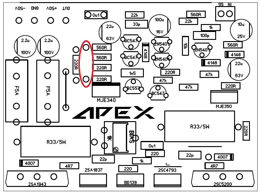

Hi guys. I was going over the list of parts required for my build, and came across what i think is a missing part. As I dont have the schematic, I cant see what it is. This is for the APEX AX14 build, shared by Still4given. Circled in red is a missing component, and I would really appreciate it if someone could maybe help out with the missing part.
Image shared was this one

Sorry, those are just missing circles on the silk screen. If you look at the foil you will see that. I will fix that and repost it.
