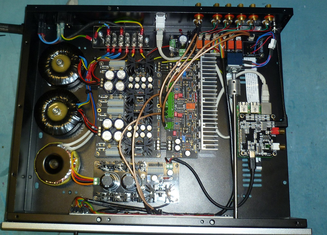

Almost there! Need to tidy up some cables with ties, L/R leads from the Rpi to the iSelect and a once over to make sure I've not made any mistakes .... 😱
I have a question though - I was checking I didn't have a short between left/right/ground on the inputs and when I checked with a meter I have :
Between L and R (measured on the DCG3 L/R in terminals) varies from 1.7 ohm to 35k ohm as I turn the pot from min to max.
Between L or R to ground varies from 2.3 ohm to 17.5k ohm
If I disconnect the pot, on the DCG3 terminals I have:
L or R to ground 333k ohm
L to R 670k ohm
Measuring the pot disconnected it appears fine.
Is this some wacky reading caused by the iSelect board?

A pot (wired as volume control) when at minimum shorts the signal to ground to mute it. Gradually develops resistance across hot and ground in a logarithmic fashion as we turn it up for the input signal to grow stronger across it. Consequently across the preamp's input too. The preamp's fixed input resistance lays in parallel to the pot's at any position.
