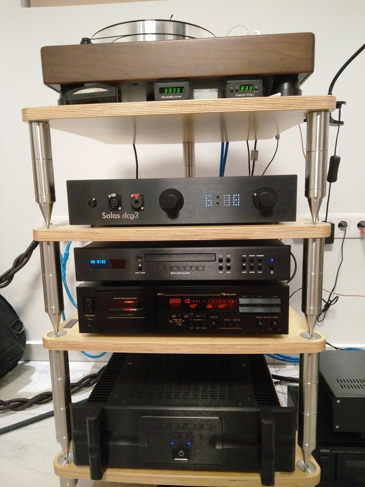

By the way here's a better close up picture of the balanced one at my friend's. On rack now. I went there to listen bit more after his return and given the opportunity we adjusted the ZYX cart's VTA a little better too.

I would expect this one to come across somewhat better because it has direct interface compatibility advantage to his XLR sources and his XLR input power amp over a tentative similar build quality SE version.
It also has a theoretical advantage, although it uses as much PSU as a typical SE DCG3 build due to lack of room in a single chassis, it sees that PSU as common mode respectively to the opposing signal phases. So it should be even more indifferent to its power supply.
Beautiful all in one PreAmp & Streamer build. Congratulations!
How do you like it as now finalized and working in the system?
After extended listening I'd say, for the cost of the build, it's superb. The highlight for me is the soundstage. Instruments are accurately placed and with good definition in the space.
