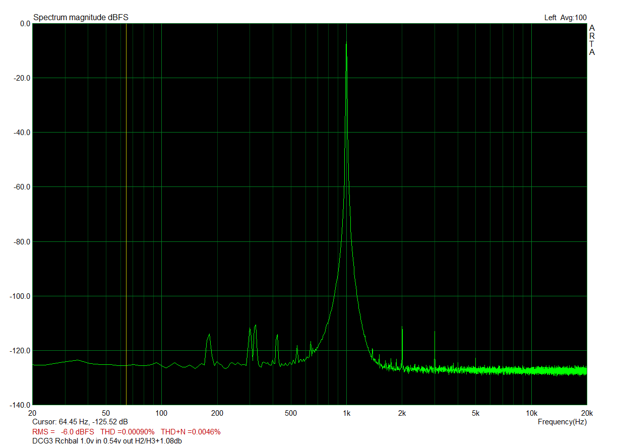

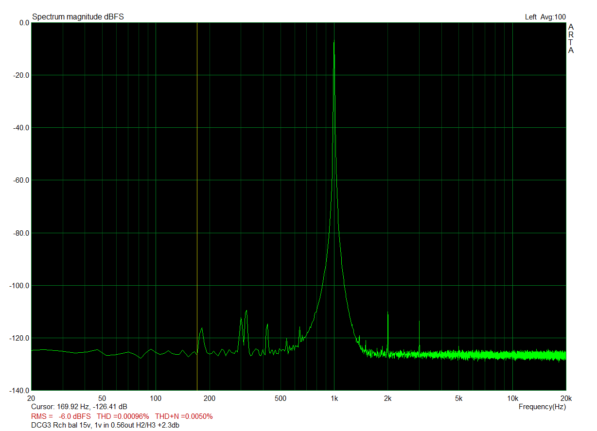

First I changed DCSTB output to 18.5v and gave it a listen. A bit harsher than before; Focusrite showed that H2/ H3 was now about 1db lower than at 17v. Then I made it 15v and listened. Very nice. Notes were fuller than before(compared to 17v)with no apparent lessening of detail. Focusrite showed H2/H3 over 1db higher than the 17v version. 1db does not seem much but subjectively does what the doctor ordered. I dont feel any need to have more H2. The left chart is at 17v, the right at 15V both fed 1v balanced 1khz sine and balanced output of 0.56v.

At 15V the sound becomes somewhat rounder, I have also heard that during the SE normal build's development. To my ears at 17V there was bit more neutral sound, but what is good and what is better its always a matter of preference and system synergy. BAL should behave bit differently as well.
At +/-18.5V rails a 36V spec U1 got too pushed also. Unless you used something like an OPA2604 which can go +/-24V.
Those are very good FFT plots, such little differences in an already very low amplitude THD profile are difficult to be directly audible in my experience. All FETS become progressively slower when the voltage across them is set lower within their first 25V because their capacitance increases. I would primarily think of that as a cause of subjective change. Easing the amp's rise time a little.
BTW weird there is 180Hz in the grass without a 60Hz fundamental. Those little spikes don't seem harmonically related other than the 320Hz and 640Hz needles. Maybe they show up in your measurement loop due to some non mains related factor. Very minor anyway. They add the same to the THD+N indication in both cases.

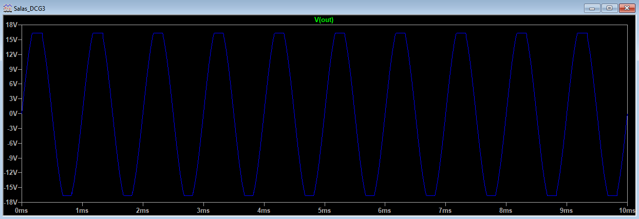

Hi Νικο, do we expect a symmetrical clip fro this circuit?
I'm close to finalize and i want to know for the basic test.
There was 10K load in the sim. But driving its own feedback resistors is 750 Ohm already, then the output is in parallel.
By the way, the usual PC audio interfaces in BAL output jack mode don't output two opposing signal phases i.e. double the signal voltage at 180 degrees but merely impedance balanced same peak to peak voltage output as much as in their SE output connection mode. Their rails and dBFS don't have the headroom for handling double the signal.
So you will not be able to clip test it with a PC interface, a bench generator will be needed.
For heavy loads capable of soaking all the bias current see post #79. As the current ends, the positive portion can swing double than the negative. Because this is not a push pull but an SE output stage with a fixed amount from a CCS FET in the negative. That's center point in the pos but end stop in the neg. So the voltage clip will start only in the negative part until the positive goes finally out of current swing too. This condition is relative when dummy load testing for certain headphones impedance max voltage swing available.
