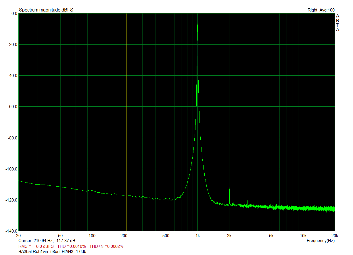

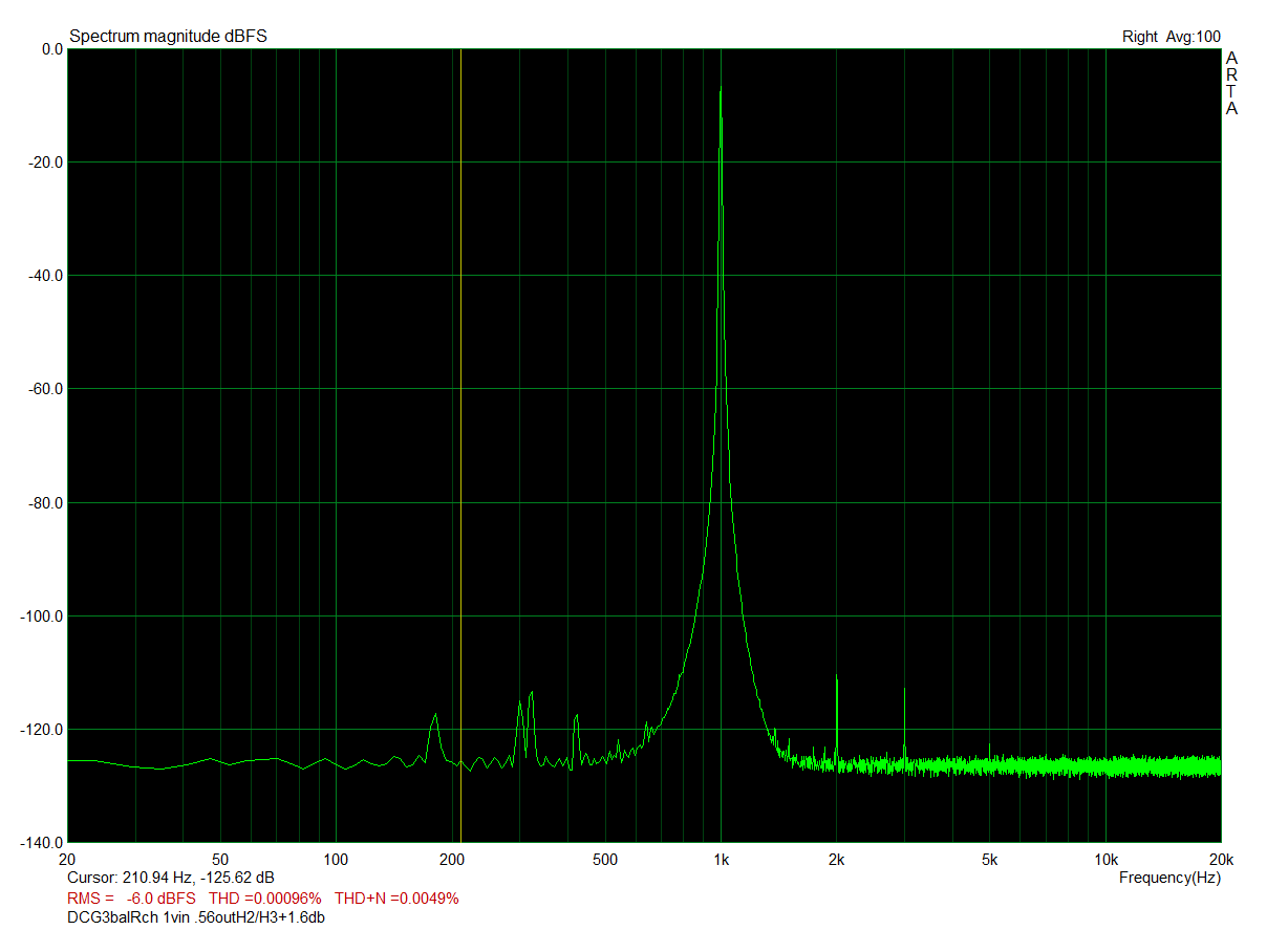

Attached are the comparison plots of the DCG3bal/DCSTB at 15v and the BA3bal/ SSLV1.1 hotrod. I just did plots for both of them. 1V in and 0.56v out for the DCG3 and 0.58v out for the BA3 using the volume attenuator. Could you help me understand why I get a bit different levels of H2/H3 at different times even though THD and THD+N remain almost identical?
The overall sonic signature of both is almost the same. The DCG3 is slightly more dynamic with more clearly defined lower bass; the BA3 has smoother highs. I like them both.

Maybe as the thermals kick in further you get differences of H2/H3 at different times. THD+N is a total so if noise and harmonics sum at a same amount even if with a different profile it remains the same number.
The plot to the right (dcg3) has significantly lower noise floor in the MIDS & LF except those little needles of interference. If they are part of the bench loop they are possibly smothered in the other plot. If not, but build's ground related, maybe you could try to seek and eliminate them. If Tx or other magnetic field related, more difficult.

In your experience why would the plot on the left have the higher noise floor under 1k caused by? Preamp circuit, PSU Tx?
nash
Its input JFET types are low noise so it can't be due to those. The noise level rise is smooth without interference peaks also. I don't know if it could be something in the build or inherent to the design like the impedance of the output coupling capacitor, or possibly less PSRR than DCG3's. I would gravitate to first guess on the 10uF capacitor's impedance. But it takes a real analysis to surely say.
First thing that crossed my mind too but on the other hand those in the BA3 are 2SK170 & 2SJ74 known as low noise.

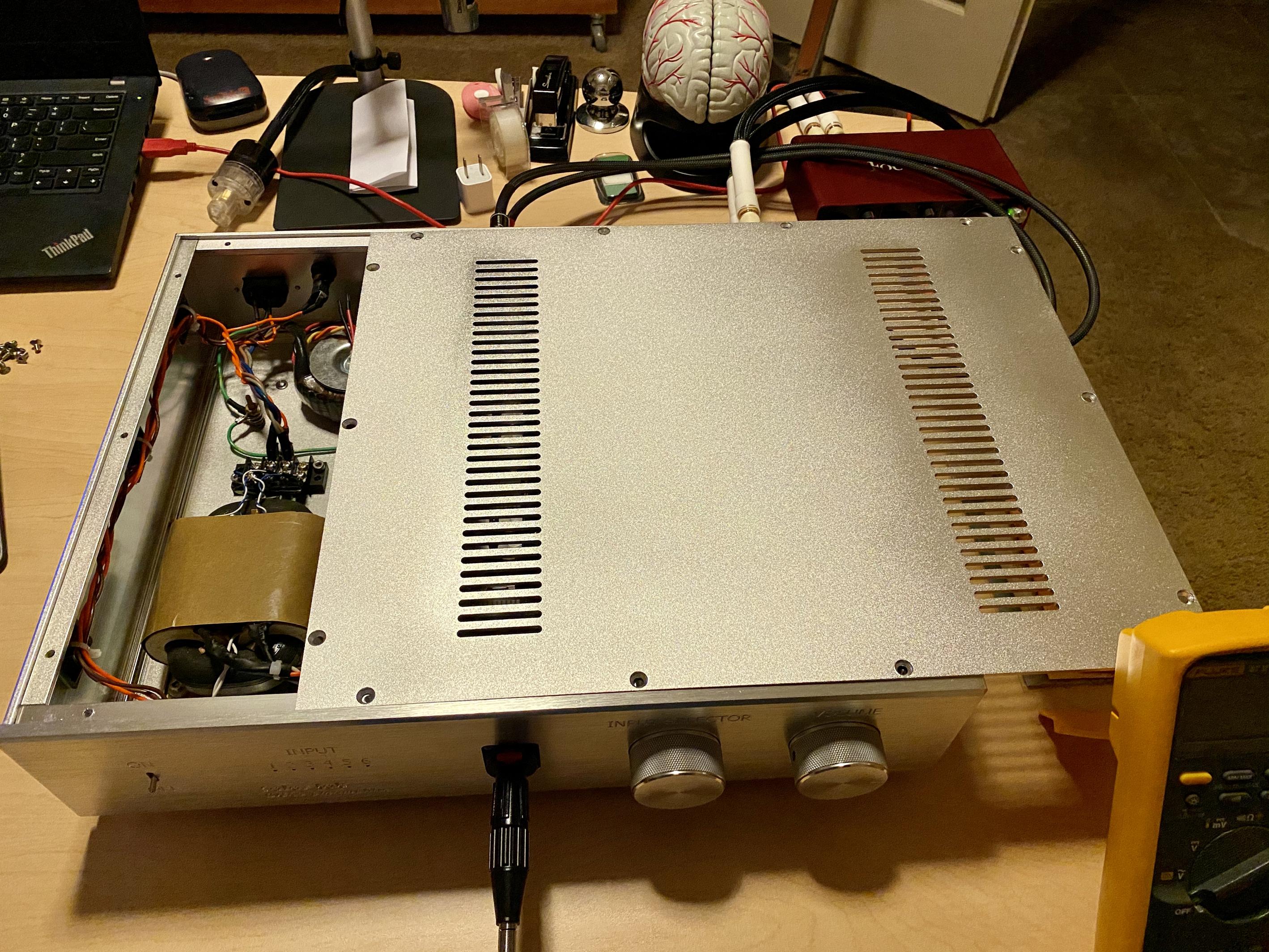

Short question. My FFT is very clean with no top lid. I see some picks getting up about 10-15dB from 200 to 500Hz when lid starts to cover DCSTB, but only on left channel. Is any obvious reason witch causing that effect? It is quite impacting my total THD+Noise %.
The Tx fields bouncing off the lid I would think. Impact should be inaudible. Is the lid making continuity with the rest of the chassis?
Yes, eBay purchased aluminum-junk alloy lid does make electrical connection to Earth GND chassis. Strange that it is only left channel is susceptible for that reflection of Tx stray. If it is still below 105 dB in any way, does it make sense to try to use Mu-Metal sheets or some Fe trany covets to attenuate Tx flux? Or it is just unnecessary perfectionism to satisfy placebo?
Is the left channel nearer to the Txs in your build?
Yes it makes some sense to experiment with mu metal sheets for barrier or dressing.
Surely for technical satisfaction and maybe for a wee bit of more clarity? But then you would know.
Can you post the lid off & lid on now FFTs?

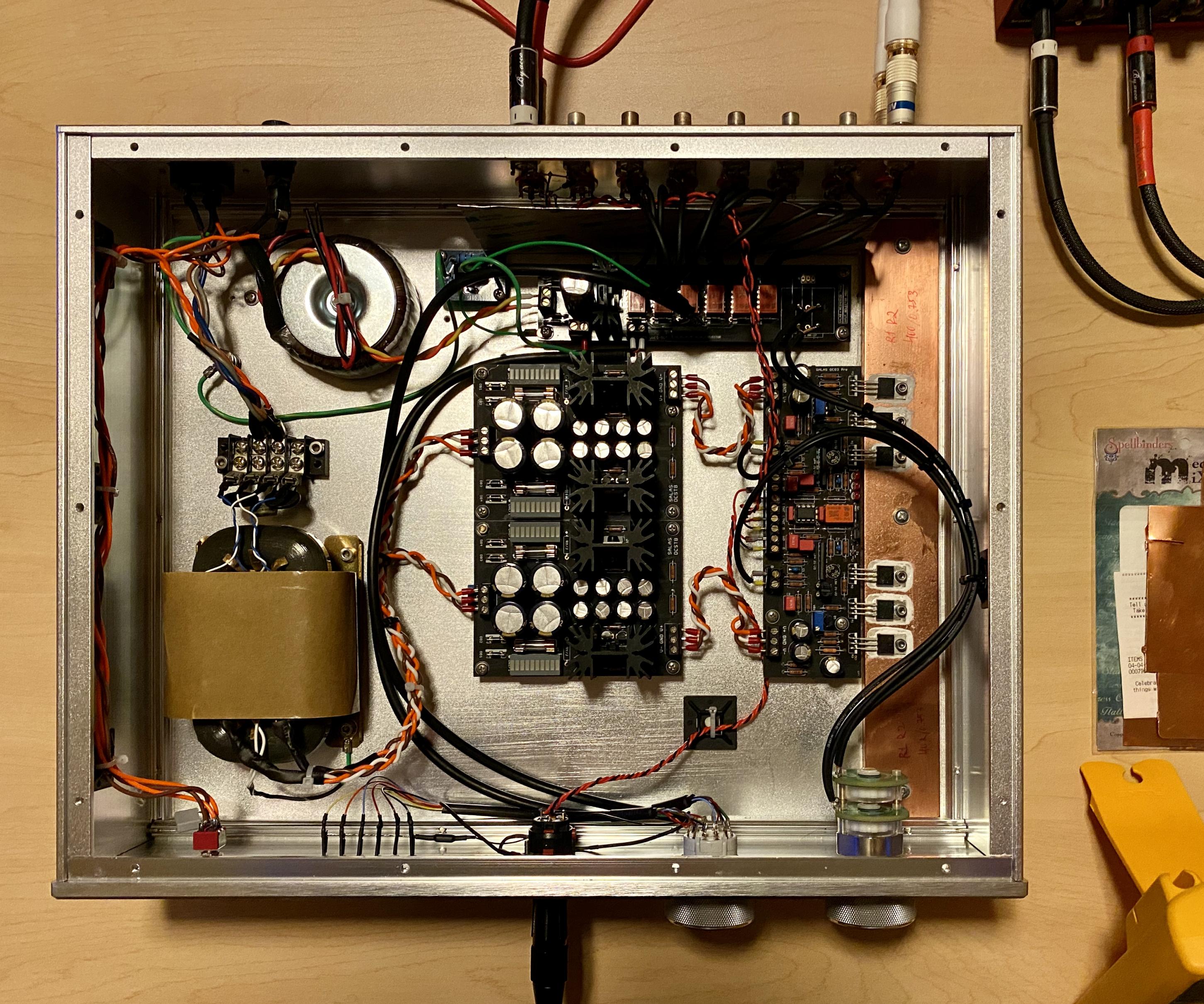

My left channel is located farther from Tx vs. right channel.
Please see test results attached.
I tried to be as detailed as possible there.
I took out my small Tx (witch dedicated to iSelect) for troubleshooting purposes and did not see any impact with or without it. So, it is not one that involved. I also used smaller aluminum cover to simulate partial lid and the effect starts to be obvious when I cover DCSTB from the top. Left or right enclosure sides coverage with that small lid are not effected left channel noise.

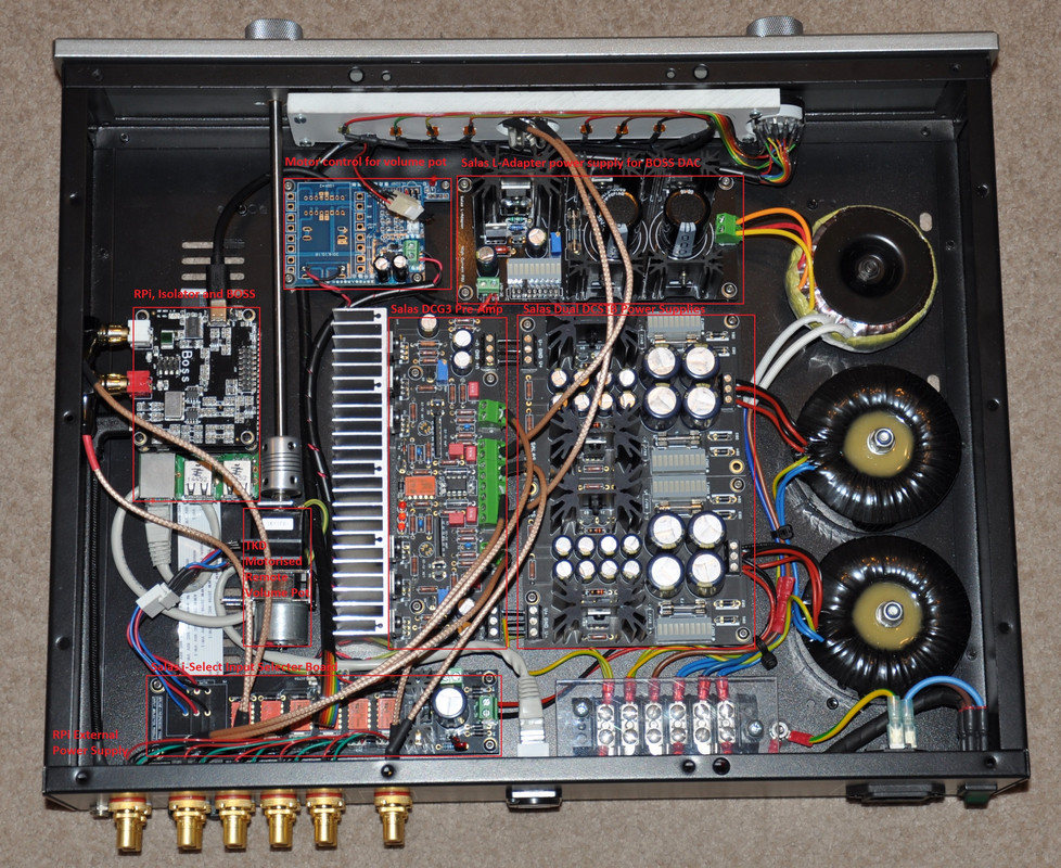

Here are my unit images. BTW, I forgot to mention that RMAA test results are very very good still and I see almost same values as audio card loop test.

See about the cabling first. Especially the line out route take it close to the chassis floor firstly. Its closest to the lid now. Try shielded cable for the line and headphone output routes too if no better with moving as they snake around a rather long way.
To control what interference the lid sends to the left channel, experiments with Mu Metal sheets could help. Maybe a cover for the preamp board itself, or a barrier around it, or lining of the lid, or the selector & connectors are the pick ups to protect, you will see.
