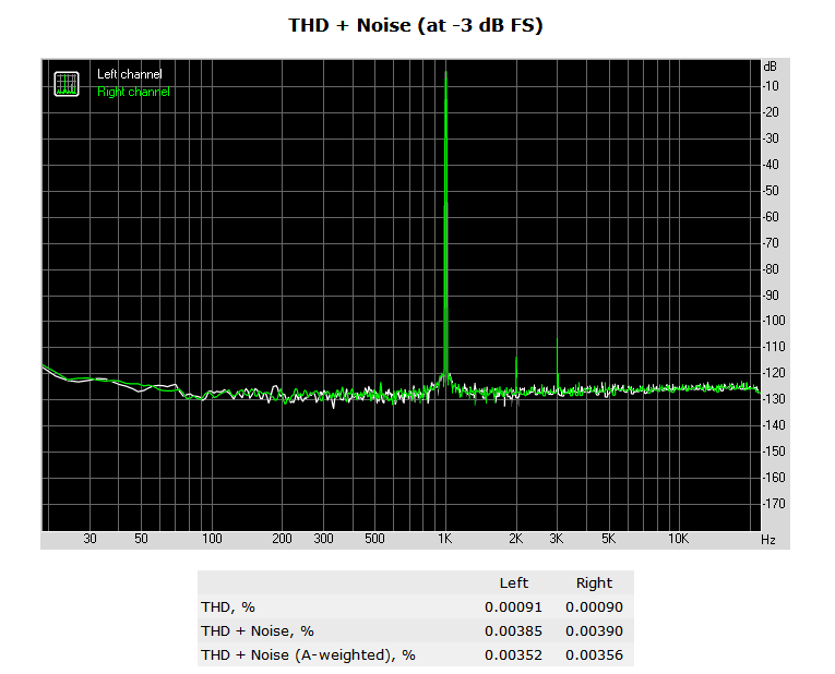

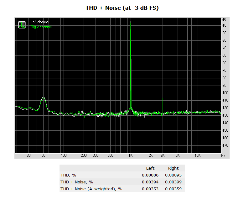

Like Salas has pointed out, I am puzzled by the H2/H3 profile differences of the L from the R channels, especially since the THD and THD+N numbers are identical.
Were the measurements taken when hot? Perhaps I missed this but at what input and output voltages were the plots done.
Thanks. nash
The unit warmed up prior test and I did not measure Vin/Vout to compare R/L. The only think that I used is a reference method (means that same condition is used for "before" and "after"). Do not forget, and Salas mentioned that, that recording was done with consumer grade gear and I did hit its absolute limit. That 3H difference can be related to my noise PC, Focusrite 2i2 itself or my cables/connectors/adapters and etc.. As Salas mentioned, next time I’ll use same channel setup gear to measure L and R on Arta. I have my second unit to tune now and I use this experience to bring it up to my expectations. It is total mess there now started with GND loop.

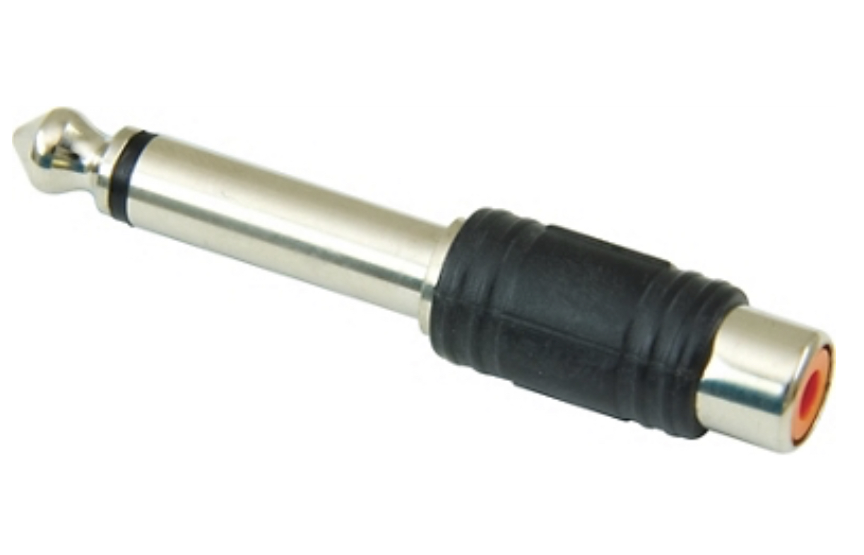

Those adapters sometimes pick hum also when the RCA doesn't grab them well.

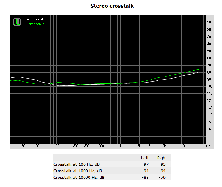

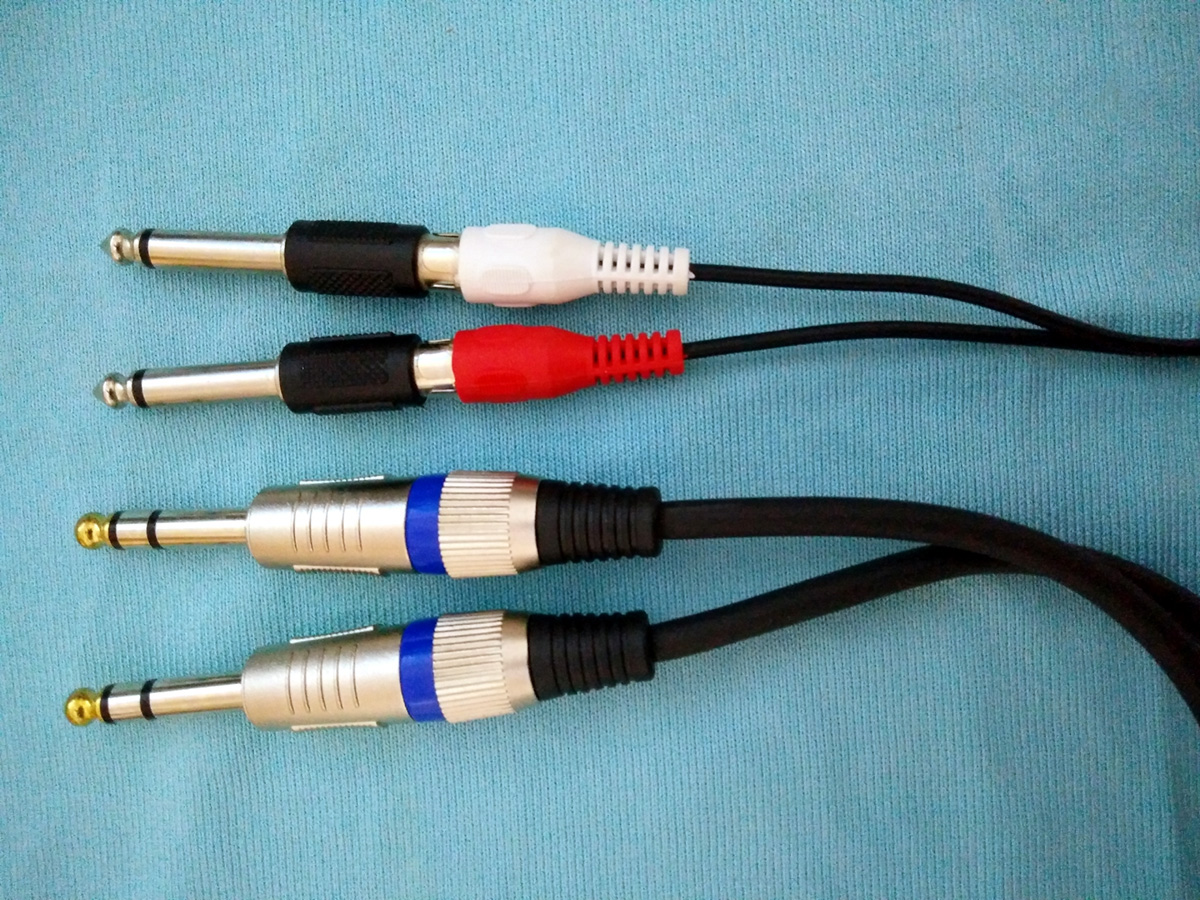

All this is for the trash!I replicated issue with 3 harmonic. It is bad connection via 1/4 to RCA adapter to audio interface. My 2nd generation Scarlett 2I2 in general has flimsy input and output connectors and might it make sense to change these for something more robust. View attachment 794182

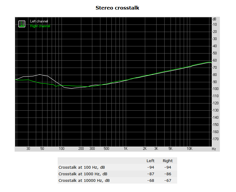

What is the sample rate?See loopback differences of my little old EMU tracker box with bad RCA contact double cable and good separate cables.
Is it the headphone or the line out?
44.1kHz ASIO Windows 10. Its own drivers with bit less THD & noise are obsolete, good for Windows XP only. Its the EMU's line I/O looped to itself.
Thanks, so it's a soundcard loop test not DCG3 measurements.
