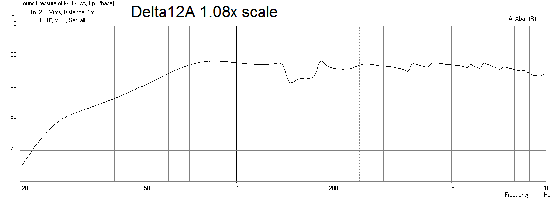

Ok, I will run it...
It's appreciated that you and Freddi try to put it into the proper Akabak format. Please use this format for Akabak TS params. It needs Sd, no spaces around equals sign, and units needed for Fs, MMs, Re, Bl, Vas, Le. Good to have xmax, max power, Qts in comments as indicated after the | .
For example, this is what I converted it to before it can be processed without error message:
Def_Driver 'Delta12a' | Eminence Delta 12A Qts 0.43, 2.4mm xmax, 400w 98.3dB
Sd=519.5cm2
fs=49Hz
Mms=33g
Qms=6.53
Qes=0.88
Re=6.3ohm
BL=8.5Tm
Le=0.79mH
Vas=121.5L
Founder of XSA-Labs
Joined 2012
The Delta 12A gives very good pro-audio style response with 98dB sensitivity and a flat response not needing BSC or EQ. It has -3dB of 60Hz which is not bad and the bass has a very shallow decay tail to give an impressive "pro sound". It doesn't have deep deep bass, but for most music this can sound very nice. The 98dB sensitivity is quite astounding actually. But I fear you may not like it as it doesn't have that deep 40Hz punch. On the other hand, drums will sound excellent as the shallow rolloff means very low group delay. So the timing will be superb.
Here is 1.08x scale (13/12 scale):
I messed up again. I gave the data for the Eminence Alpha 12a but I entered it while being in the middle of a food poisoning episode and accidentally called it the Delta 12a. This sim is the Alpha 12a! Sorry.

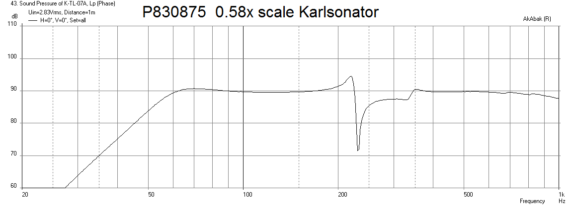

@xrk971: Here is a new sketch of my "Double Karlsonator Tower".
I just found out I can get Peerless drivers as an alternative to the Eminences. Could you try to sim this with the below Peerless 6.5" driver? I put some size suggestions in the drawing but you can change them around to get a better sim. I have high hopes for the bass performance for this combination.
Def_Driver 'P830875' | Peerless P830875 Qts 0.36, 5.3mm xmax, 100w 89.5dB
Sd=143.1cm2
fs=46Hz
Mms=15.9g
Qms=3.2
Qes=0.41
Re=7.18ohm
BL=8.95Tm
Le=0.79mH
Vas=21.78L
Founder of XSA-Labs
Joined 2012
The P830875 is a very nice driver for a 0.58x scale Karlsonator. You get -3dB of 55Hz which is very good as that will capture most kick drums. The 90dB response after baffle step loss is excellent. If you were to stack them as drawn on your picture, and wire them in parallel for nominal 4ohms load, the response will be +6dB for same voltage. A 96dB at 2.83v speaker is awesome and not kidding around.

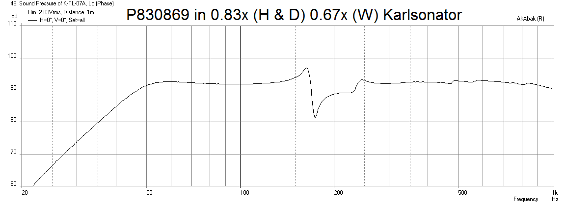

It seems I will have to move up to using the double setup with two 8 inch versions of these drivers. These have a lot lower fs.
Def_Driver '830869' | Peerless 830869 Qts 0.31, 5.5mm xmax, 150w 90.2dB
Sd=227cm2
fs=30Hz
Mms=23.99g
Qms=4.4
Qes=0.33
Re=5.9ohm
BL=8.92Tm
Le=0.63mH
Vas=87.5L
Founder of XSA-Labs
Joined 2012
You won't get any bass extension enhancement by that placement. You could also put two drivers in the same enclosure with size increased nominally - like the dual PA130 that was made earlier in this thread.
The P830869 looks very good in a 0.83x (Height and Depth) and 0.67x (Width) Karlosnator with 92dB sensitivity and a -3dB point at 45Hz.
