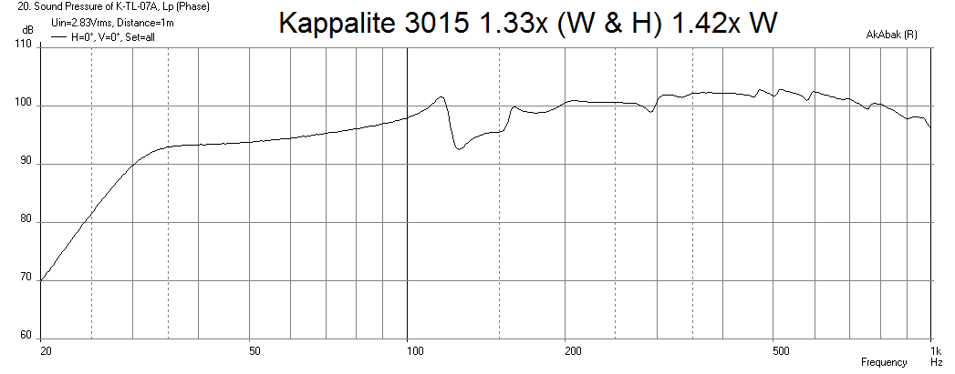

@ ErikNils - - - IF you go with Kappa15A, then you'll have to find someone to help design its lowpass filter to deal with its peak - ask the Multi-Way forum folks for some ideas and sms.
I plan to filter/crossover with miniDSP HD. Also I think the peak might not be so pronounced with the speaker in a cabinet and the cabinet in a room. With the recommended BR enclosure from Eminence the peak completely disappears if we should believe their own graph.
maybe you could private message X and ask for a simulation which gives a good tradeoff of Karlsonator cabinet size vs LF extension
@xrk971
I am looking for good low end but do not want to squeeze out the last couple of Hz on the downside by sacrificing a smooth response overall.
Here are the TS Parameters of the drivers I am considering for my 2 way Karlsonator:
KappaLite 3015

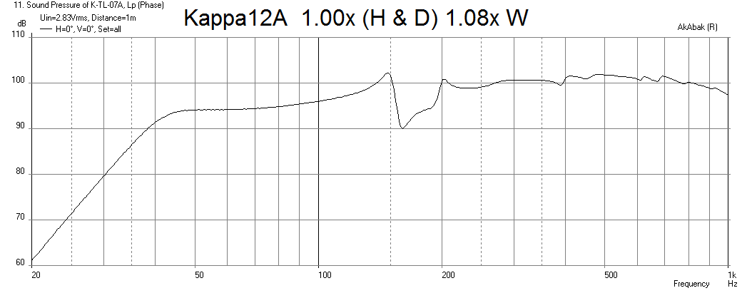

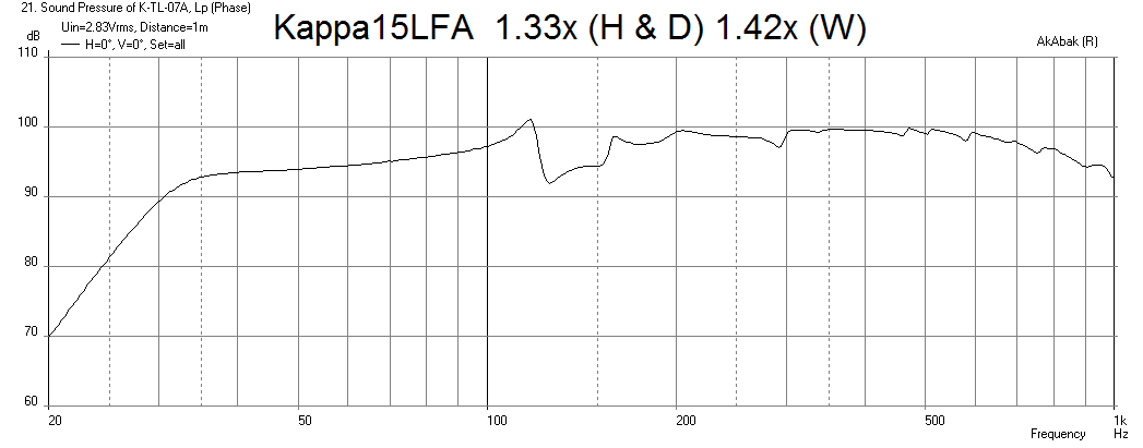

Hi ErikNils:
The Kappa 12A looks pretty nice with simple increase of width scaling by 13/12 or 1.08x in width, with depth and height staying at 1.00x:
Both the 3015 and 15LFA cab work well with a 1.33x (Height and Depth) and 1.42x (Width) scaled cabinet with a cabinet with a 34Hz tuning.
Here is Kappalite 3015:
Here is Kappa 15LFA:
Let me know which one you like and I can run cone excursion and max SPL estimates with a particular high pass filter for you. All these drivers are producing mid 95dB SPL sensitivity (with baffle step losses included with sitting on floor positioning - which is pretty nice sensitivity). The 15in ones are rather large cabinets, but if you have room, that would be some impressive bass.

Thanks for the sims xrk971!
I am a little disappointed by the bass response of the 12 inch. It is on par with the fostex fe206en that I built. I would have expected it to go at least 5Hz lower than the fostex. The 15" sims look very nice but indeed those cabs get pretty big.
To accommodate that size i may need to build them into a counter, effectively giving the speakers an infinitely wide baffle. How would that effect things? Looking at the sims I think I like the KappaLite the most. It has the same motor strength as the Kappa but a lot less moving mass.
