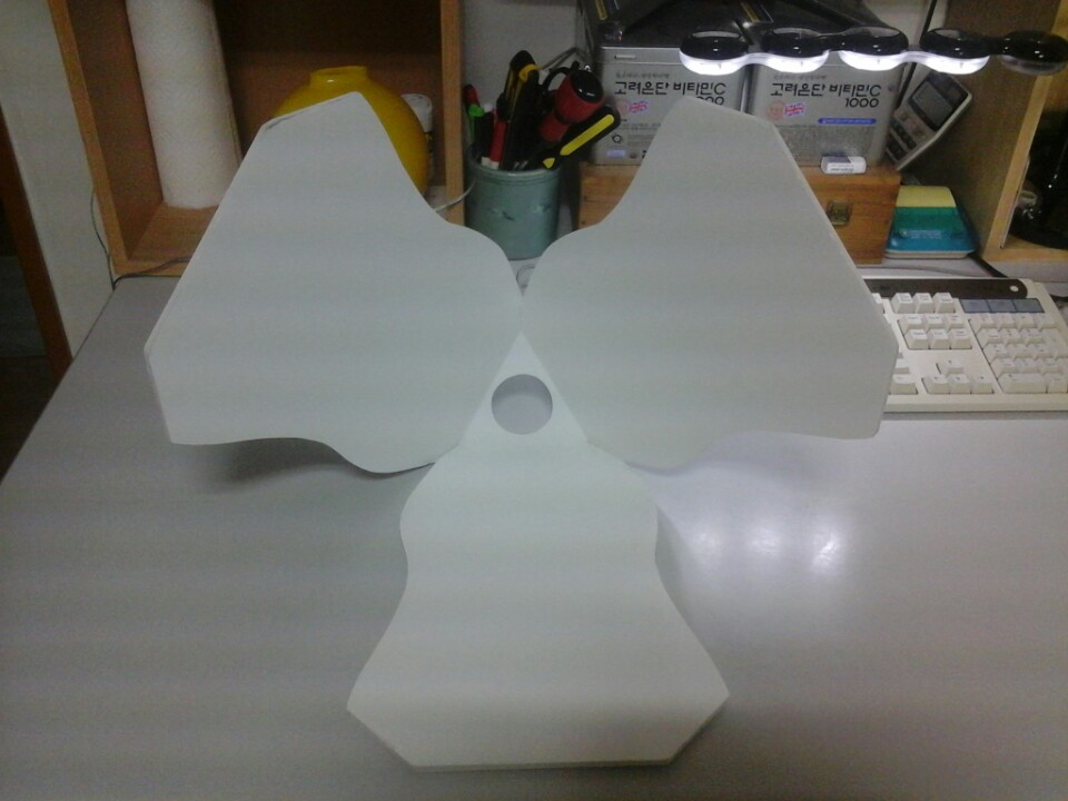

As for adapting the K-slot to a horn or a waveguide, I've made something that maybe of interest to you. I'll post the picture below. It started as a adaptation of a 'Tumbling Dice Horn'(just because it was the simplest horn that I could make with FC:p) and gradually I applied 'The K-Sauce' :D

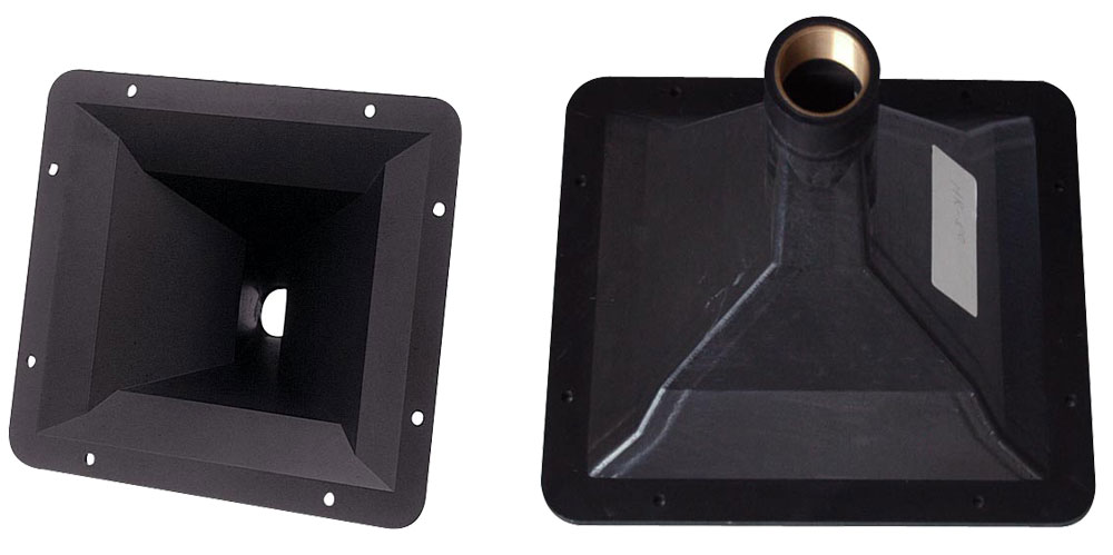

Thanks for the Reply I like your horn could be use on a coaxial speaker but what I wanted just like on a karlson you can remove the wings but I wanted to put the wings cut down to fit on the mounting screw holes in the horn to attach them and see if it makes a difference as for the paraline with a karlson slot I draw it and upload it later ok ok bolexsbm thanks for the pic I like it going to adapt it to a coaxial speaker to see if it works keep up the good work my friend
