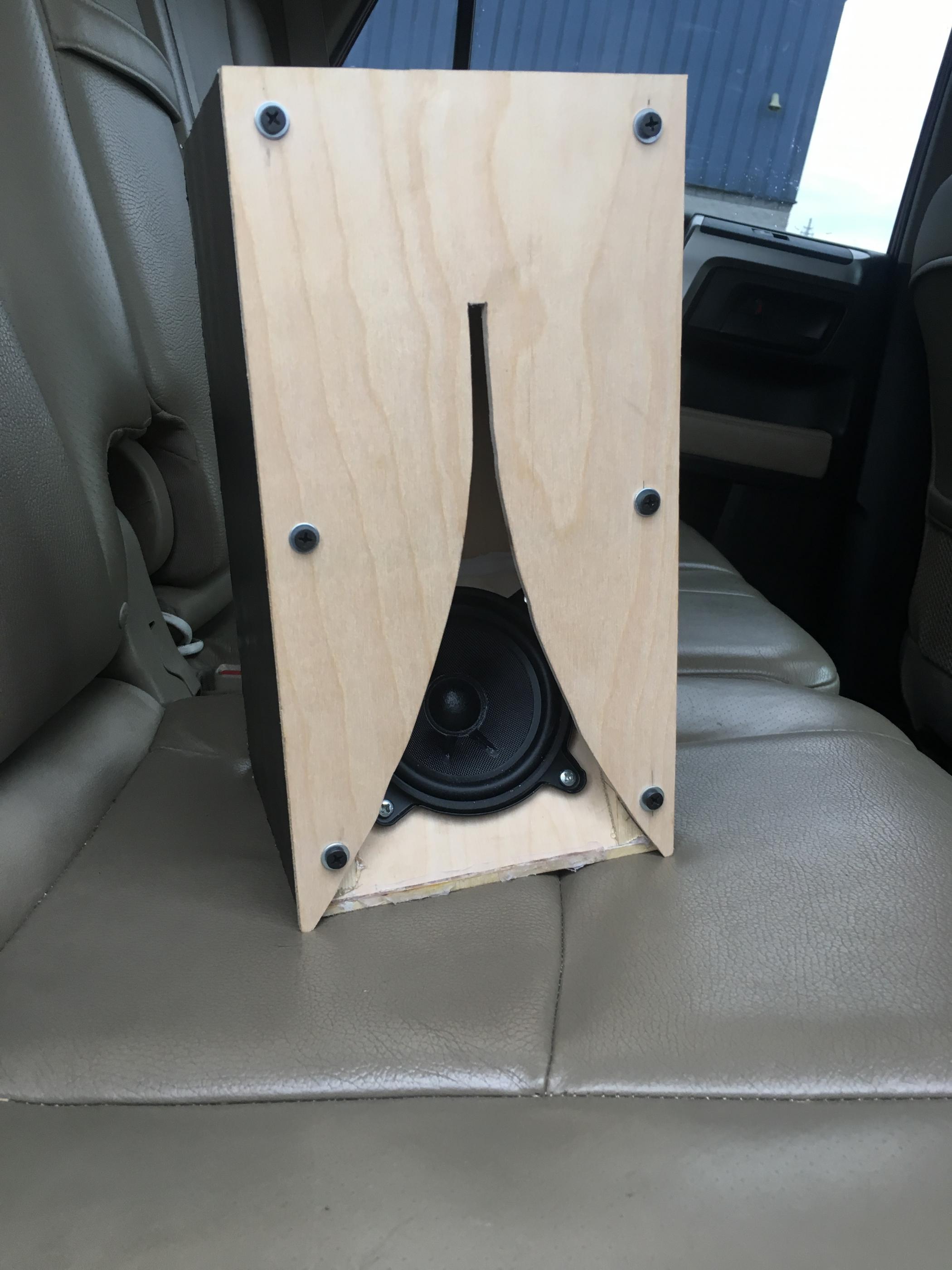

Here's the almost finished first mini K that I'm building for my portable set up. It still needs a few mostly cosmetic touches added to it. I used 4 ohm 4FE35 drivers. I will be adding a 55 hz PLLXO to allow me to play these a little louder outdoors.

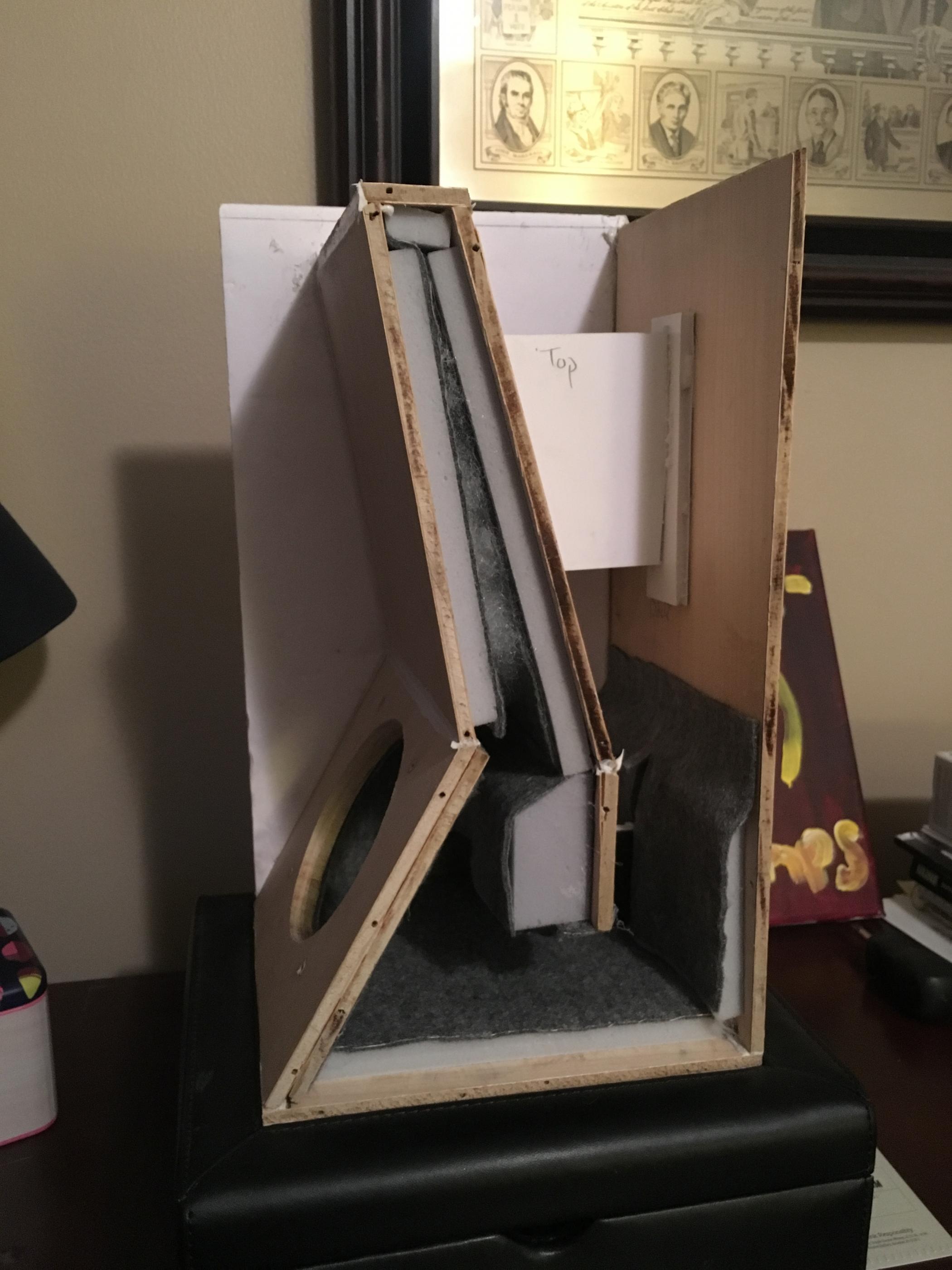

I constructed it a bit different than I've seen others do here. This pair is going to have to survive the rigors of an international flight, so I wanted it to be a bit more sturdy than just foam core. But I didn't want it to be as heavy as a full ply one, since I'm gonna be carrying it around.
I basically am turning the entire speaker into a big sandwich panel, with the core (internal folds of the horn, baffle, top, bottom, back, and K aperture) being made out of 1/4 ply to give some crush strength. The internal bracing is all foam core. The sides are also foam core, but I used sheets of PEEK pressure sensitive adhesive to bond an extra layer of thick card stock to the foam core to give it a little extra strength and to cover up a few blemishes.
The entire outside is going to get coated in black epoxy paint, and the sides and K aperture are going to get at least one ply of twill weave fiberglass laminated to it with epoxy.
For the internal dampening, I used some 3/8" thick grooved melamine foam that has a metalized PEEK backer. I then bonded 1/8" Nomex felt on top of the melamine foam. This layup went on the upper stub, bottom, speaker cavity walls, and rear wall in the line of sight of the driver.
The internal divider directly behind the speaker got a thicker layer of the melamine foam, I believe its about an inch thick.
So far I have only been able to hear this speaker played with a FC cab for the second speaker, and initial impressions are very good.

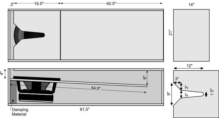

The original Karlson 15 and 12 are very good - K15 outdoors goes ~flat to about 60Hz (indoors probably to 50), K12 ~80 (70). They are very punchy with the right speakers. K15 with a 15" can do some jaw dropping bass passages with very little cone movement. K12 does well but doesn't have the reach - but that makes K12 a nice choice when augmented by a subwoofer which can reach 30Hz or lower with good power. I like K12 better than my Klipschorns but they are much different. The distributed slit vent, under pure sinewave conditions will distort like hell - but under music conditions, seem acceptable. Is most music mainly comprised of transients too brief to go into a steady state condition? (I think sustained electronic organ pedals additional overtones may be heard on narrow slit vent K12's with some drivers -??)
Here's the K15 plan from the January 1954 issue of Radio and Television News
http://classicaudio.ru/forum/uploads/monthly_08_2011/post-329-1385471361,079.png

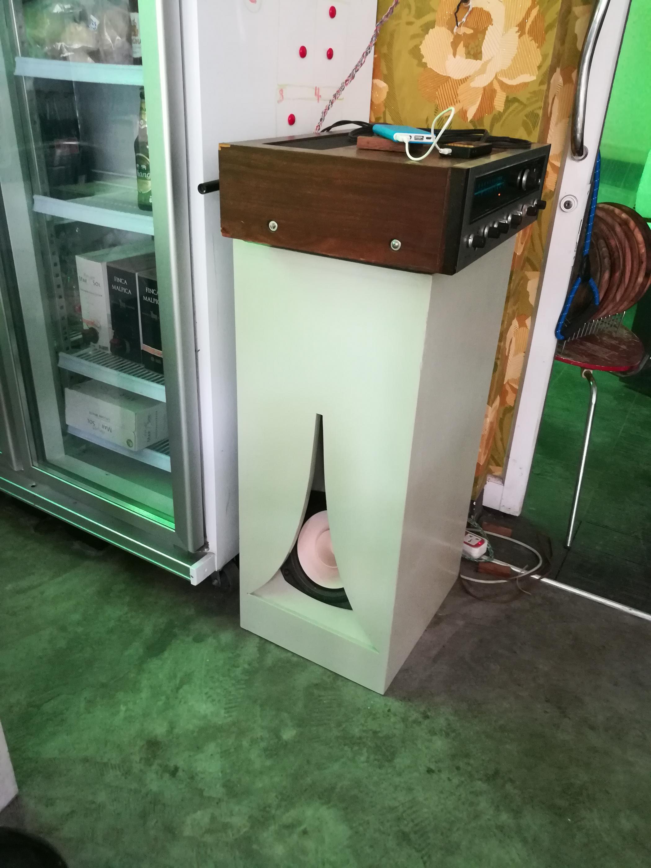

@Freddi, I just saw a post from you from 2005 where you ask:
are there virtues to be had with a Karlsonator 15 vs K15? - would it roughly be a 15/12 Karlsonator 12 - or somewhat different? what field of parameters would be desirable for a Karlsonator 15? would it fix the hole seen in the simple type below?
That is my question as well more than a decade later
I am also interested in that picture you posted. What is it called and has anybody built it. How does it sound compared to a Karlsonator? I like the form factor....

TB46 might have some good ideas for a Karlsonized cabinet with good 1/4 wave path
