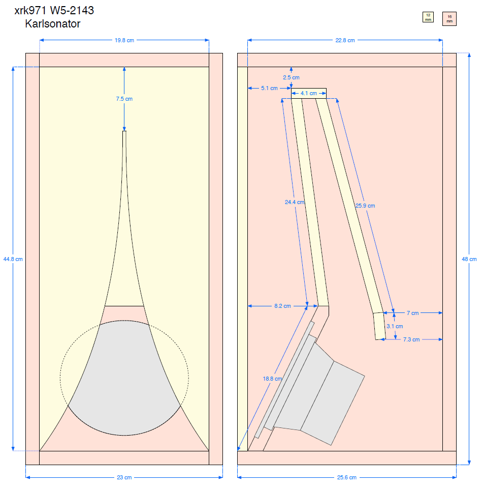

The xrk971 W5-2143 Karlsonator
I have a pair of TB W5-2143 that I like a lot. I currently got them in a pair of bog standard BR enclosures and was thinking about something new for them. I came a cross Srednivashtar's wonderful dual PA130-8 XKi in the XKi - X's ab initio Karlson 6th Order Bandpass thread and got intrigued by Karlson inspired clones like the Karlsonator and xrk971's XKi.
So I mailed back and forth with xrk971 who helped me a lot to sim single and dual TB W5-2143 in an XKi enclosure before I abandoned the idea of a dual arrangement and started to focus on a Karlsonator with a single W5-2143 instead. It took me a while before I realised that xrk971 already posted the sim results for the W5-2143 in the A Speaker that Kicks Butt in Large Spaces thread.
So I started to play with a couple of drawings based on the figures from xrk971. I also got invaluable feedback from xrk971 that I incorporated into the final result. I was planning to build it before I shared the drawing but it might take some time before I get around to actually built is so I am sharing it right away as requested by xrk971.
A couple of notes. I'm from Europe so I converted all measures into cm, I'm sorry if you still hold on to Imperial 😉 The final scaling factors turned out to be; H: 0.5979, W: 0.0370, D: 0.5282 (if you want to check or convert it yourself into inch for example).
Faithfully scaling down the original thickness of the 3/4" panels would result in something like 13/32". Not so practical and it felt a bit too thin to me. I therefore used two different thicknesses of panels in my drawing, 5/8" (16 mm) for most of the enclosure exterior panels and the drivers baffle, and a bit thinner 1/2" (12 mm) for the rest of the interior panels and the aperture (internally to save some volume and just aesthetics for the aperture).
You could of course use 1/2" for all panels, maybe with some critical bracing, the drawing should work anyway, just go with the same internal measures.

EmuMannen,
Thanks for the very nicely done drawing. I think this will be a fantastic combo as the W5-2143 might be perhaps one of the smoothest full range drivers in the 5in range. It's got great upper reach too. The bass enhancement from the Karlsonator cabinet should, eliminate the need for a baffle step compensation so you get a true 89dB speaker.
(I think you may have one zero too many on the width scaling above)
You are right, not only a zero too many but also a missing five. 😉 Correct scaling factors:(I think you may have one zero too many on the width scaling above)
- H: 0.5979
- W: 0.5370
- D: 0.5282
- H: 0.5979
- W: 0.5370
- D: 0.5282
For the Imperialists here, the dimensions work out to be about 17.75 in tall x 9in wide x 10in deep. A nice looking aspect ratio I think. Should prove to be a very good sounding balanced speaker.
