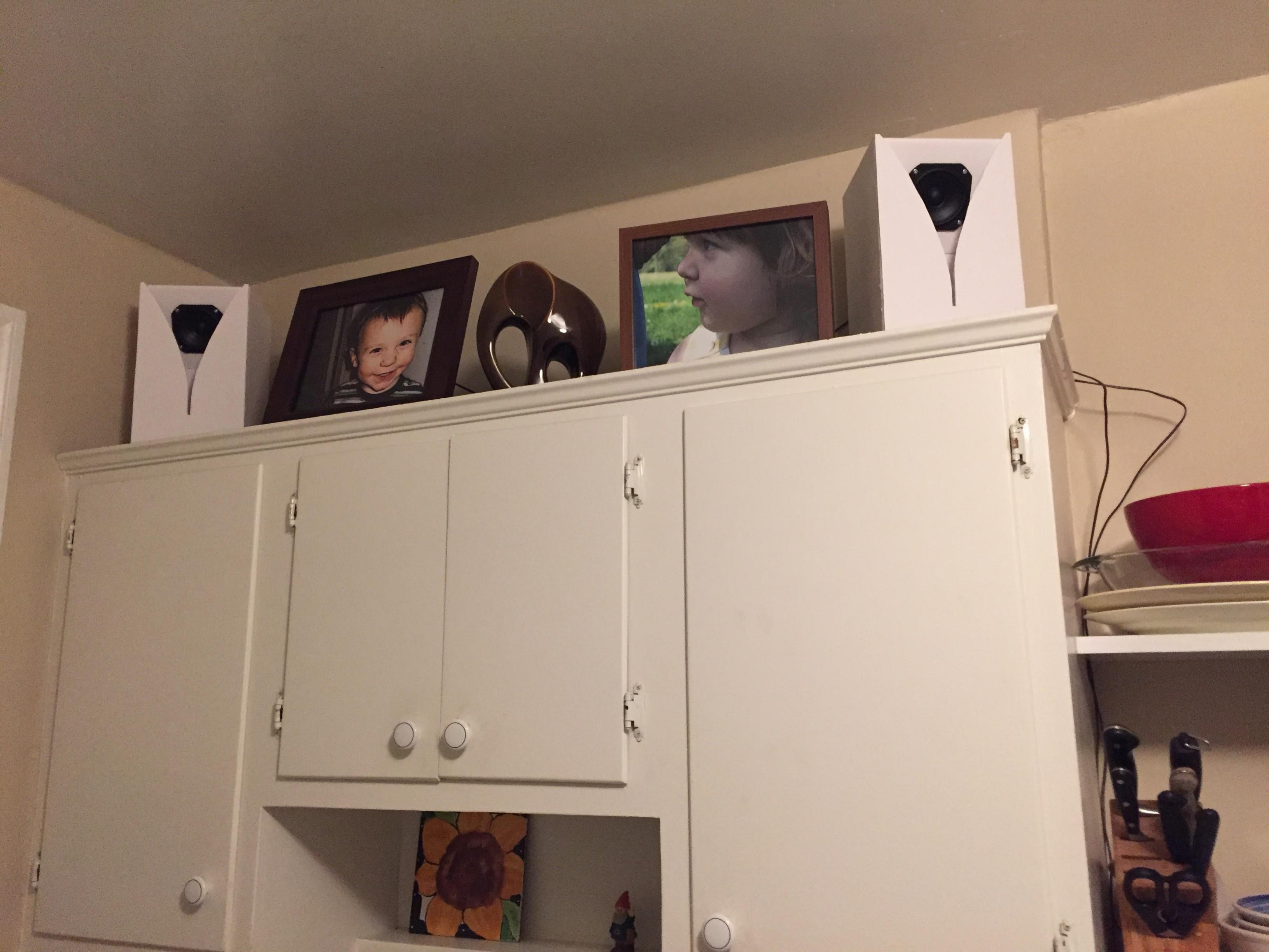

Finally got around to making a couple of little Karlsonators. These are the 0.4x with TC9FD. They sound amazing for their size. The dispersion pattern is perfect for my application, above the cabinets in my kitchen. 🙂
Thanks, XRK!

Glad that it sounds good. It was a fairly easy speaker to make right? Sounds very nice given the low cost and time effort. Nice work on the construction.

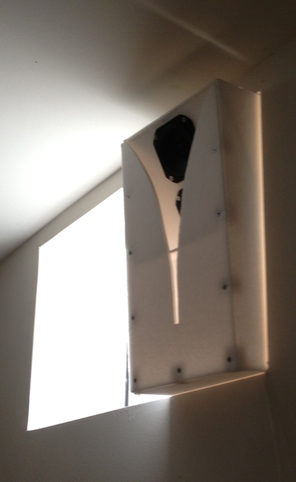

I once mounted the 0.53x with dual TC9's upside down in the basement window well.

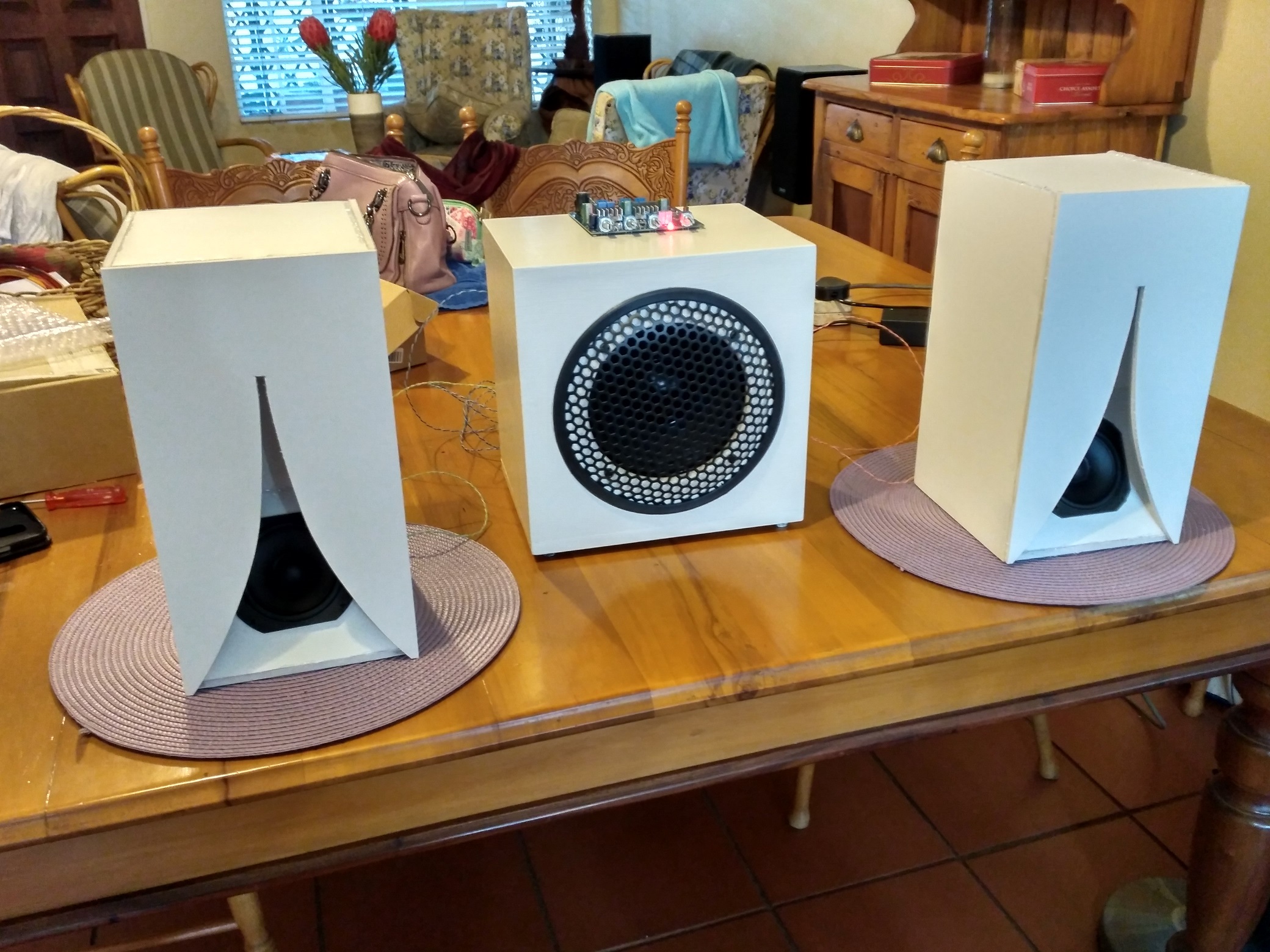

My first post under my new user name. Finished my Karlsonators (0.4x with TC9FD) this weekend. So, this was my first speaker build and my first experience with full rangers. For years I have been reading and drooling over Lowthers. I might never get to Lowthers, but this project was my first baby steps in that direction. I had my doubts. Can a speaker be made with foam core? Can a 3.5 inch driver deliver sound better than my portable radio?
How do they sound? Simply amazing for the size of the enclosures and drivers. Imaging and detail in the midrange and up is really beautiful. They need a bit of help in the bass region, and that is why I planned a complimentary small sealed sub from the beginning. Here they are on the test bed (my dining room table) with the sub, being driven with a $12 Aliexpress TPA3116D2 2.1 amp (being used for the first time too). Such a low budget setup, but it sounds really really good.
I learnt in the process that my construction skills suck. I’ve never been good at woodwork either - I struggle to work accurately. Next time I will have everything laser cut. Soldering is easier and much nicer.
Thank you X and also MuddJester for the detailed 0.4X plans. I just had to convert those imperial numbers to more meaningful numbers.

Very nice work - great build quality. Not sure why you say you aren't neat. They look great to me. What was your old screen name and why did you change?
The TPA3116 is the perfect amp for this and a sub is a great idea. Maybe a 10in sub when you get a chance? Just get a cheap $15 woofer and it can work fine. A large 15in open baffle H frame is neat too. It gives deep bass if you sit nearby but won't bother people in next room.
